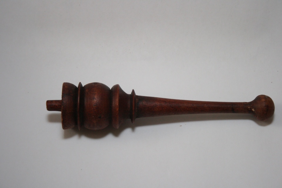

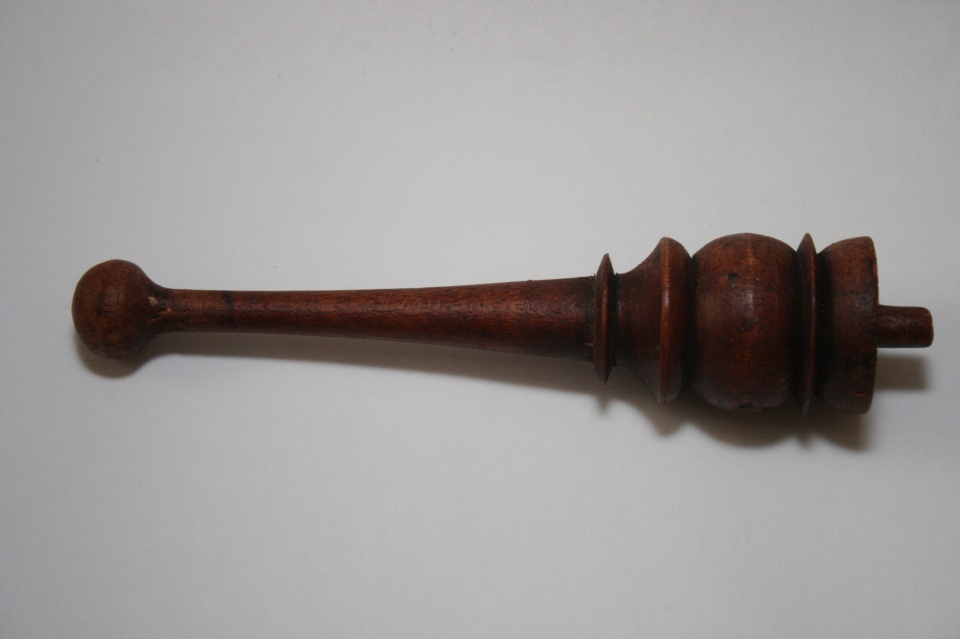

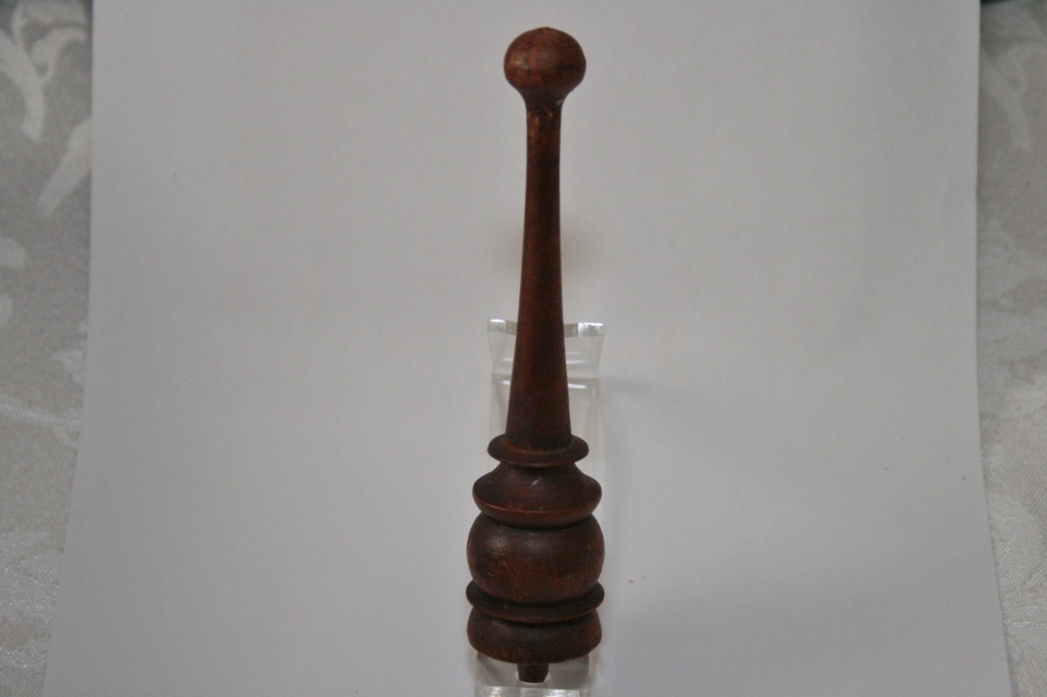

Hello everyone
Our daughter wants me to turn her 6 of the spindles in the pictures. I need some advice as to what I may need to turn them. For turning tools I have me pen genie along with a PSI carbide tipped skew and gouge. I have a 60 deg. live and dead center and the drive center that came with the lathe. I think I can turn the basic shape but that's about it, I'm not sure how to do the ball on the top end or the tenon on the end. Thanks in advance for the help. Oh I guess I need to give some info on how big this little spindle is, well it about 6" long the base is 1 1/4" in dia. and is slightly concave.

I would start with a piece of wood longer than what the finished spindle is going to be. You should have a spur drive (minimum) or a Nova type chuck to have the wood turn without spinning. Turn the spindle where the drive end will end up being the tenon end and the ball will be on the live center. When you have gotten to this point you will have to finish the ball end after you cut the rest of the wood off on the band saw or hand saw. The tenon end gets finished the same way. Do as much of the sanding and finishing that is possible before you cut the material off. I can't comment on the tools you should use as I don't know how experienced you are using the tools that you have.

You will need a spindle gouge. You can do all of this with a skew but you need to be really good with it. Set the piece up behind your lathe so you can see it as you turn. Use a pair of callipers to determine your depths, these can be established with your parting tool. Start with the ball end, this should be towards the tail stock sanding each section as you work to the base this keeps the mass of the wood towards the head stock and lessens the vibe ration. Once at he base you will have left the stock long enough to make the tenon and part off

Here is how I would do it. Assuming you do not have a chuck, mount a piece of wood between the drive center and the live center. The ones that came with your lathe will work. The minmum I would go for blank length is 8". 10" to 12" would be better. Round the piece and then mark off the critical dimensions and features with a pencil. I would put the tenon near the headstock and the ball toward the tail. This puts the most meat at the drive center end. With a parting tool take the detail marks you made down to the correct dimensions, except for the tenon and the long skinny part up to the ball. Leave those heavy for now. You want to finish up your heavy cutting before taking those down. Now use your gouge and skew to turn the features except for the tail end of the ball and tenon. Just rough shape those for now. Sand and finish at this point. Now I would take the tenon down to size and then finish shaping the ball until about an 1/4" or less remains holding it to the tail stock. Part off at the tenon end. Cut off the 1/4" at the ball end and finish by hand.
