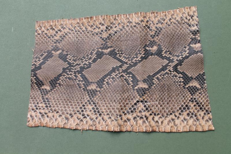

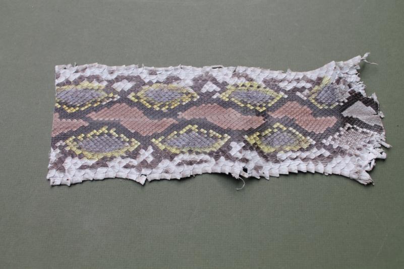

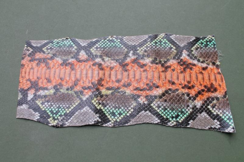

Hi Everyone and thanks for your replys and tips on what could solve the problems that i am about to have:biggrin: i have attached a couple of photos of the types and Quality of snake skins that i will be attempting to cast soon and as you can see they are not your normal skin. These have been coloured and treated and now resemble a piece of leather so the Question I have are
the best type of glue to use nowdays
and how to get air bubble out of something like this ? i am sure they will form once I try to do this/
I have saved and read ALL tutorials i can find through the IAP or any other forum but have been hoping others can give more up to date info so I don't end up wasting the lovely skins.
Kind Regards ian

Be aware that colored skins (the coloring agent) may react with the resin. I have had several dyed skins turn the polyester resin so dark the skin was not even visible. Also some tanning chemicals (and I do not know which ones) can cause the polyester resin to turn dark. For that reason I stopped using skins if I did not process them myself or know how they were processed.
As for as air you just have to do all of the things that have been suggested to help eliminate air. So far I do not know a 100% cure for air and bubbles. What is working for me now may not work on my next sating session. Eliminating air bubbles is a constant battle.
Do a good turn daily!
Don
I agree with what Don has said as well! But I will say that I have attempted to cast the leathery snakeskins and like Don has said, they just don't work out as well when they are like that.
