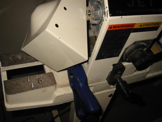

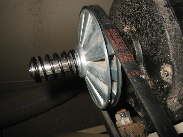

I'm hoping someone can help me out with a problem I'm having with my reeves drive on my Jet JWL-1236. In the past month or so, there've been a few times when I try to move the variable speed up, like after having it at the lowest setting for putting on CA for a finish and then wanting it back up to max speed. Well sometimes, it'll actually slow down as I move up the speed levels, to the point that the higher it moves up, it may even evetually stop altogether.
I've looked at it without the cover on and what seems to be happening when it does this is that thewheel that's towards the back and is supposed to expand and contract isn't doing that and so the drive belt is barely moving.
I've taken a picture of the area where I think the problem is, but of course I took it after I fixed it- but what has fixed it each time has been to push the round coiled spring I guess it is, off to the left some, because it seems like the problem is almost that there's too many coils around the outer ring that's the thicker area below the long skinny part that the coil is mainly on.
I've tried using brake cleaner on it, because I know that had been recommended before, but that doesn't seem to be solving the problem. If anybody can catually understand what I'm describing- my apologies for not being better able to put this into words and describe things clearly- then if you have any ideas, please let me know!

Cleaning with brake cleaner is fine, what are you using for lubrication after it's clean?
You need something like dry-moly. I think your problem is that it's getting crud built up on the shaft and sticking. Those pulleys have also been known to wear at the key and cause problems. If you take it apart (only as a last resort mind you) I suggest polishing the shaft with steel wool till it looks as smooth as a baby's butt. Lube it good and see if that helps. A good cleaning with an air hoose might just keep you from having to disassemble.

I agree with Mudder. Seems like maybe some crud is building up on the shaft. If some of the crud caused it to get a smidgen off center, it could have worn a small ridge in the pully or shaft.

I think folks are on the right track here; but without seeing things first-hand, it can be tricky. First off, the JET manual is no help, whatsoever.....am I not surprised.....though they do recommend only kerosene for cleaning "the protected surfaces." I, too, think you probably have a cleaning/lubrication problem even though your picture shows a fairly clean machine. Like Mudder, I am a great believer in benefits of a healthy dose of compressed air every so often if you have a compressor in your shop. If not, you can get canned air at computer shops.....probably expensive and not as powerful as a real compressor; but better than nothing.
I have heard the comments about not lubing the Reeves drive; but would like to have it directly from JET before I would accept it as gospel. Most machinery with moving parts needs some sort of lubrication......those that don't are uncommon exceptions. Do call or email JET and see what they have to say about lubing the Reeves shaft. You can get phone numbers and email addys at www.jettools.com . My personal experience is that you spend a lot of time on hold with phone calls and have only about a 25% chance of getting someone who can answer your question. I have given up on the phone in favor of the email and they are usually pretty prompt....next day in most cases.....in answering questions.
The dry moly that Mudder is talking about is a material called molybdenum disulfide. It is sort of like the graphite that you use to lubricate locks; but much slipperier. It is a powder that comes in an aerosol can mixed with a quickly evaporating carrier. Sort of like the old deodorants with powder. Spray them on and the carrier evaporates leaving only the powder. Ace would be a good place to look for it....if they don't have it, see if they have graphite.
I also agree that the next step after the clean and lube would be to disassemble the drive(rear) pulley and be sure it moves freely and is free of burrs or unusual wear. This is a job that is a little more involved than what you have tackled so far and you might want to have an experienced person around if you attempt that job.
I would also do a cut & paste of your original post and send it to JET and see what they have to say. You might leave out the part about about being smarter than their engineers and reassembling the thing with parts left to spare!![:D][:D]
Good luck and let us know how you make out.....Oops??.....with the machine that is. Your personal life is your own!![}:)][}:)]

On my Grizzly I use a gun lubricant that has a teflon base. Any gun shop will have it, there are a couple brands on the market. Clean then just squirt the shafts with the lube. I do mine about once a year. BTW, the Jet pulleys look identical to the ones on my Griz.

I don't have a reeves drive but I have had some sucess with the "wet graphite" that tis sold for locks. The liquid is alcohol and will loosen any build up as it lubes.

Thanks for the help everybody. I got some of the graphite stuff at ACE and put it on. So far, it's working OK, but then it wasn't something that happened all the time, so I guess I just have to wait and see if it solved the problem. If it didn't, then I'll be calling you Mannie!

DSA: Don't wait for your reeves drive to start sticking in the future. Dust the shafts with a little of that graphite every so often as a preventative. Try every 6 months for a start and if that doesn't work do it more frequently until you discover the correct interval.
BTW, I emailed JET and asked them for a lubrication recommendation. Don't know why I even bothered. Their prompt response was we don't know, call this number. You can almost be guaranteed of sitting on hold for a long time if you call in!! Guess they never heard of forwarding emails??

I sent JET a second email suggesting that they forward my original question to someone who could answer it and received the response a day later. Doesn't seem like it should be such a struggle; but the informatioin is available if you work for it.
".....I sent this on to Technical Support for you. Here is what they advise:
'He can use a lithium based grease to lubricate the pulleys. That stuff keeps wood dust from building up and still keeps it nice and lubed.'....."
Hope this helpful to some of you. I'm not sure why lithium grease would prevent the build-up of wood dust; but am not willing to hang on the phone for a half hour to find out. From my perspective, since that is what they recommend, that is what I would try. If it did not work to my satisfaction, I would then try to find the dry moly suggested by Mudder. I have used molybdenum lubricants before and they have always worked well. I suspect that dry moly would be a better material to use than graphite; but the graphite should be OK. I would guess it might have to be applied more frequently than the moly; but that is just a guess??
