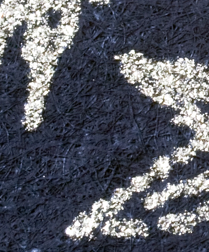

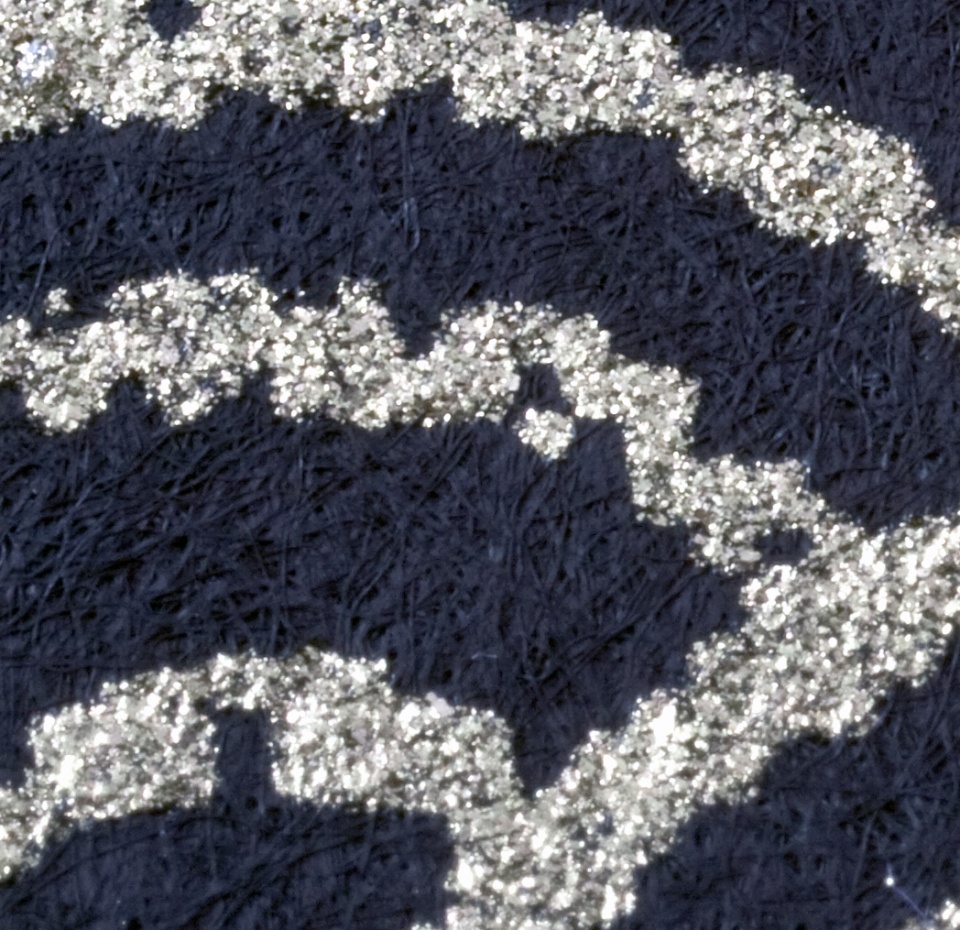

This is what we are dealing with on this paper. As you can see from the layout the wick effect is likely expanded.
