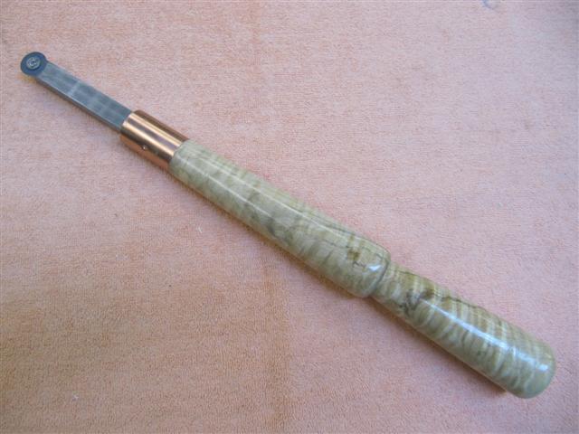

I've used this on 2 handles that I've turned.
Turner's Polish - Lee Valley Tools
attachment.php
So far, it's standing up very well!
