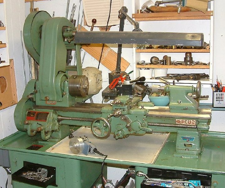

And the Grizzly you posted, while a nice lathe for the price, is just the HF 7X10 on steroids. :biggrin:

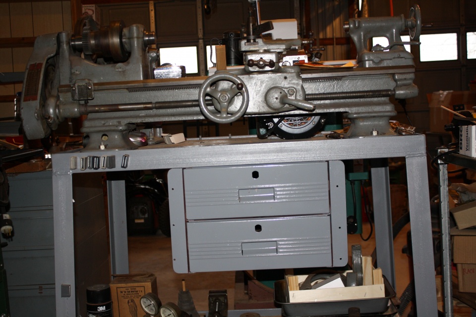

Don't get me wrong, if I didn't have a lathe, the G0602 would be a contender. It is, as I said, a scaled up 7X10 - compare the pics. And I would add that Grizzly is a good company to deal with - I own several pieces of their ww equipment.

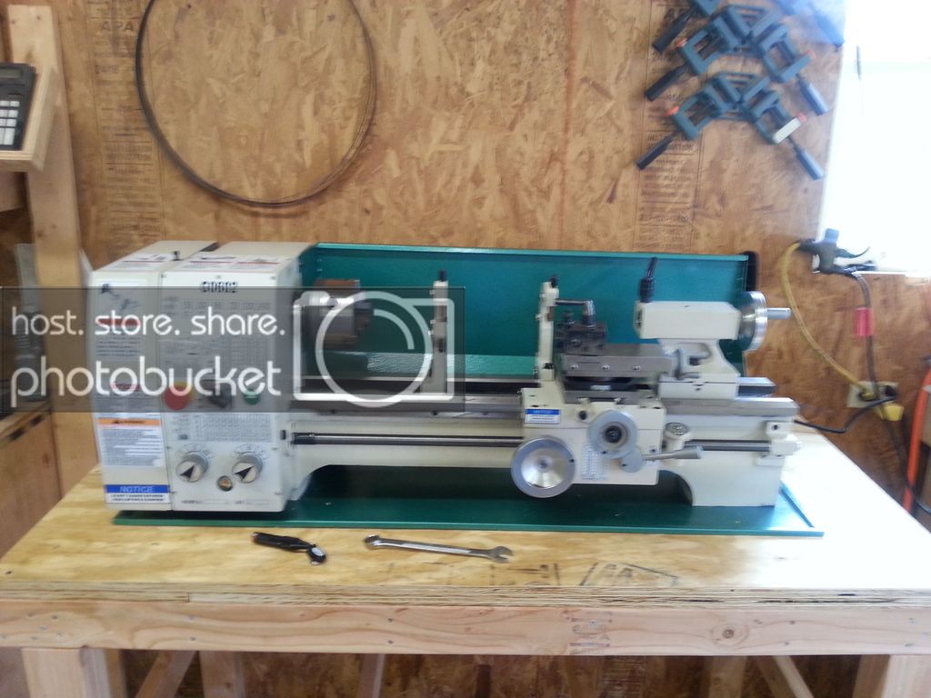

Was going to order the g0602 lathe but after talking to grizzly tech about the spindle bore being 1' would a 1" aluminum bar fit thru it?The tech would not say yes, but felt the spindle being 1' and the bar being 1' it most likely wouldn't work. So I decided to not order the lathe.
But got on you tube and came across a gentleman named JAMES GREENE EAGLE DUSTOFF 37. I sent him a message about the 1' bar fitting thru the spindle bore and his reply was he does it all the time.
So Last Thursday i order the lathe and it arrived Wed.

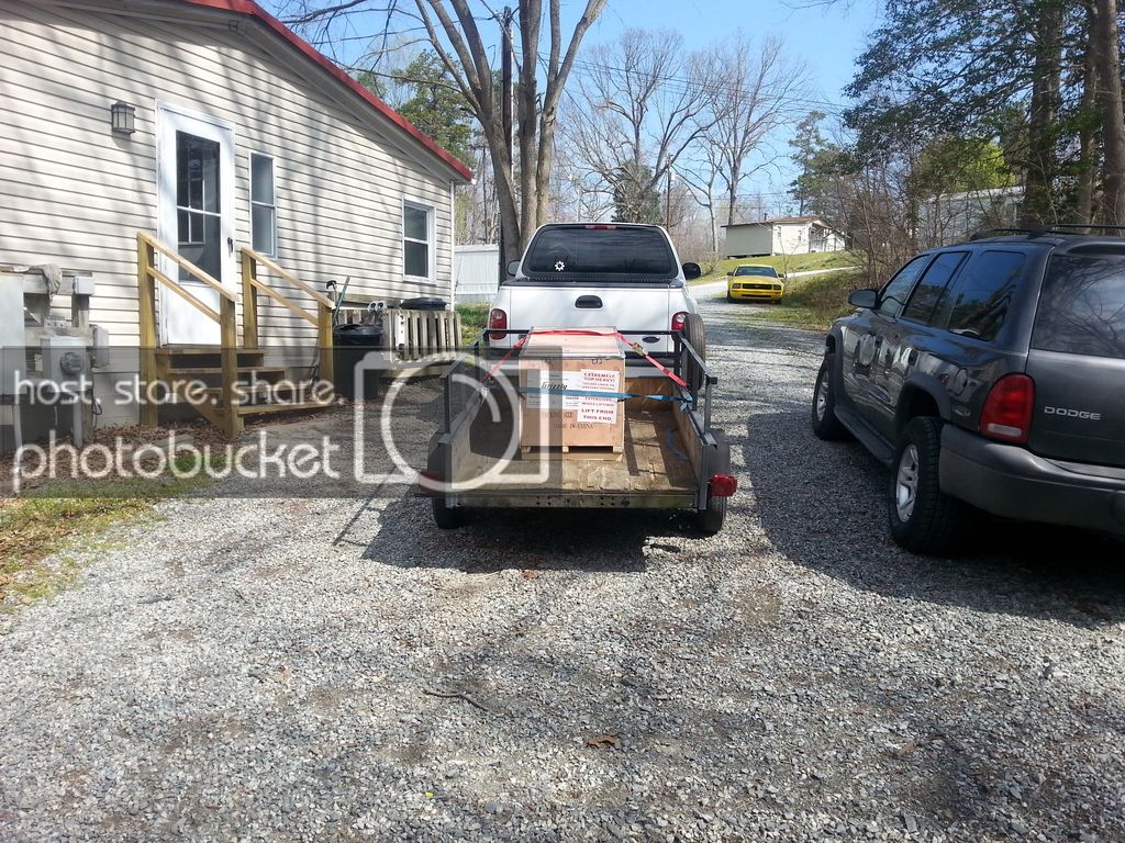

I went and picked it up from the UPS freight yard.
Backing it down the drive to the shop
trailer has a tilt bed, was able to back up to the door tilt the bed and it slid right thru the shop doors.

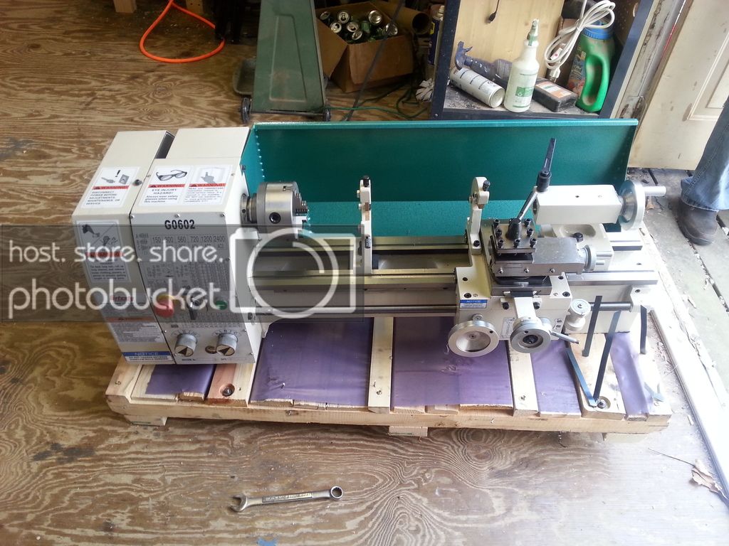

Opening the crate.
Its new home. Notice the HF lathe being evicted on the left side

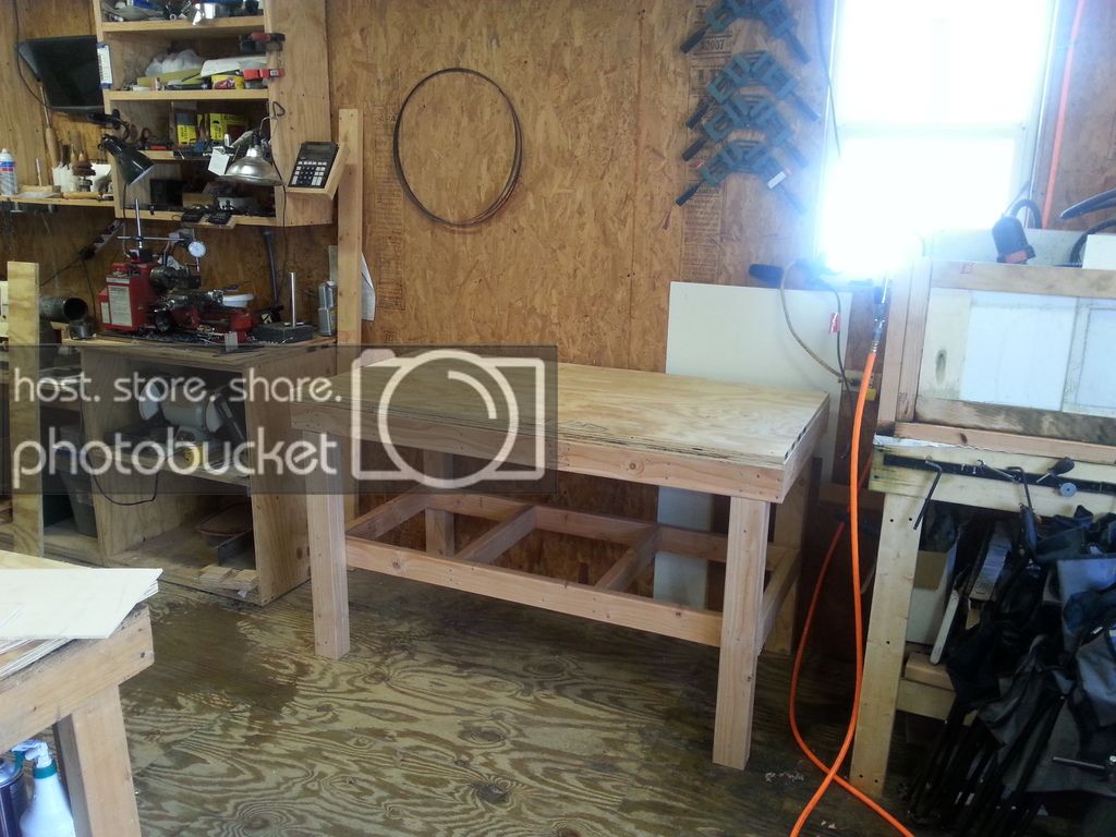

Table is 60 x 30 glued and screwed together.
Sorry no pictures lifting it up, concerned with being safe and not dropping.
We ended up using a engine hoist with a leveler to pick up this Shipping weight was around 430lbs. Crate maybe 30lbs .
sitting on the bench and bolted down.

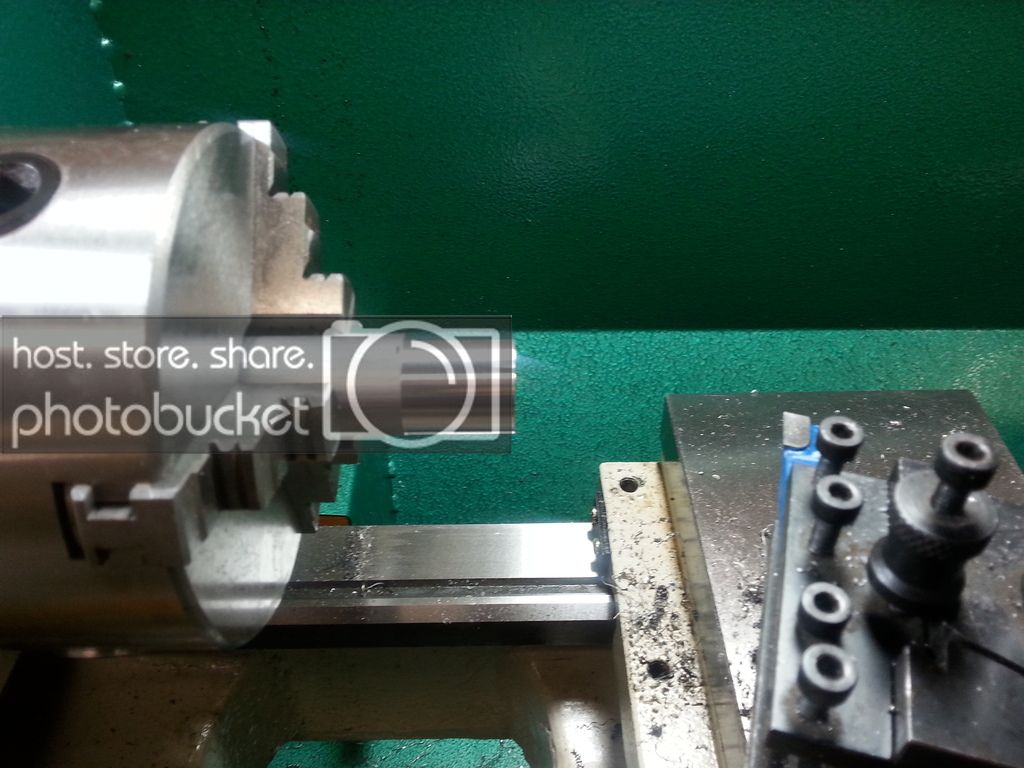

first turning.
Now need to read the book, since there is supposed to be a break in procedure for it.
