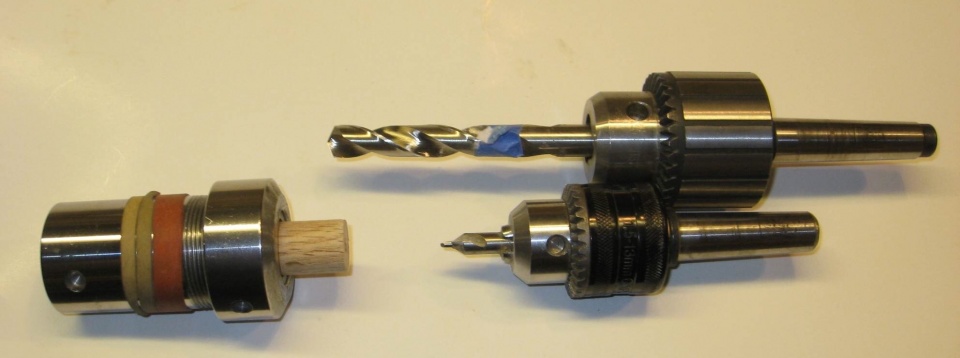

Many, including myself, have found that drilling on the lathe is the way to go. You would need a drill chuck with a morse taper to fit your tailstock and a chuck to hold the blank in the headstock. I use a collet chuck because it's extremely versatile for other pen related functions ... Many use a scroll chuck or special pen blank chuck.
A center drill also helps get the hole started on center. Slow speeds and backing out often to clear chips. Lock the tailstock down and advance the bit with the wheel of the tailstock. Keep your hand on the drill chuck, especially as you retract the bit, just in case it wants to pull out of the morse taper.
