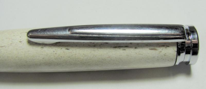

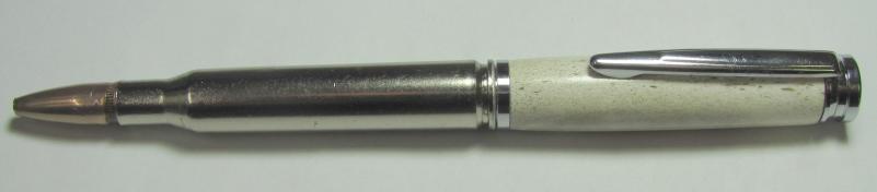

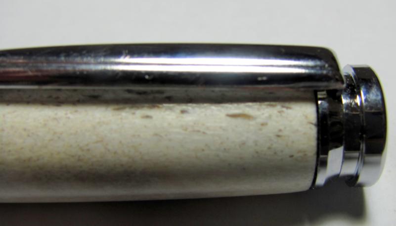

The clip on the pen in the pictures is from a PSI kit: Trimline PKXMCH.
The clip ring fit nicely in the recess. I choose to widen the slot to accept the clip instead of modifying the clip itself. Widening the slot took about very little time...less than 5 minutes. The pen kit used is the Berea kit with the fake shell replaced with a real 280 Rem shell case and a real bullet. I don't like the rifle clips or any other theme clips.

I did try modifying the slot on the one pen. Clip was still loose. I kinda like a more traditional clip myself and so does my customer. I like your tip Don. Might give this one a go. THanks for the tip!:bananen_smilies022:
If the clip ring fit inside its recess and it the clip fit inside the slot and the clip is loose then maybe the two pieces of the finial are not pressed together tight enough. Or, the clip ring was too small for its recess.
