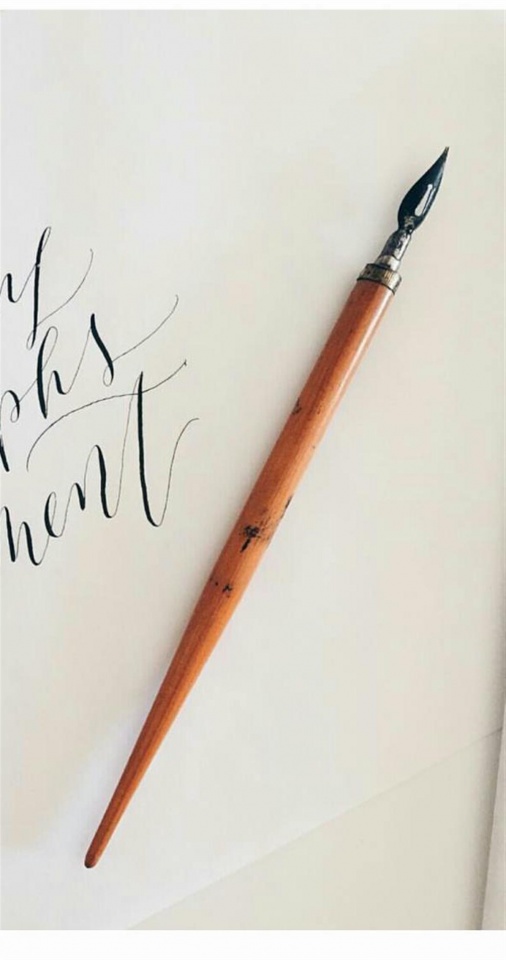

Question guy's I would love some advice from the experts here on making a calligraphy pen like the picture added. it's for a co-worker of my wife. I have no idea on even where to start. especially how to be able to remove the ink refill....Also does anyone know where I can get a very good set of Calligraphy nibs??
any help is greatly appreciated

The photo looks like a dip pen to me - no cartridge used.
Places like Exotic Blanks or Classic Nib have a lot of writing nibs, and a limited calligraphy selection. For a good selection of calligraphy specific nibs, you need to use an art supply. Most of these nibs will also be dip rather than cartridge.
If you don't have a good independent art supply near by, you can always order from a supplier like dickblick.com. Blick has a couple different sets of calligraphy or manuscript nibs.
PSI offers a dip pen kit, which has all the necessary part to make the handle and the insert to hold the nib. the instructions for this kit is also a good place to find out the general steps for making a dip pen. The nib that comes with it is not a calligraphy pen, it is more of a detail pen. To find calligraphy and other nibs, go to an art supply store like Dick Blick.
need help on making the actual nib holder? If so, go to Wooden Pens: Buy Handmade unique custom rattlesnake wood pens gifts fountain pen exotic wood from Red River Pens and look at article # 8 in the list. It is about making dip pen nib holders. And, those inserts Bob in SF pointed you to are really nice and I use them exclusively.
