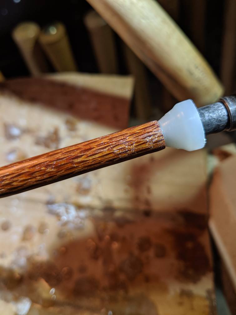

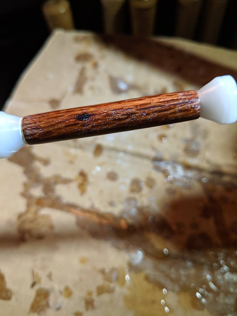

Hi all! I've only made a dozen or so pens so far, and I've done a CA finish for all but my first. I love the gloss and shine so I really want to perfect my technique. I've tried 2 so far using craft foam instead of paper towels in order to eliminate streaks. It works at doing that, but I've had other issues. Today, I sanded to 400 grit and cleaned with DNA. I then applied 8 coats of thin Mercury CA (2 drops into the craft foam, lathe spinning at about 500rpm), then wet sanded to 12000 mm. Once I'd done that, I checked it out, and everything looked great, so I applied OneStep Plastic Polish and buffed with paper towel. Once I did that, I got some white spots that wouldn't buff out.
