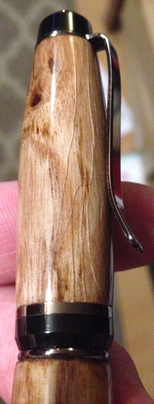

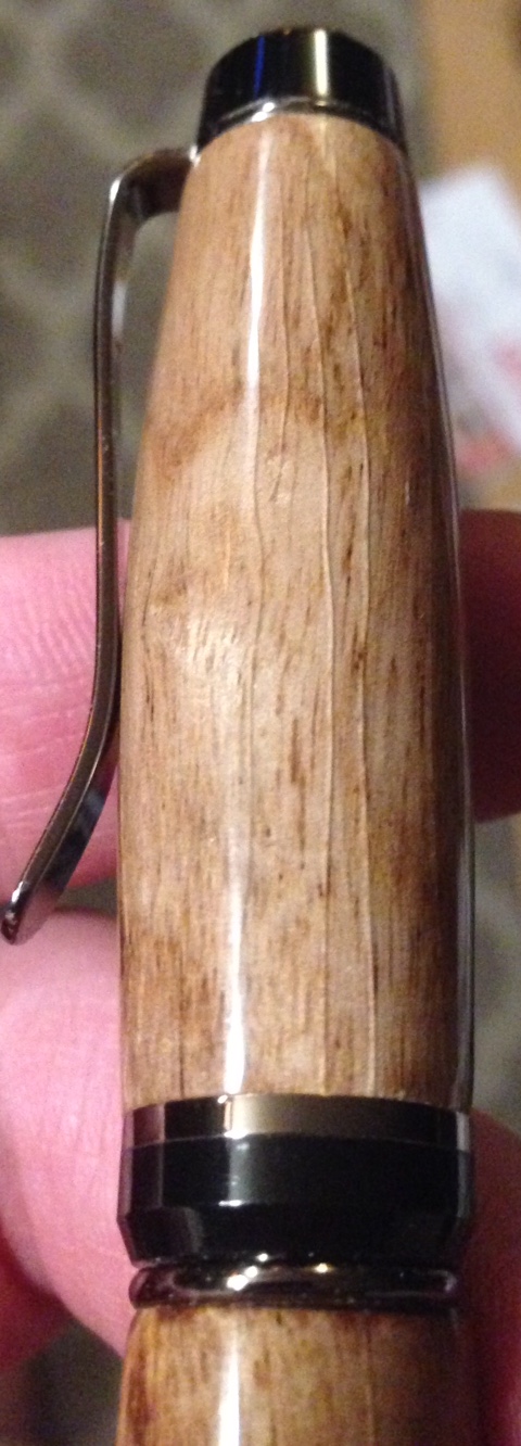

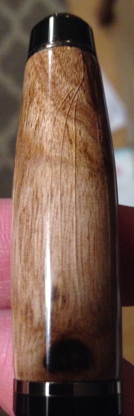

Hey all,
I have run into a bit of an issue.
My process for finishing has not changed in the last 40+ pens I have made.
3 thin coats of medium - Accelerator.
6 thin coats of medium - Accelerator.
Wet sand - 400/600/800
Wet sand Micro mesh - 1500-12K
Polish/Wax
It's only happened on this one pen but I am in the process of getting ready for my first "Show" and am in the process of making 80+ pens for it in the next month or so.
I found that this pen, after I finished it, had "spider cracks" in the CA finish on the cap and a little on the base.
View in Gallery
View in Gallery
View in Gallery
My first thought would be age of the CA (If thats even a thing)
My second thought would be that the CA built up around the edge a little too much and when I put it together the CA had no place to go and cracked.
Any shared knowledge is greatly appreciated.
Thanks
Jay
Tampa, FL

many things could have caused that. You left out alot of your process. You did not say how you do your finishing. Do you use delrin bushings? Did you sand the ends before assembling??? Did you ream the ends of the tubes before assembling??
fittings too tight because too much plating.
wood movement
ca in the ends of tube or burrs
went together on a slight angle and cracked
Had a hairline crack before assembly
Heat caused a crack
CA not dry before next coat (15 of them wow)
That is a few for now. Will let others add to the list and good luck.

I've never seen cracks go the full length of a blank like that.
You mentioned that it might have happened when you pushed the parts into the blank - could be, but normally the cracks are at the ends of the blank.
Before I put the hardware into a blank, I usually ream out and slightly taper the ends with a plumbing reamer/deburring tool. This does help the parts to ease in before pushing them fully in.
Also, was the inside of the tube clean of any glue/epoxy?
Gordon
I had cracks like those at one time, and I attributed them to the accelerator. I changed cans and greatly reduced the amount of accelerator, eliminated it for thin CA eventually, and have had no additional problems. As I changed 2 things at once I cannot say for sure it was the accelerator. I have changed my technique so that if IU do use accelerator it is a mist from 18" or so away and I wait 10 to 20 minutes before adding another coat of CA. I let the CA dry overnight before sanding and polishing for the final shine.
There was another thread about a year ago. Maybe you can search and find the replies.
I, too, have had that issue. And I'm pretty sure mine was due to "old" CA. I did a number of trials and comparisons and the results pointed in that direction. When I pitched the "old" CA the issue resolved.
2nd choice
Looks like a stress crack to me ..< final answer..<<<
normally if its old CA or to much activator the crack will be all the way around and it will crack more and more even while you are holding it .

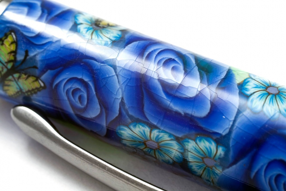

On this topic I have studied and have extensive info on cracking.
attachment.php
The problem is somewhat common and certainly not a new problem and I would also like to point out this article I wrote for Toni's site on the subject.
https://www.claypenblanks.com/what-is-polymer-clay/ca-finishing-101.html
