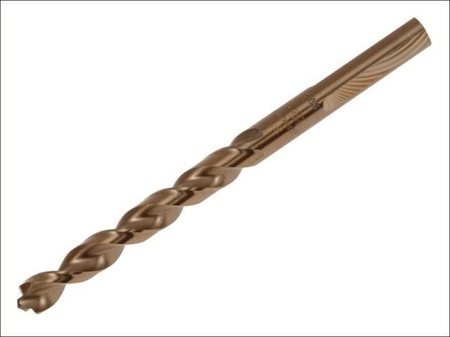

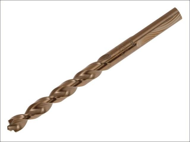

For drilling after correct alignment try DeWalt Extreme 2 drills they do not wander.
Use a straight rod in the drill chuck then square the table of the drill press first.
Have success Peter.
