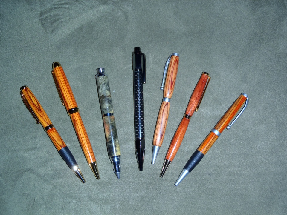

Thank You all again for the great information! After reading these replies and looking through the archives I feel that im starting to get a better understanding. Here are the pens my wife wanted for Christmas presents, while they're not the caliber of pens most of you guys turn out but I'm very pleased with the results.

You work looks very nice. If you are happy with your work, then that is all that matters. You will improve with pratice......we all did.

If those are your first pens, you are off to a great start! Ignore certain people, you should be very proud to give those as gifts. I still have the very first pen I ever made and it is one of my most prized possessions, wouldn't part with it for anything.
Keep in mind, EVERYONE was a beginner at one time so don't sell yourself short, you'll learn something new every time you turn on your lathe just like the rest of us mere mortals. Most of us have an ever-growing box of "mistakes" in the shop. As you have already seen, most people here are happy to pass along any tips they can.

I'll bet everyone who gets one of those pens will be thrilled. Good job! :good:
Those pens look great! Don't short change yourself. I really like the look of that Buckeye on that workshop pencil.
