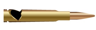

I have about 100 50 Cal BMG Shells that i want to make into Bottle Openers similar to the picture provided. However, All my attempts to duplicate a nice clean cut & angle are failing.
I've used a grinder, Dremel, hand saw and none are giving me a nice clean look.
Any ideas to throw at a beginner to get these cut as professionally as posssible?
Does anyone have any dimensions that they have found successful with these? I'm trying to cut a 25 deg angle into them.

Bi-metal blade on a band saw. I believe that is what Les Elm used to make the original. Use good quality files to clean up the fresh cuts.
I cut windows in my casings with my sander. Works much better than a saw as you have much better control. If you have a tabletop disc sander, you could build a jig to get the right angle.
