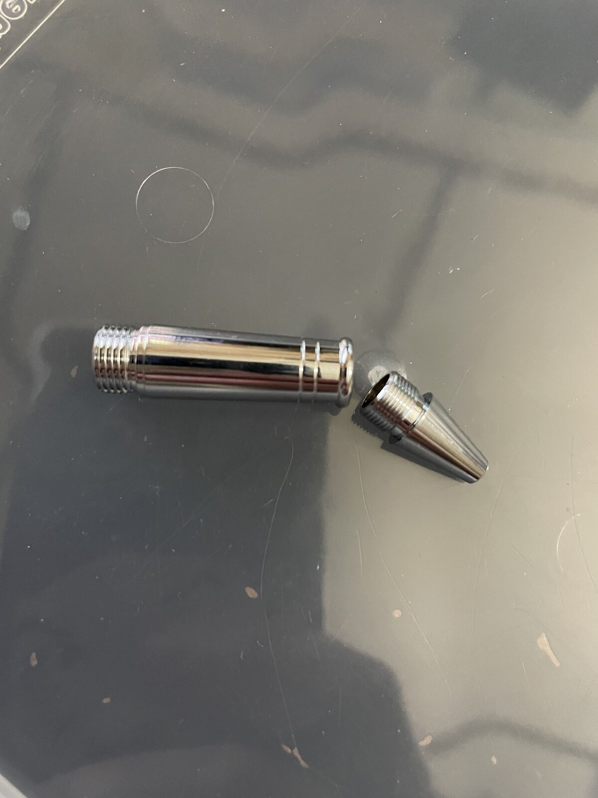

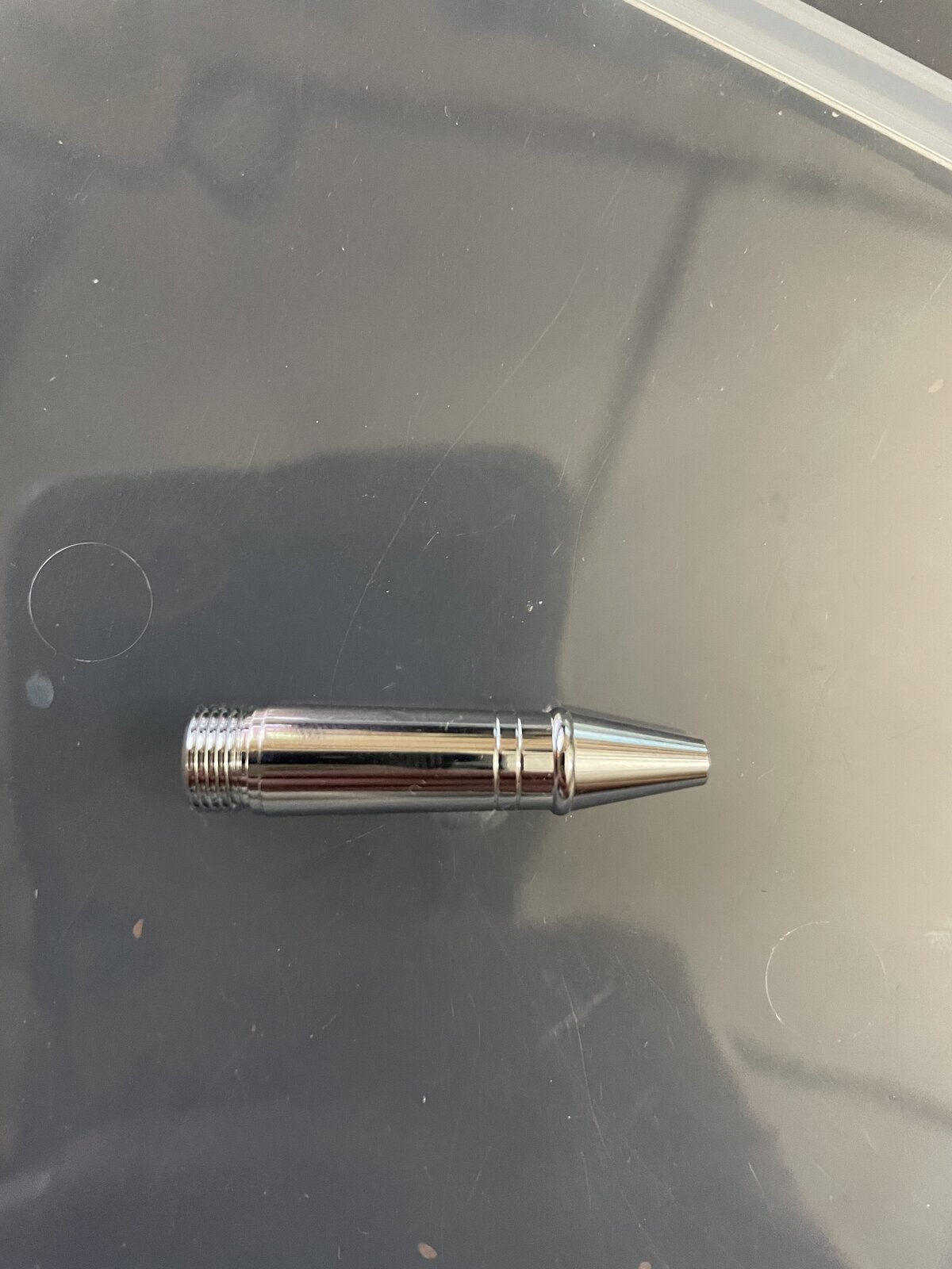

Hi, a customer has asked me to recreate a pen that his wife loves and that broke. It looks like a custom build with a section turned from ebonite or black acrylic and then a chrome plated cone on the end to hold the pen. I was thinking I'd use the very end of a gent section for the chrome cone. Does anyone know what the thread size is that I should use to tap the black piece so that it will accept the little cone from the gent kit?

@EricRN
So, that's the roller ball nosecone ......
Is if for the Full-Size Gent, or the Jr. Gent ?
Somehow, it does not look quite like either......
@EricRN
OK, measured on a similar Jr Gent kit using accurate calipers and a thread pitch gauge similar to that referenced above .....
I make the threads to be ..... M7 x 0.75
The fit on my own die of that size is very good so I have no doubt about this being the correct sizing.
Ignore my post above .... the kit that I have looks the same as what you show in your pic above.
Thanks Mal. I've got that one, I think! I'll give it try and let you all know how it turns out
