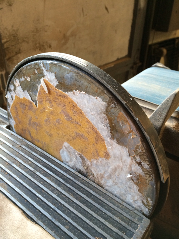

I'm ashamed of myself. :-(
I got a little too impatient and the adhesive on this disk was a little better than most.
Any advice?

use a power palm sander with 50-80 grit on it. Takes it right off, no mess, no muss, just dust.
Notice how so many jumped in with answers? Makes me think you are not the first to do this. Of course I have never had it happen, but I hear a putty knife and mineral spirits work well.

Since I have never done this, of course, I think you will find the application of heat with a hair dryer or heat gun will greatly speed the removal of those nasty remnants.
But, bear in mind that this is all very hypothetical for me as I always am patient in the shop and spend all the time required to remove the disk. :rolleyes:

A Tall shot of Dickel's Tennessee Whiskey (Put on the shelf for LATER!!!); then any of the great suggestions above. :biggrin: Dickel's will be waiting!
Well, I will put scrapping all that off with and carbide tipped tool and re-shave any vibrations, imperfections of the disk surface, the table/tool rest is already there so with the sander on, and working on the left half of the disk plate, I would have the perfect surface (if you know what you are doing) to buy a Velcro self adhesive backing pad of the disk size and stop having this problem every time you need to replace the sanding disc...!:wink::biggrin:

For gods sake don't use a tool while the thing is spinning. Heat gun (hair dryer). You'll be able to scrape most of it off. May take a little bit. You can clean up with acetone after
Dan, I'm with George. I bought 'hook-and-loop' tape with adhesive backing at a local haberdashery (not sure if that's a term familiar to Americans? It's a shop where fabric, cotton thread, buttons etc are sold) and stuck the 'hook' side to the face of my sanding disc. Now I just buy 'hook-and-loop' sanding discs (they have the 'loop' material as a backing). No more mess!

It had lots of crap built up from previous discs as well as the current one.
Grabbed a putty knife vas break cleaner as Andy suggested. Worked well.
I decided to get nice and shiny. Some 80 sandpaper became involved as well.
Got it nice !
