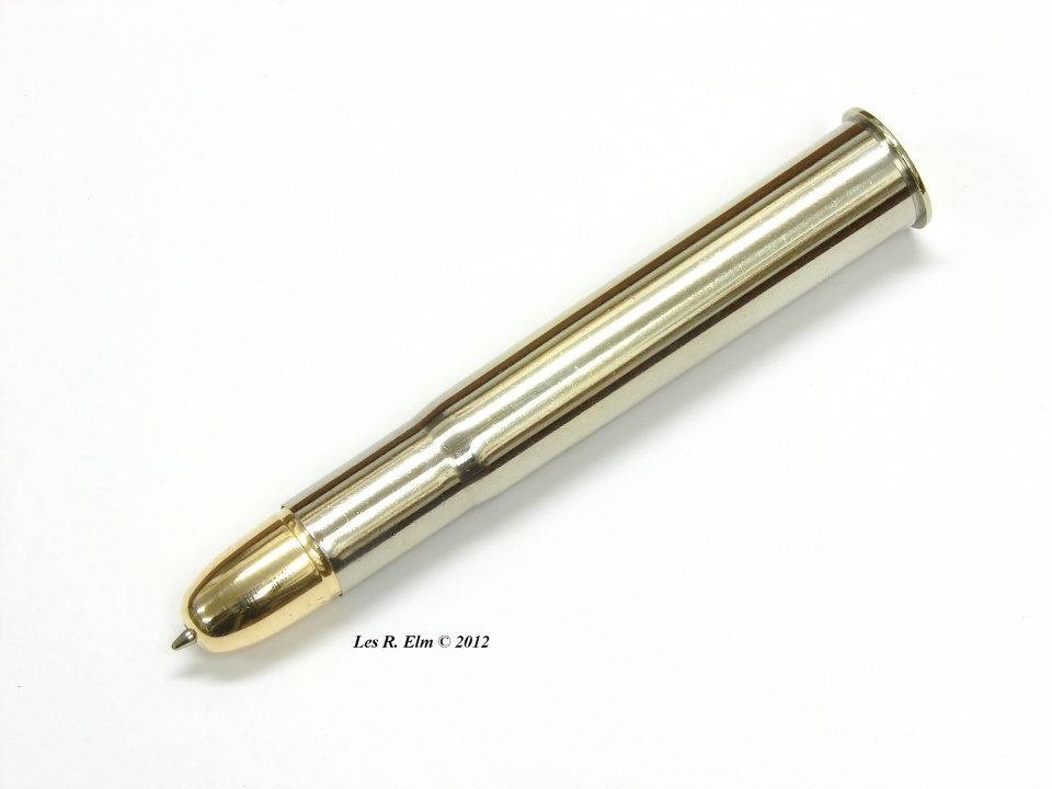

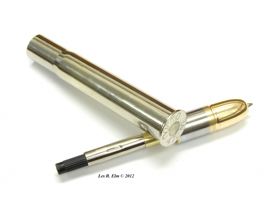

Make this one few years back for a local big game hunter.

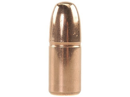

Used a Woodleigh (474) 500 Grain FMJ projectile for the nib.
Put a piece of antler in the primer pocket.
Les
