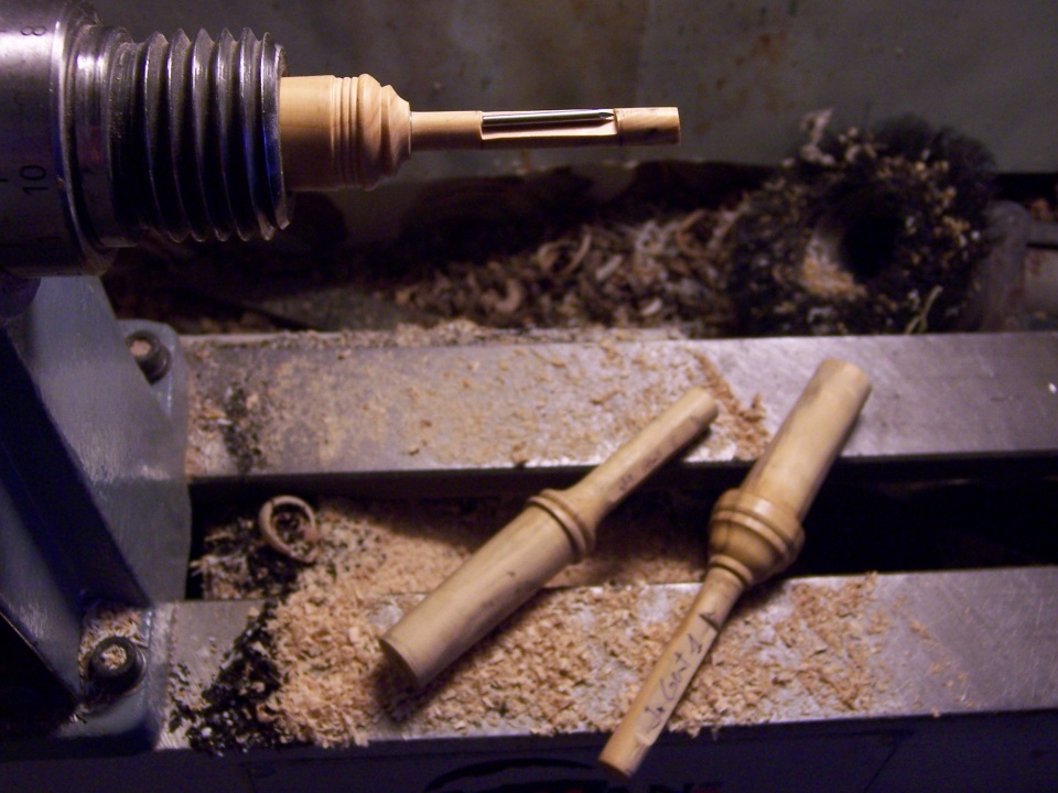

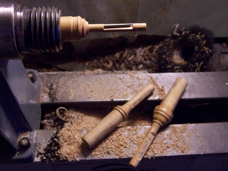

I make most of my closed end pens with pin chucks. I make them in wood, one for each diametrer, so easy to make for a wood turner! It works well and costs nothing.
