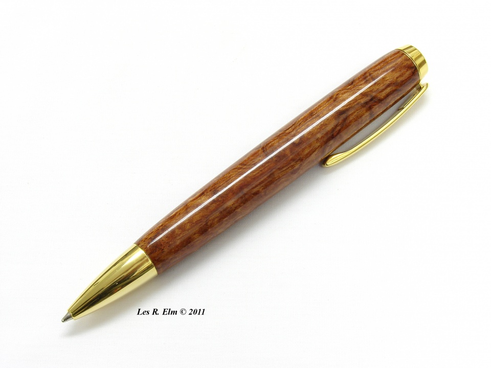

I never ever have any problems with CA.
Les
