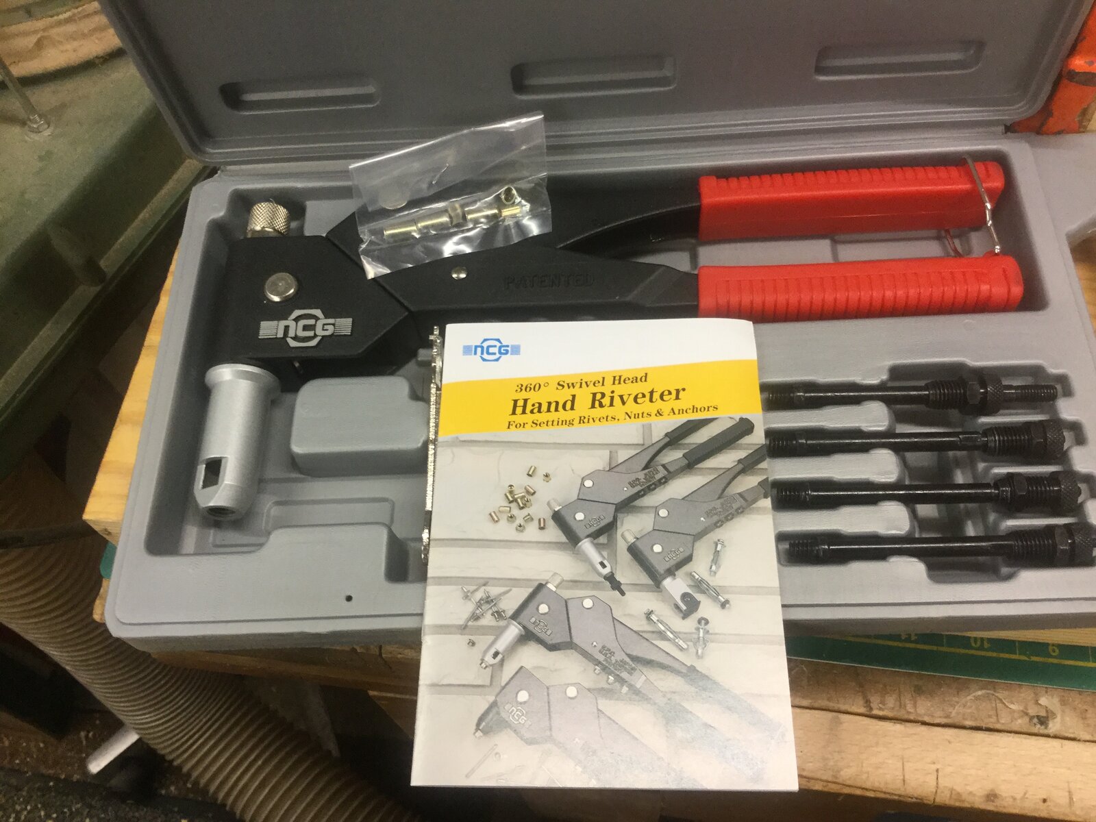

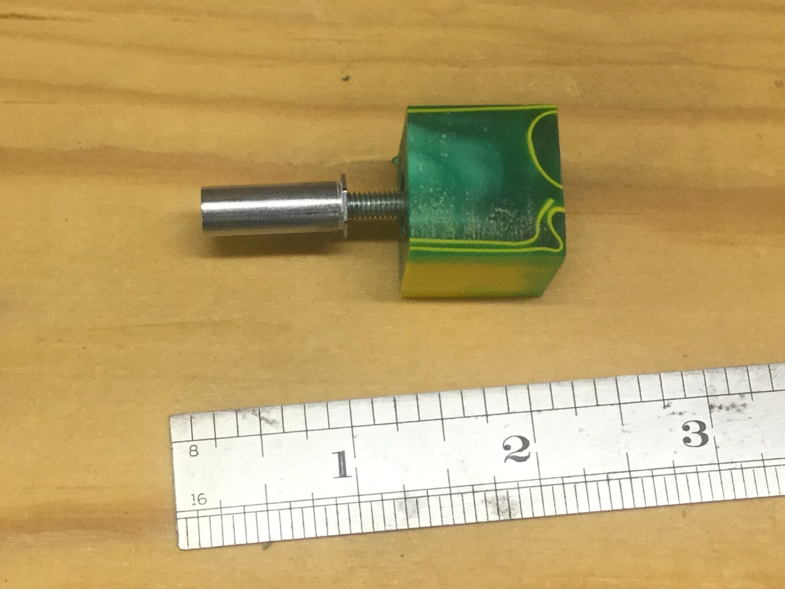

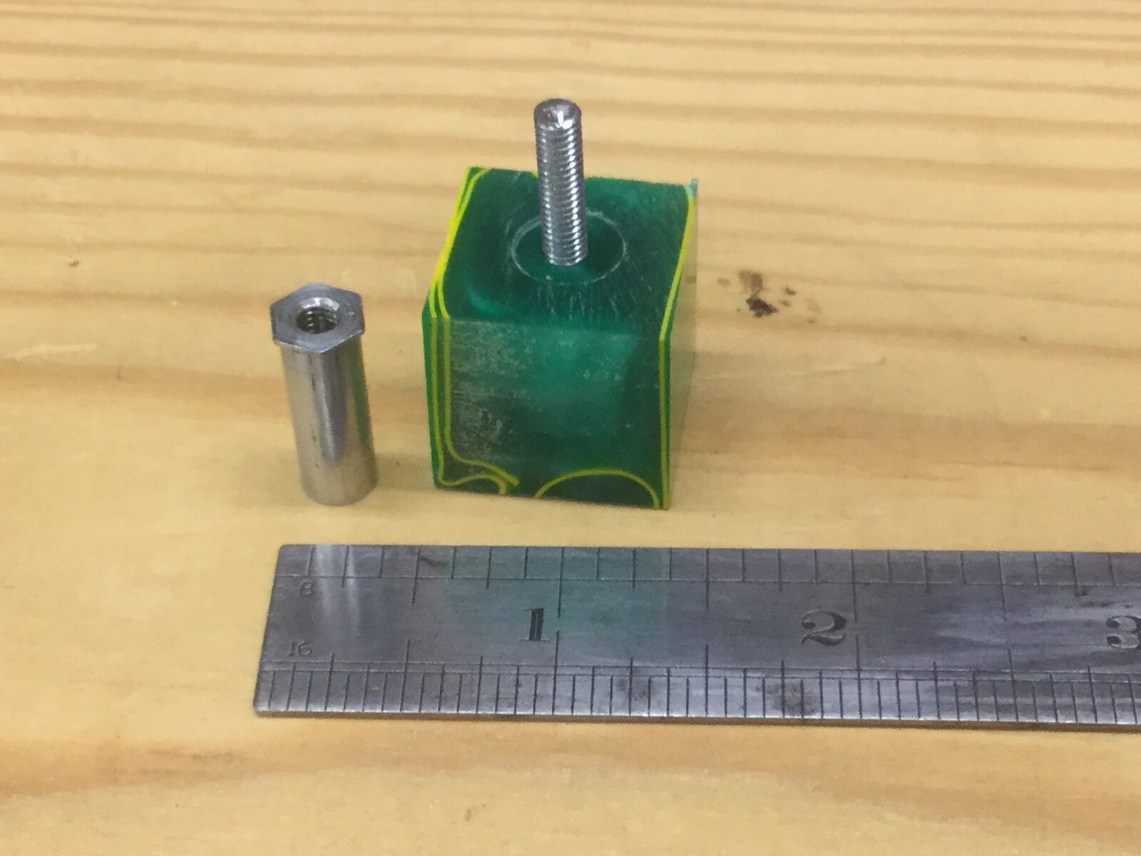

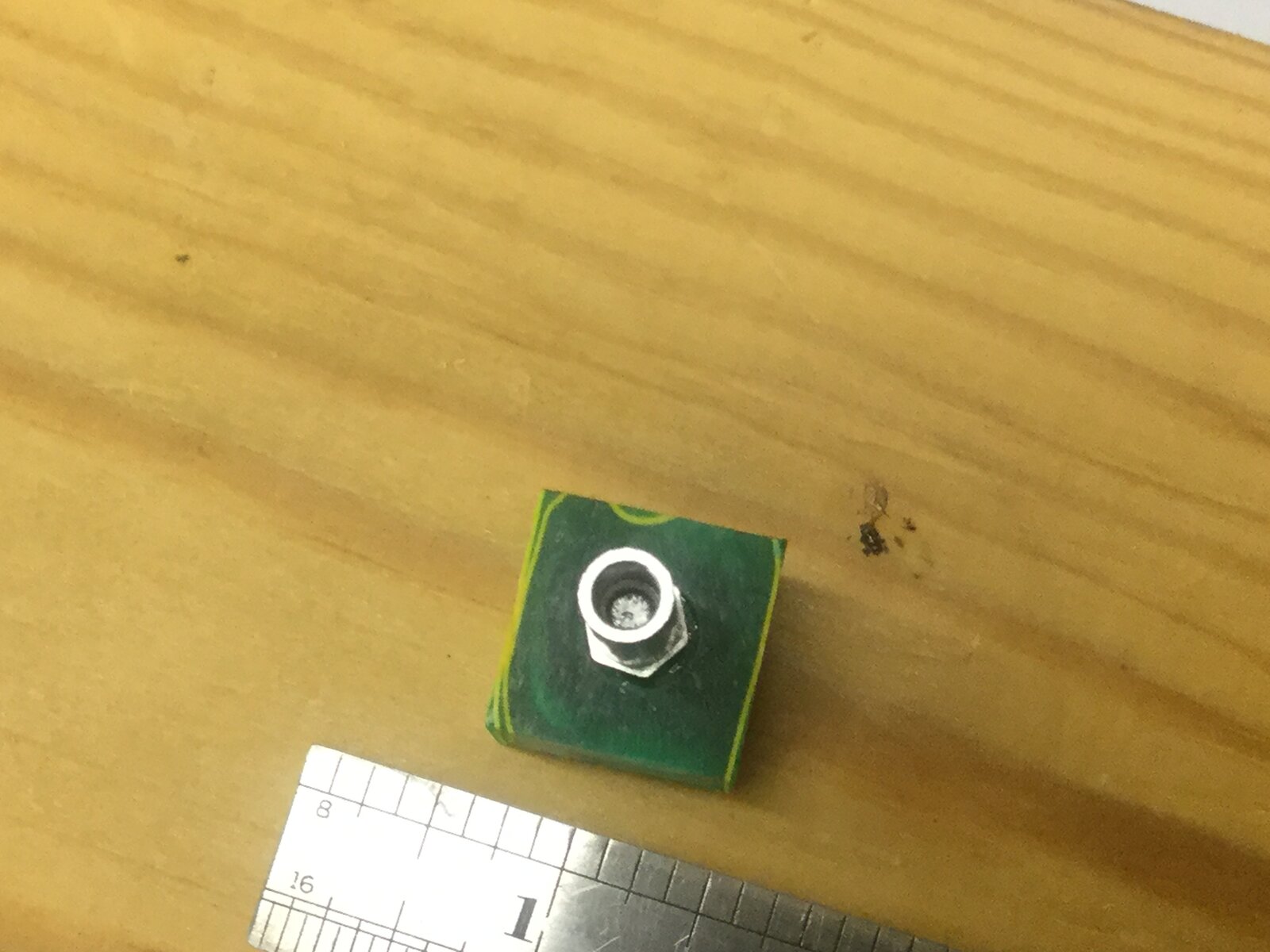

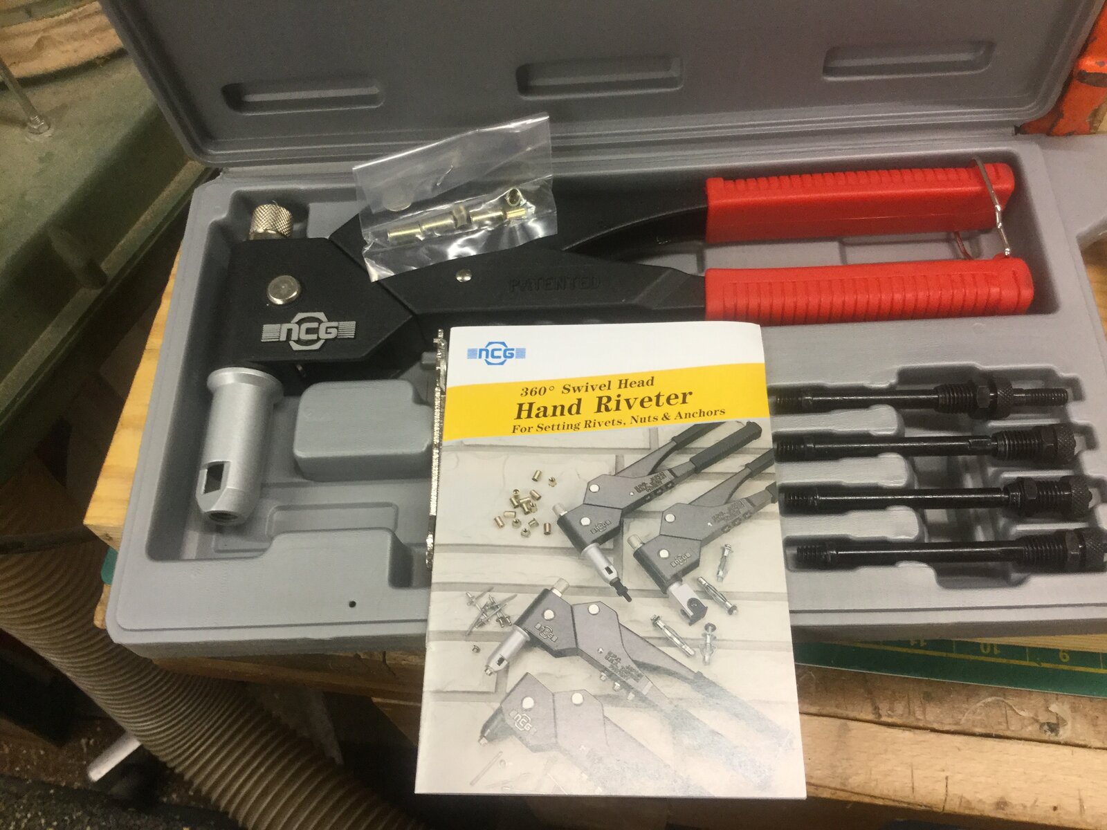

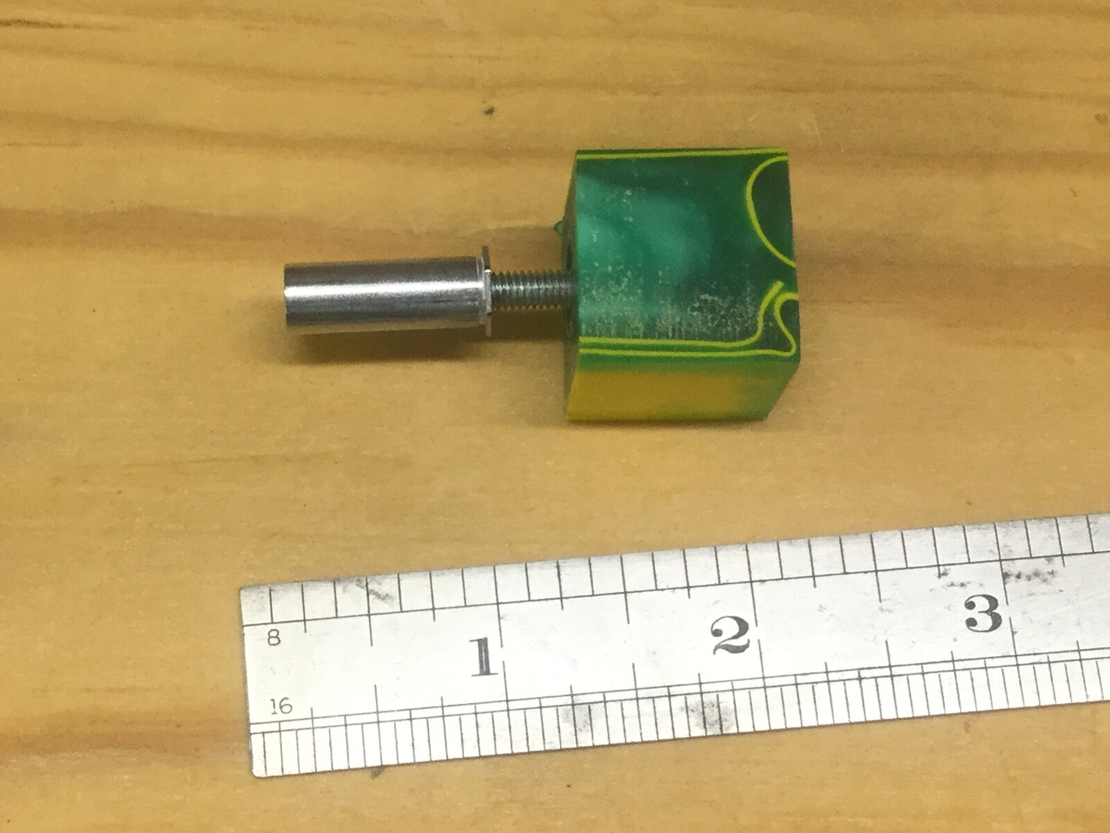

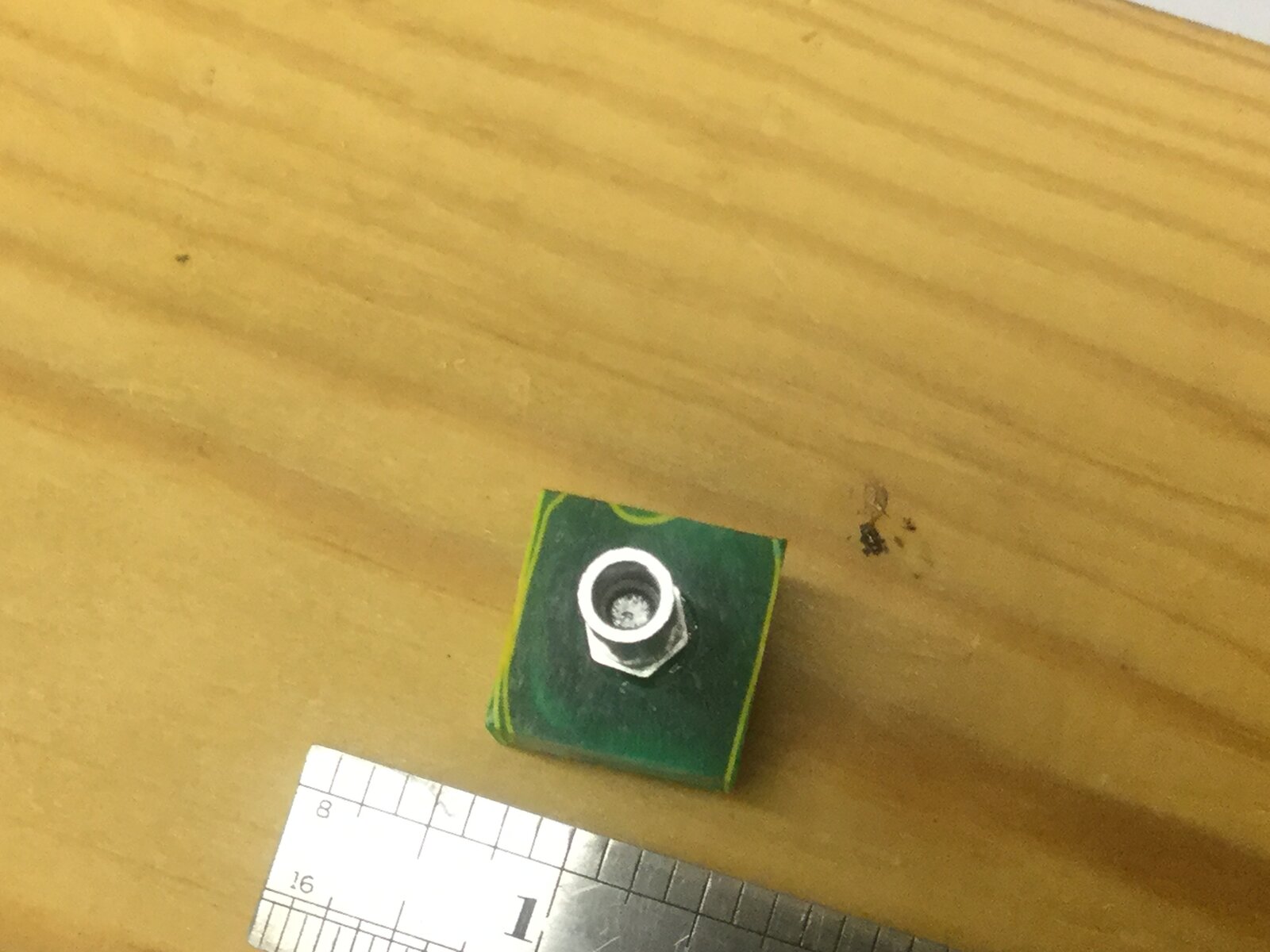

maybe you could adapt aluminium ""Nutsert" inserts? These are used in sheet metal work and use a type of drawing gun to squeeze the collar which then expands into a slightly larger drilled hole.
I use them M4 ( 4mm ) size for holding scraps of resin to make nobs. The. Nutserts are available in a number of threads and sizes over here and must be available over there. 19D0D883-E65A-4E4C-AA1A-C93ACA7D054C.jpeg848D65CF-3BF8-4312-9A05-06BAE34126A9.jpeg

I grip the insert in a jacobs type chuck or collet to turn . afterwards simply unscrew and you're done. With rae earth magnets yo7 can make useful magnets knobs to hold notes etc in the house ( or workshop but they re great gifts for SWMBO and earn many "brownie points " (or tool purchase points as they are otherwise known).šŸ˜‰
