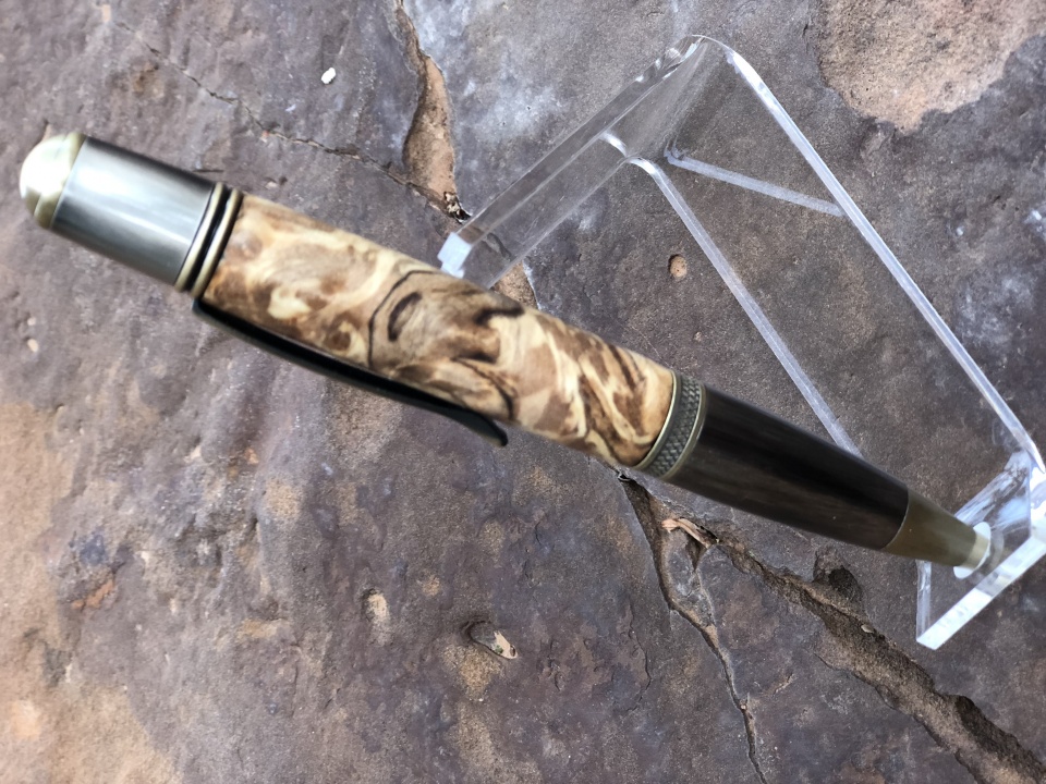

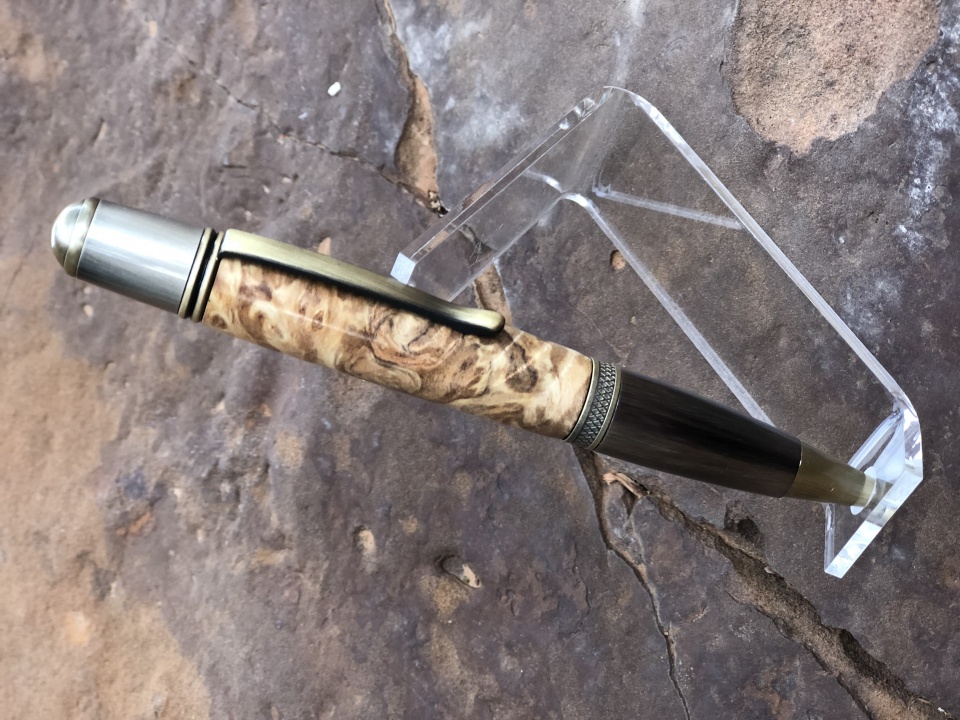

A nice gentleman at church heard we were turning pens and brought me some pieces he'd had stashed in his wood shop for 20-30 years. I have NO clue what species it is, but it did make a pretty pen. My first burl. :smile: But what is it?

He gave us a different slab of a gorgeous burl, but it's pretty thin, just about 1/2 inch. I glued some popsicle sticks to it to help stabilize so we could get it drilled safely and we did turn a beautiful Creekline pen for him, which we gave to him tonight but forgot to photograph first. He was tickled pink. :smile:
The other burl I used for the pen in the pic made a little larger blank. I still have one more. It's pretty soft, I think, but I'm new to all this so I don't have much experience.
My guess is spalted maple of some kind. Hard to say though. For wood IDs, sometimes end-grain pics can help (not always with burls), also relative hardness and weight/density can be help (compare to known common woods).
Here are a few from IAP that I think look similar:

Thanks for the input! I thought if I had a few ideas to toss around with him it might jog his memory.
Those pens are beautiful and mine is definitely not in the same class. I do think it looks like mine is similar to the maple ones, maybe. :smile:

My questions weren`t as precise as they should have been . Is there a difference in hardness between the light and dark areas in hardness , as measured by pushing on it with a fingernail ? Very soft wood will dent easily with minimal pressure , hard wood will show very little , even with high pressure . Not a very scientific test but it does provide some information .
Is the black line around the `tooth` area a void , a bark inclusion line , or a spalt line ? If a void , you did very well to keep it all together . Doesn`t really look like spalt when I blow the picture up , and certainly not like any maple I have , but I don`t have it all . Bark might be a bit softer than the adjacent wood .
Good idea to jog his memory any way you can . Delighted you were able to use the half inch material . Many wouldn`t even try .
