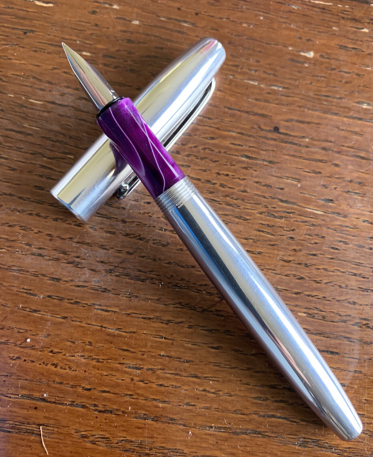

I'm getting ready to make a new version of my daily carry pen. This time out of Titanium instead of aluminum. Any recommendations for carbide inserts that work for this material or should I use HSS? Open to any suggestions for turning, drilling, and threading.
