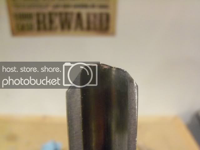

When I first got my lathe and a set of tools, I grabbed a box that I knew were not the best, and wanted them to get me far enough to get adicted. Well I noticed my roughing gouge is looking pretty bad. I have a wet stone I can sharpen but the edge is not straight it looks like it has was chipping or frankly just falling apart.
I would like to start replacing my tools and want some suggestions on a particular brand etc that will give me the quality I am looking for.

Steve, there are many tool manufacturers and as many ideas of the correct tools to use. Myself, I'm a cheap skate. Most of my tools are carbon steel or HSS. Problem, sharpening. Not long back I made the purchase of a wonder tool called Woodchuck BowlPro by Ken at http://www.woodchuck-tools.com/. This tool is complete amazing and well worth the price. It leaves a finish on the blank that requires very little to no sanding other than MM.
The tool you picture appears to have been a bit hot at one time or the other, possibly dropped. Take your time and grind it back down to good metal without allowing the metal to change color. Use a wet grinder or keep a dish of water close to douse the tool into to keep it cool. Put an edge back as close to the original shape as possible and it should do for a while. It will require a touch up from time to time. Check on UTube for sharpening videos.

Steve; Is that a carbon steel (CS) tool? CS tools can have their hardness removed during grinding which is why High Speed Steel (HSS) tools are now the norm for woodturning. The difference is CS tools can be much sharper than HSS but don't hold the edge as long under power turning contitions. HSS can be power ground without losing their hardness.
I believe you are seeing the normal bur on the gouge. After sharpening you should use a rounded stone on the top side of the gouge to remove the bur.
