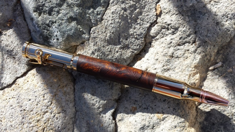

This is a DIW I did a few weeks ago. I tried a few different finish options and finally just buffed it out...much better this way IMHO.
