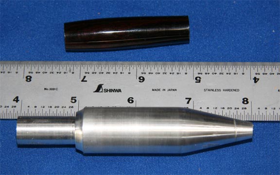

This is the problem that drove me to using TBC or turning between centers. The breaking away of the bushings, even when scoring the CA to the edge of the bushing to pull the bushing out would cause lifting.
Of course I used acetone to try and eliminate oilyness and increase adhesion, but that was inconsistent at best.
I have never had a problem with lifting/separating of the CA since I started turning between centers. Below is a picture of a drive center that I made from a short aluminum rod. At that time, there were only two fellows that had tried or knew of TBC or even spoke of TBC on IAP. Also, they used several terms to describe it including "mandrelless" and "without a mandrel".
[imgz='http://www.penturners.org/photos/images/940/1_Dead_drive_2.jpg']http://www.penturners.org/photos/images/940/medium/1_Dead_drive_2.jpg[/imgz]
View in gallery
Some history here:
By the way, that ebony pen blank in the background is the one in which CA lifted on three different tries and drove me to start using TBC, which basically started the move to TBC on IAP. Frank "Rifleman" and John Goodin "Johnnycnc" both mentioned in a post that they knew of a pen turner (not on IAP) who turned pens without mandrels. That in itself eliminating that lifting on the ends, as well as other problems. Frank had mentioned this several months prior to my trying it. So, after mulling it over and problems 3 times on the ebony wood pen, I turned the drive center, which was retired after getting one from the Little Machine Shop.
Wow, that was about 10 years ago.
