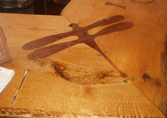

I'm thinking a 'stitch' in the shape of a bowite, or better yet...a bunch of them.
Scott (cracks are character) B
What Scott said but I would let it sit for a while too see how much more it cracks and combine the bowtie(s) with some contrasting filler.

Ken you partially correct. I'm not using tenon in the jaws, but so jar the crack stops about an inch short of the chuck. I'm going to let it sit for awhile and see what happens. I'm leaning towards epoxy and either just put it in or maybe add some color. Time will tell.
Since I'm self taught, I don't know what a bowtie is? Or how to go about installing one?
