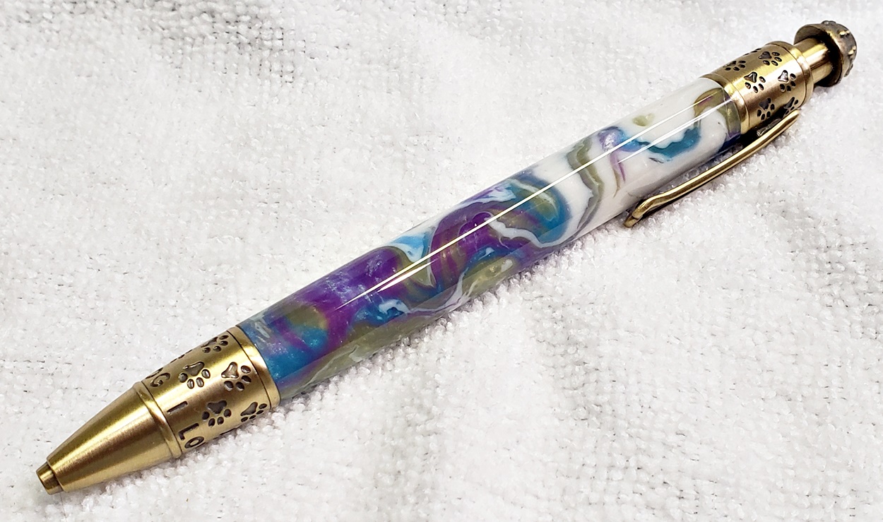

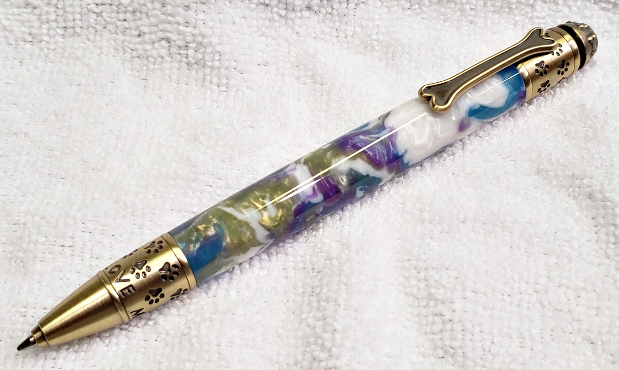

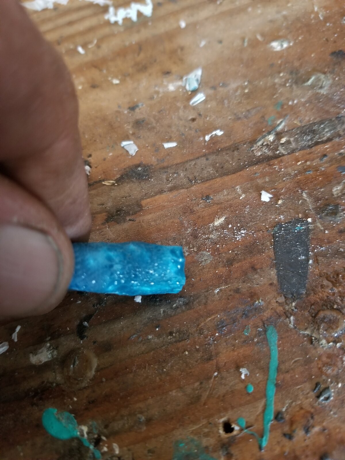

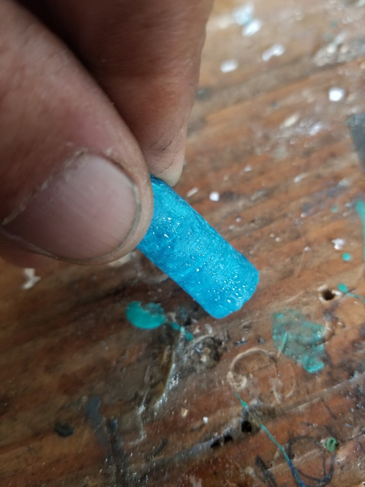

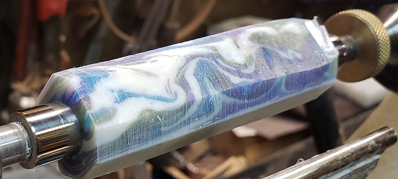

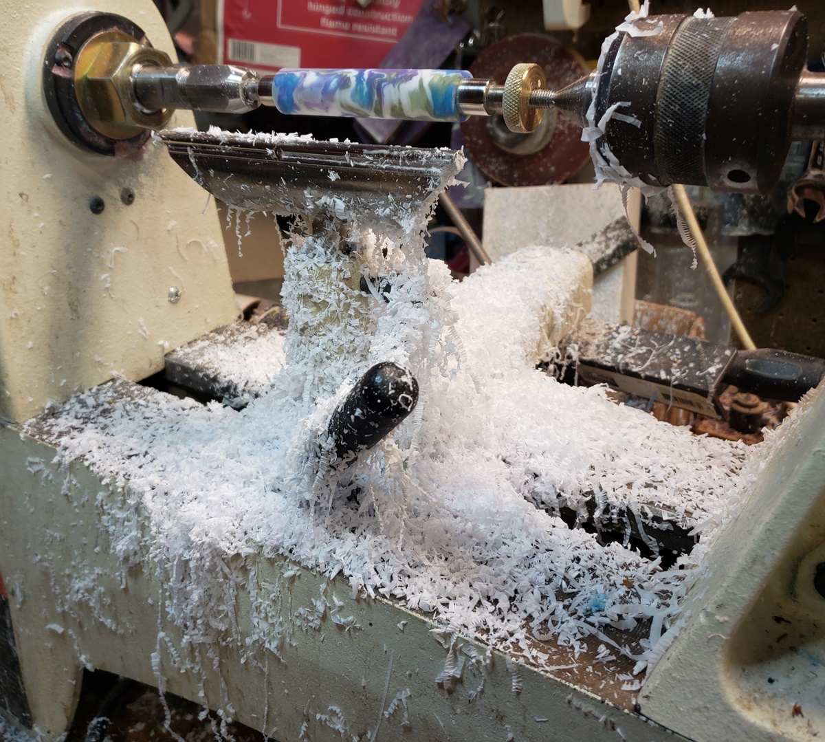

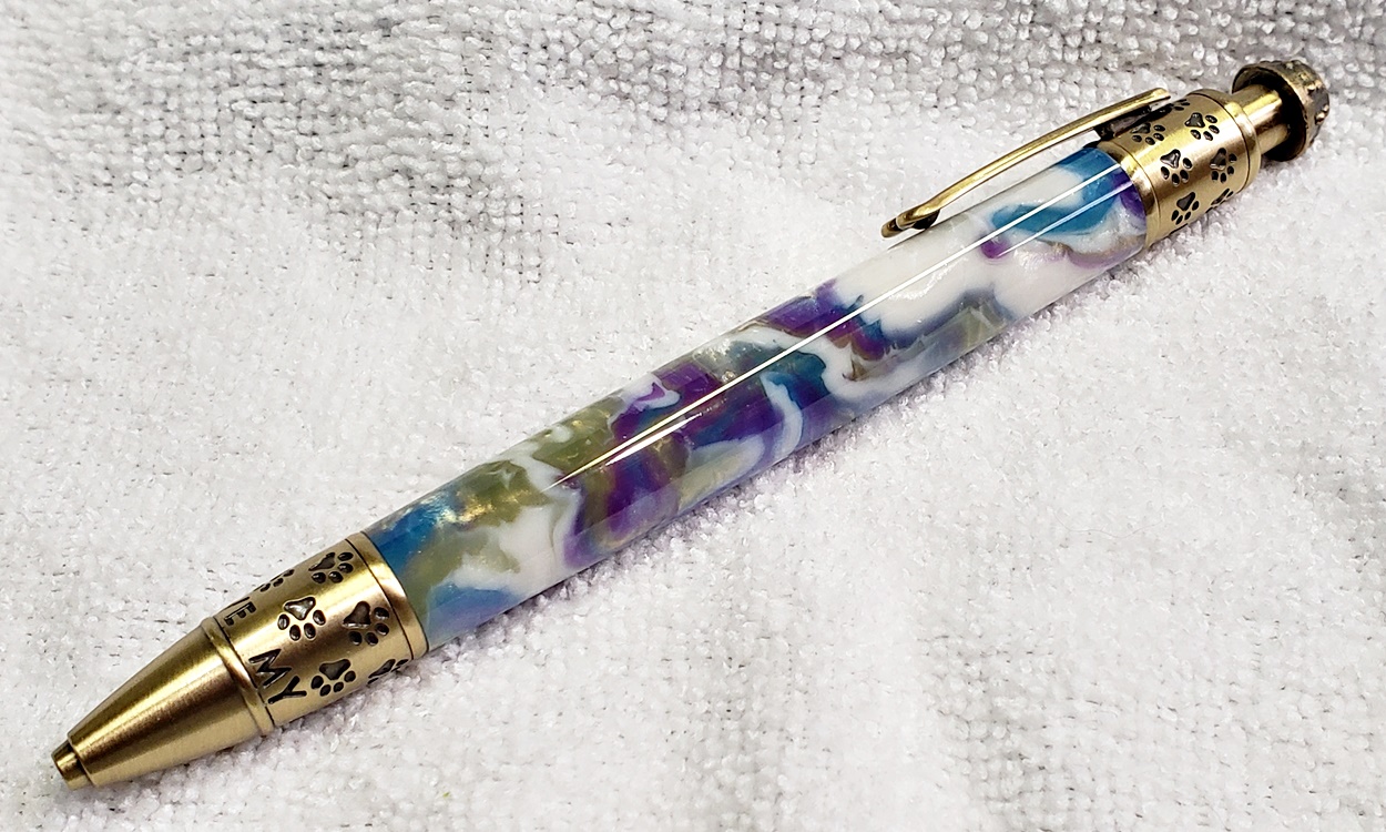

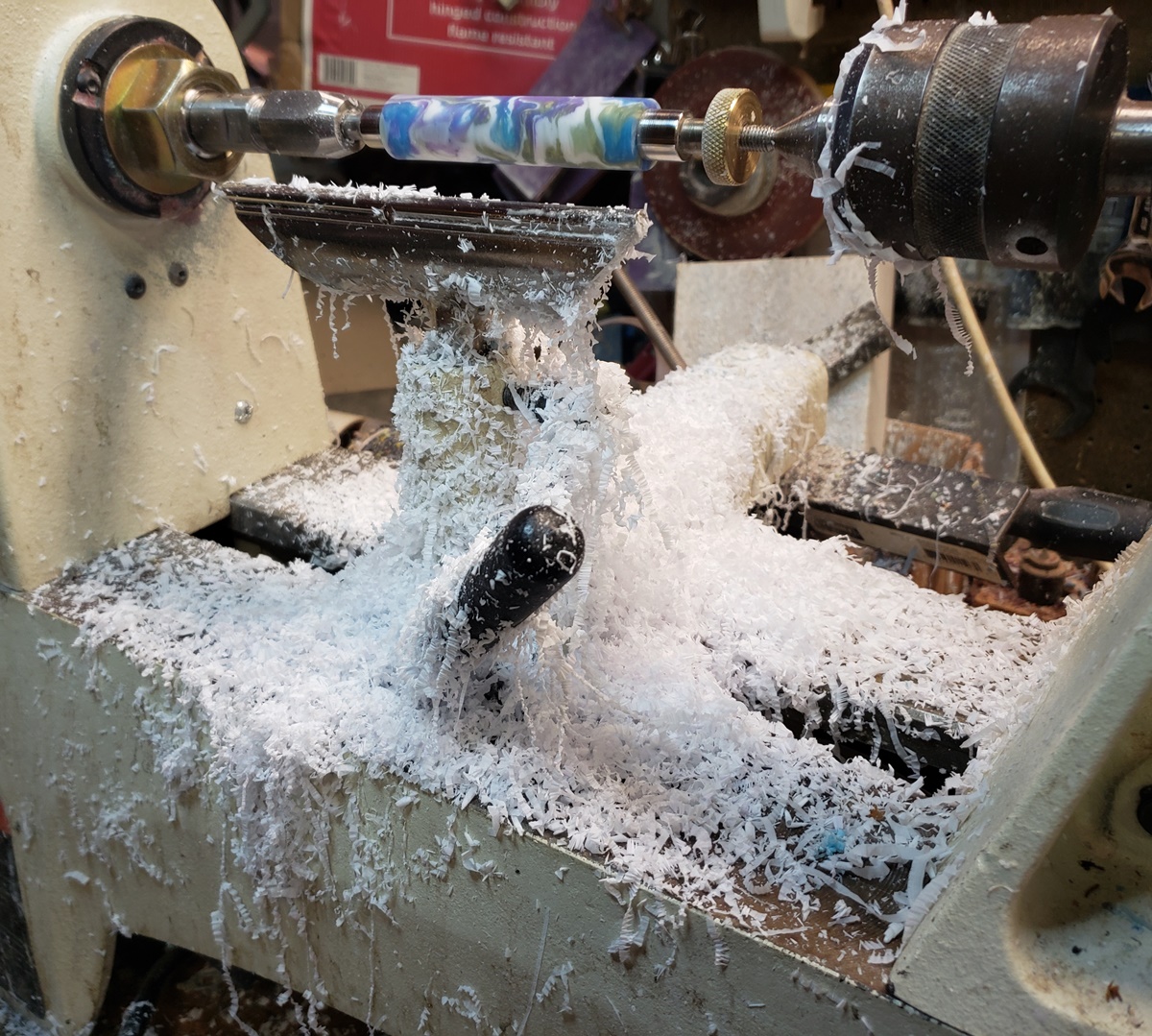

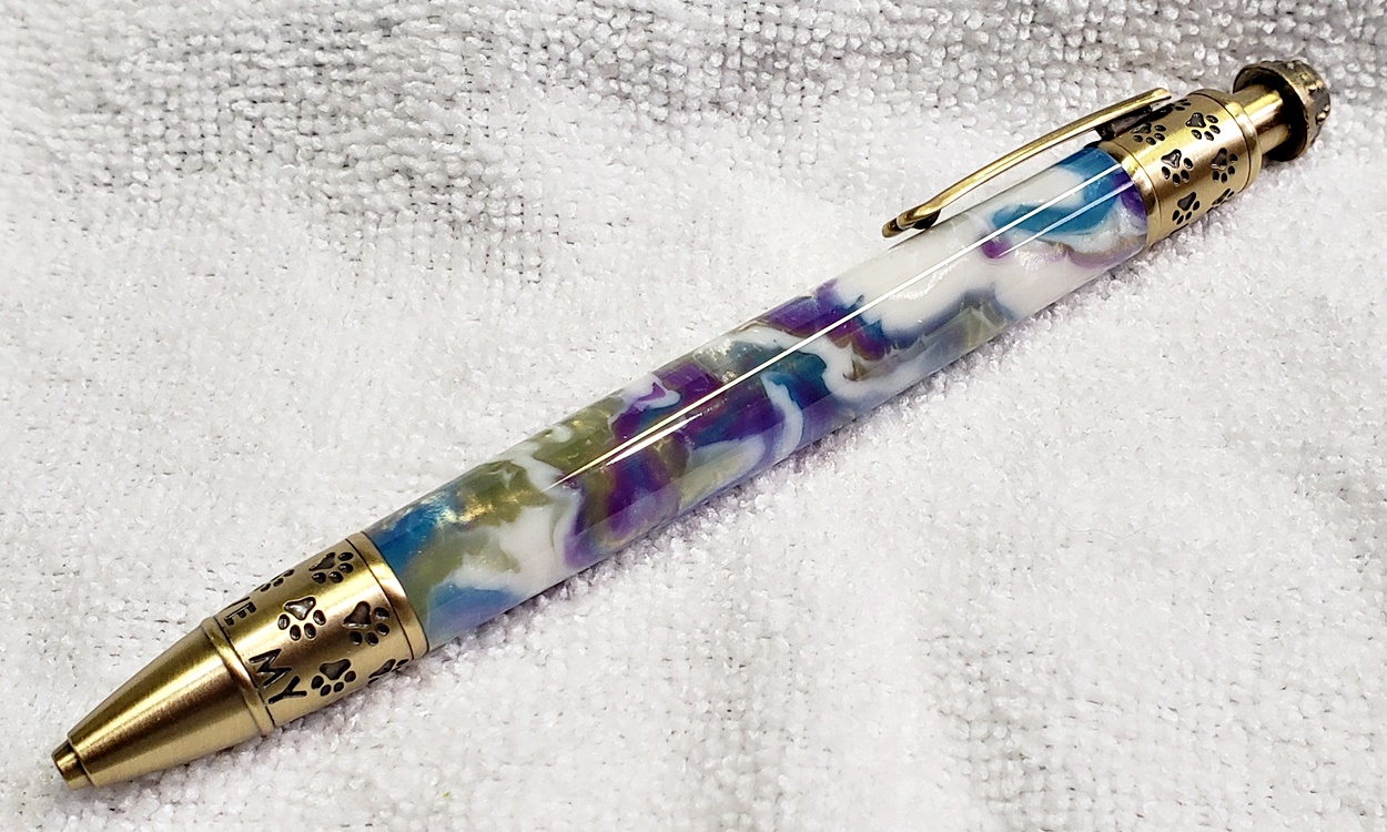

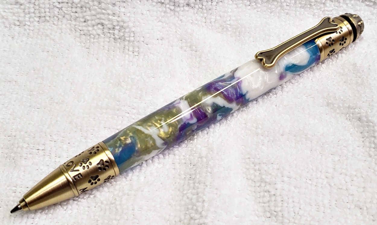

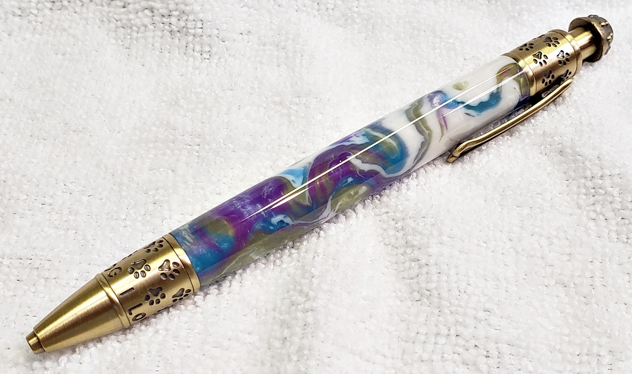

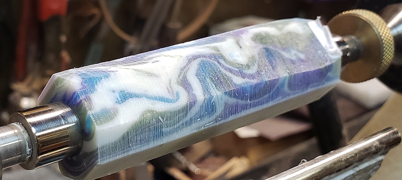

Acrylester is one of the more difficult acrylics to turn. It's very brittle. I've ruined quite a few of them. I used to avoid them at all costs, until I started using a carbide chisel and shearing cuts. Now I don't mind turning them.
This is acrylester. The results are worth the extra effort.
