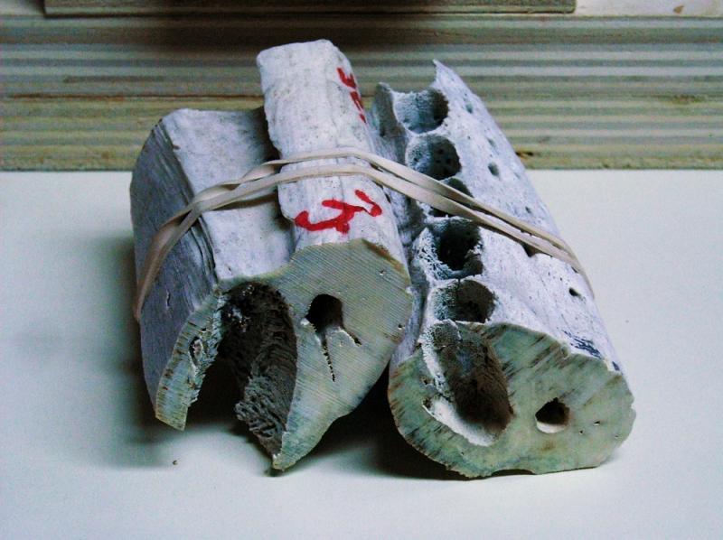

I've came across a set of alligator jaw bone blanks and have never turned them. I did a search and came up with some nice finished pieces, but not really any hints/tips/faults that would help me.
A few questions:
1. Do they need to be stabilized prior to drilling, i.e. thin CA soak?
2. Would it be better to determine what you would like to go in the tooth sockets, such as turquoise powder, mixed PR, dyed/tinted epoxy prior to drilling. (seems like it may make it more stable?) or wait until the end and fill or inlay that way?
3. Suggestion for a kit to get the most out of? I was thinking Majestic.
Thanks in advance for any help you can throw my way!

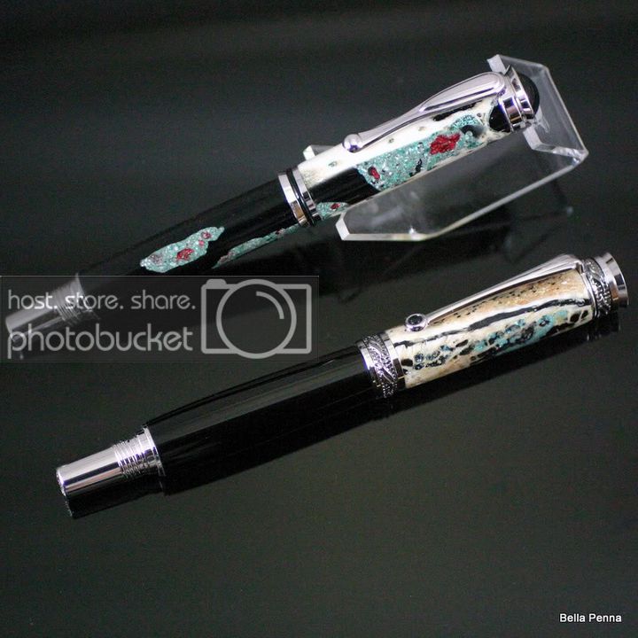

James is absolutely right, I cast all my Gator bone and still have plenty of smaller voids to fill as I get down to size. As James said plenty of thin CA on hand, it will dull your tools in a hurry and the smell is terrible. Wear a respirator as the dust is very fine.Well worth all the effort as it makes one of the most unusual pens you will see.

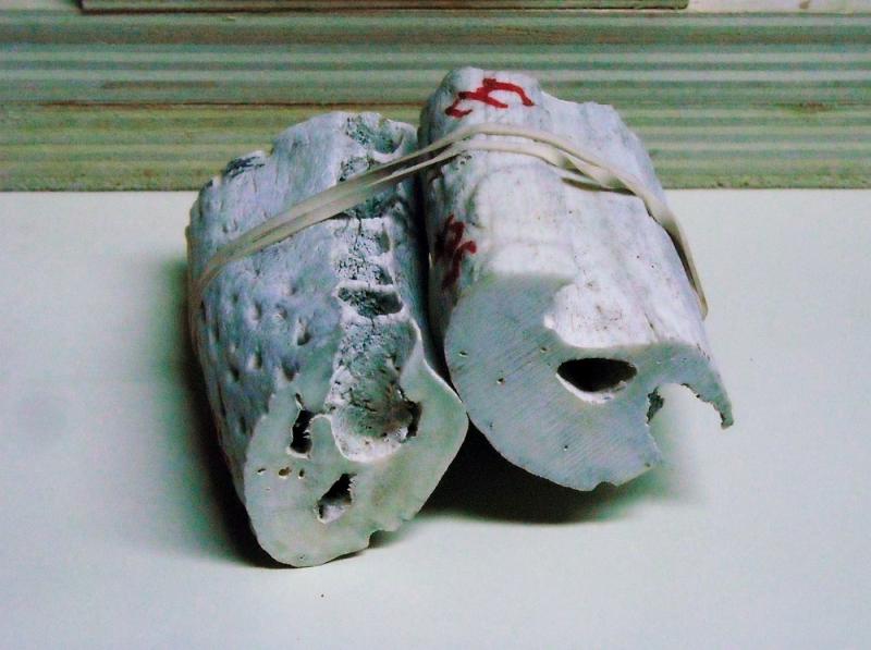

Here are the blanks if that will help you visualize and/or throw in some more input on them.
Roy, that pen is awesome!
