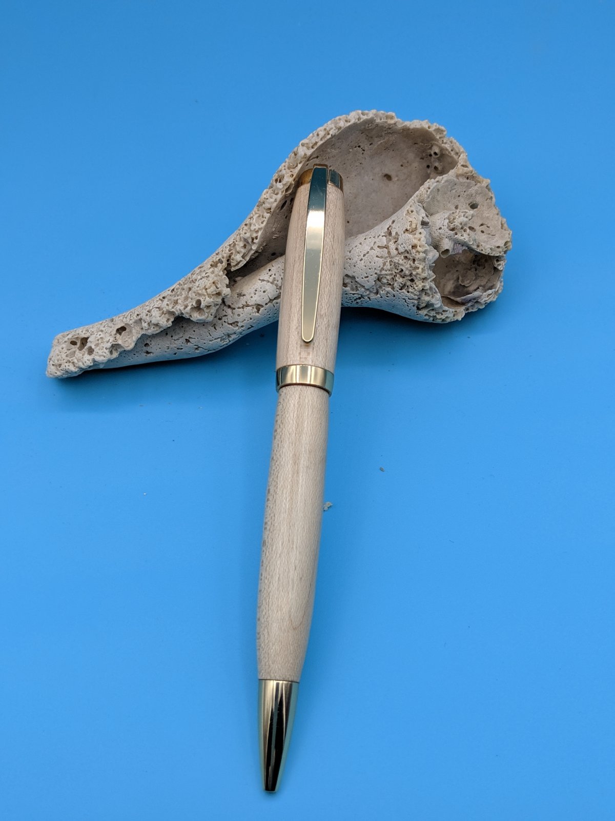

FWIW. PSI sells a kit called the Graduate. 7mm tube on the bottom and 3/8" on top. It's an easy turn, looks great and you get two different sizes to work with on the same pen and you can turn both blanks at the same time on your mandrel.
If I were looking for a single tube I would go with the 30cal as mentioned by Mal (magpens). Another easy turn and looks and works great all put together.
Here's a Graduate I did a while back in Maple and 24kt Gold.
Welcome to the club and have fun!
