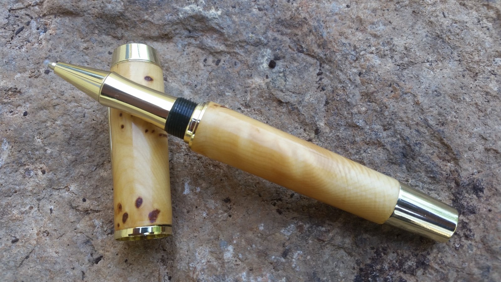

Pictured is one of my latest pens, a Rollerball made of Chestnut Burl and finished with CA Glue and top coated with spray on lacquer.

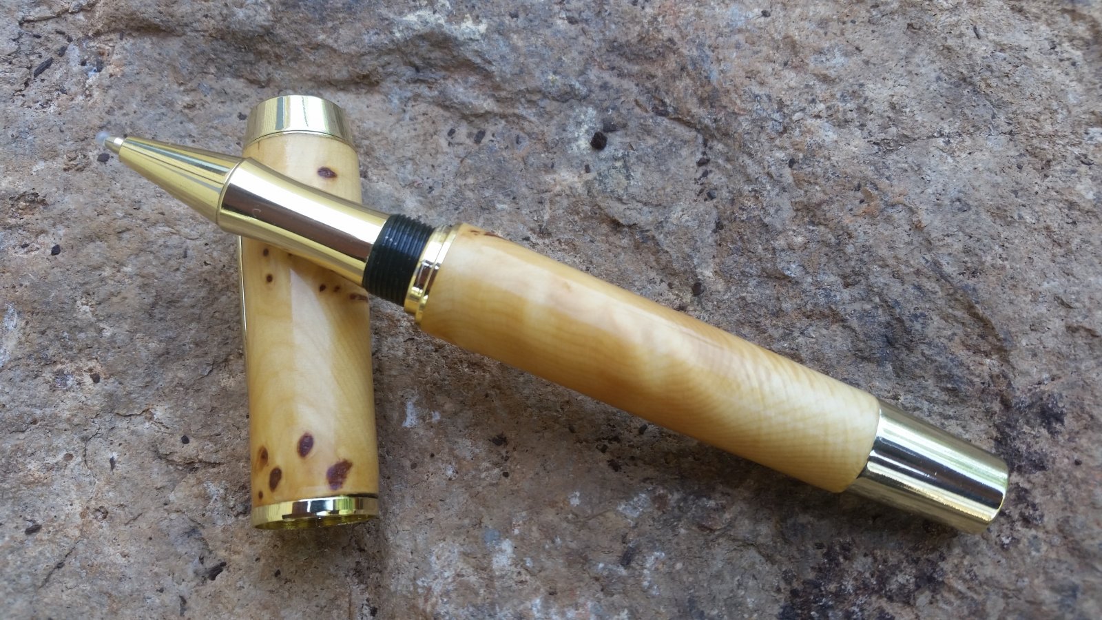

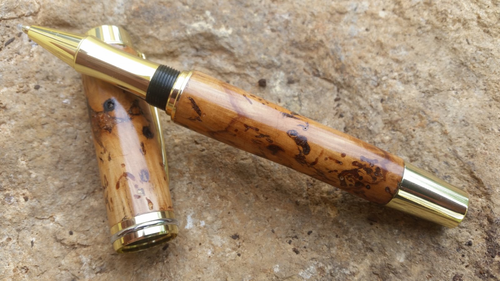

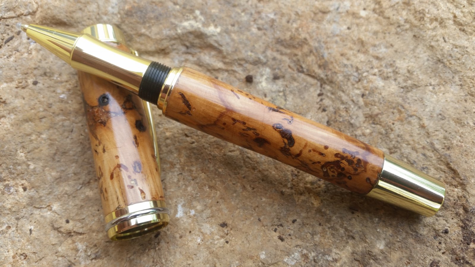

Someone asked about my Lacquer of CA finish, I do this as some peoples skin reacts to the CA. My process is as follows:
Sand up to 240grit cleaning off sanding dust between grits.
Then use Methylated Spirits/Denatured Alcohol and rub that in to clean the surface and raise the knapp. This works especially well I've found with Tassie Blackwood and Huon Pine.
Then depending on the timber, and whether it has a probability for good Chattoyance, usually Tassie Blackwood or Huon, I'll use Thin CA with BLO, by placing a liberal amount of CA and BLO onto a paper towel, then rub that in until it starts to get tacky and hard to move. Then I let that cure without Accelerator. I got this from Martian Sabban-Smith on one of his older YouTube videos. And as he explains, doing this gets the glue right down into the grain, and beside it which brings out as much of the Chattoyance as possible. The BLO on Huon works well and brings out the golden hue of the timber as well as adding it's honey colour.
Then I go through the grits, usually up to 600, cleaning the dust off between grits.
Then I use 3-4 coats of Medium CA, and let cure with Accelerator, and keep the Lathe spinning so the Glue doesn't pool up.
Then I go through the micro-mesh as per most people do, and cleaning off the debris between grits.
Then I use a rattle can spray of Clear Lacquer, building up the coats, depending on the finish look wanted, usually 2 coats is plenty, and I'll leave te Lathe spinning for about 5 minutes to allow the Lacquer to become tacky and start curing. Obviously, the last coat you want to leave whatever the recommended drying time is without touching the surface. I usually leave overnight, or if cold take the whole Mandrel inside where it's warm, and try to keep the kids hands away from it, lol.
The attached photo is a Huon Pine Rollerball that the above finishing was done on. I've since fixed the center band.
