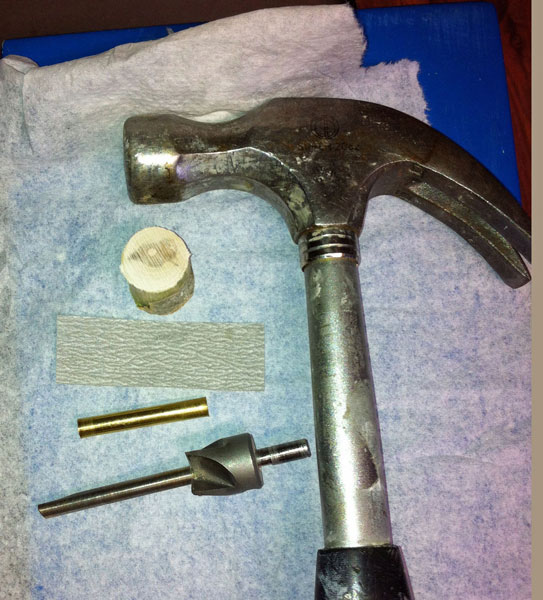

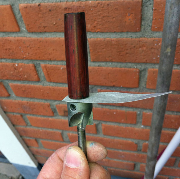

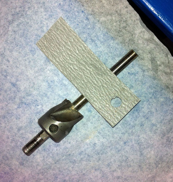

If you just like me need to trim the ends of the pen barrels before or after polishing you can use the "wrong end" of a barrel trimmer to trim the ends. All one needs to do is to punch holes in any abrasives of choice with a pen tube and place the punched paper on the back of the trimmer. Then, just polish until you get satisfied.
If you use thicker than pens than 7mm as I do, use sleeves that fit into the pen barrel.
