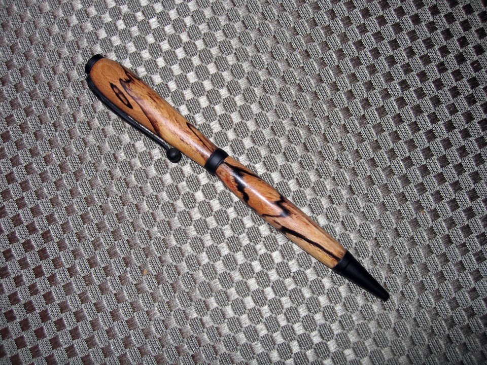

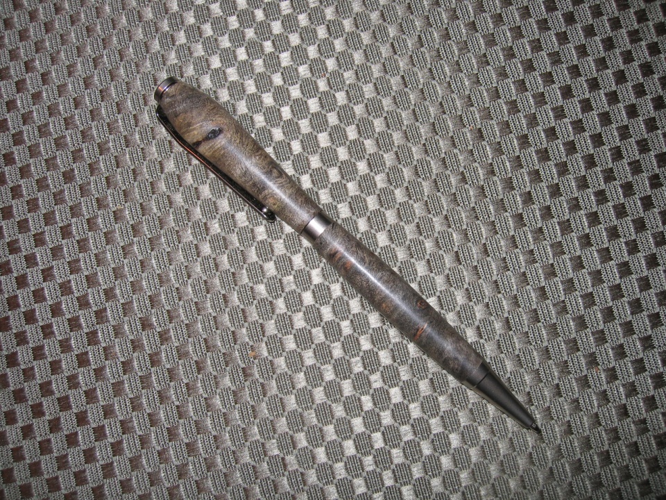

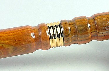

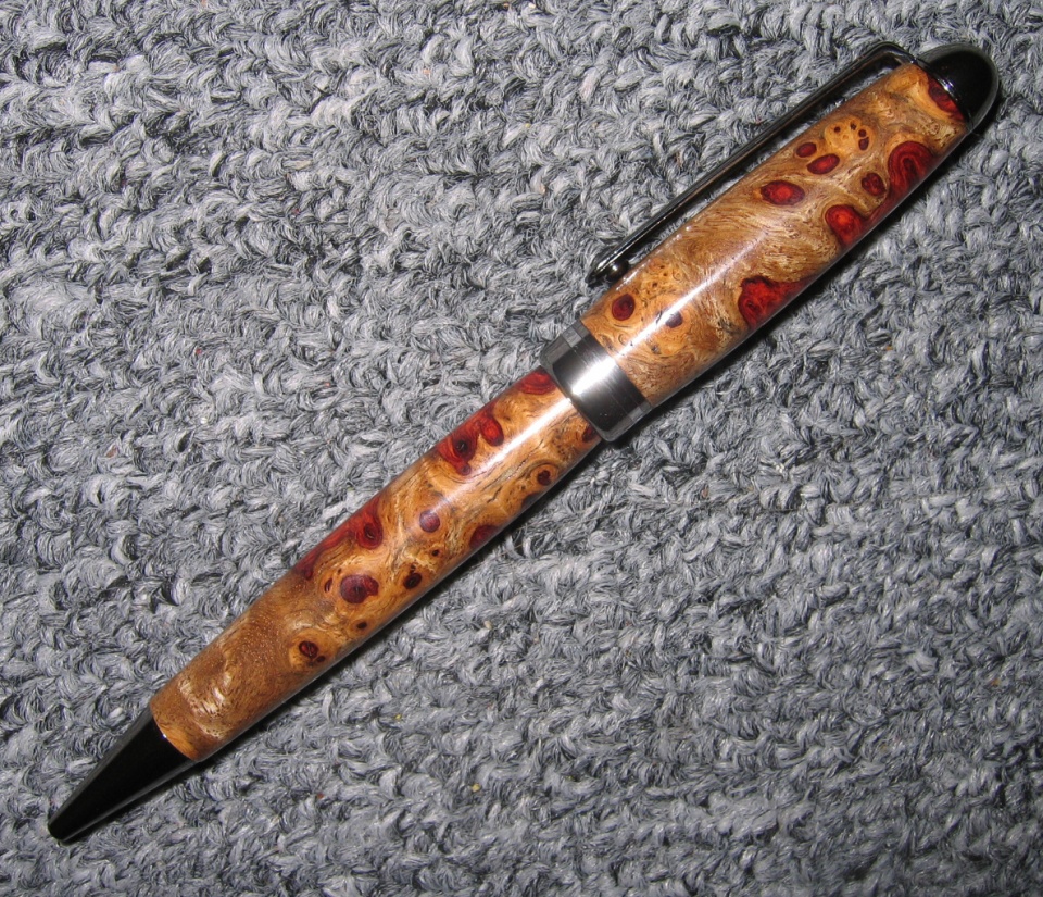

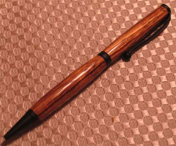

I'm including a picture of a few of the pens I turned for a bit of show and tell!

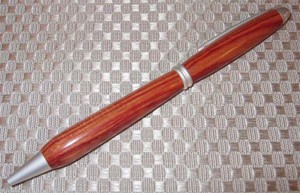

Morning here I use streamline centre bands with slimlines as displayed, they allow a fatter pen. If you are buying now get streamlines first up with this banding. Loved that first pen.
Peter.
Hello there! Thank you for the advice, I have that type of kit coming, and I agree, I like the slightly wider pen. Thanks also for your kind remark on my pen, that one turned out so nicely...and you have to know I was sweating bricks because I didn't want to mess up that incredible burl! :) *WHEW* and then...WOO HOO!! :) Burls like that you can just sit and stare at for the longest time. I look for shapes and faces. Fun stuff! :)
Just a bit more- I used the small roughing gouge to shape my pens. Haven't mastered the skew but it's on the list. For fine work, I plan on grinding down some cheap HF screwdrivers that you get for free. I think I can use then for fine work and shapes.
Hey, thanks for the advice, Woodchipper! :) Oh, now that's a clever idea, grinding down screwdrivers for fine work!
It's interesting what people like for their personal tools. There are many ways to skin this cat! :)
