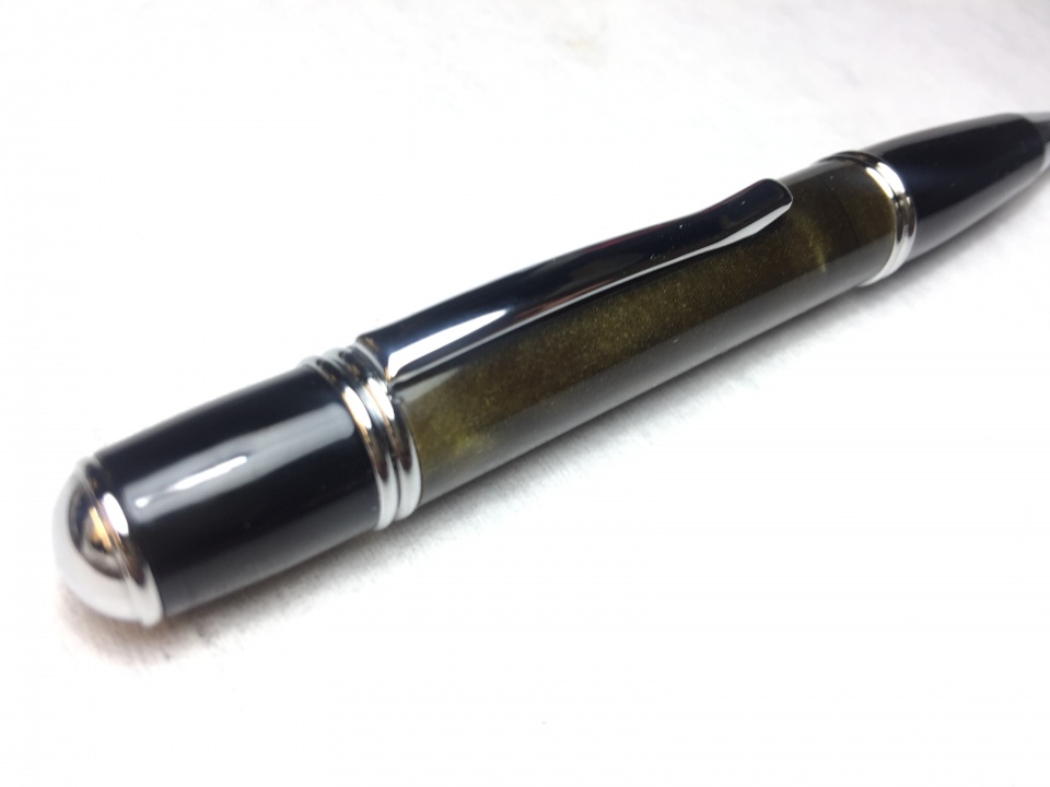

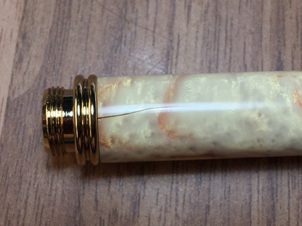

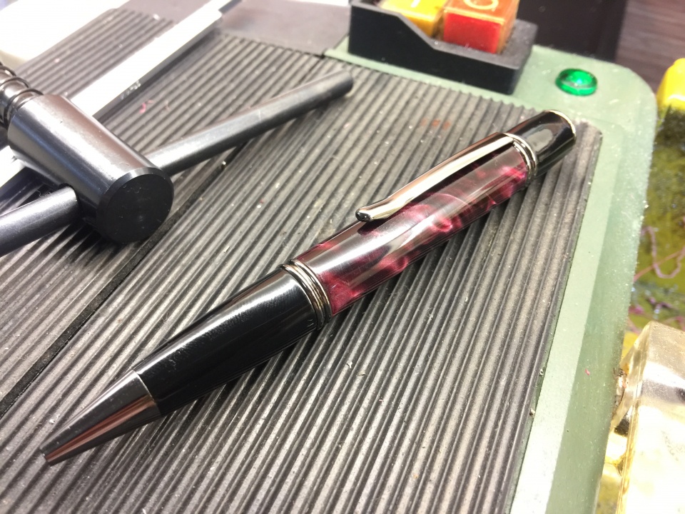

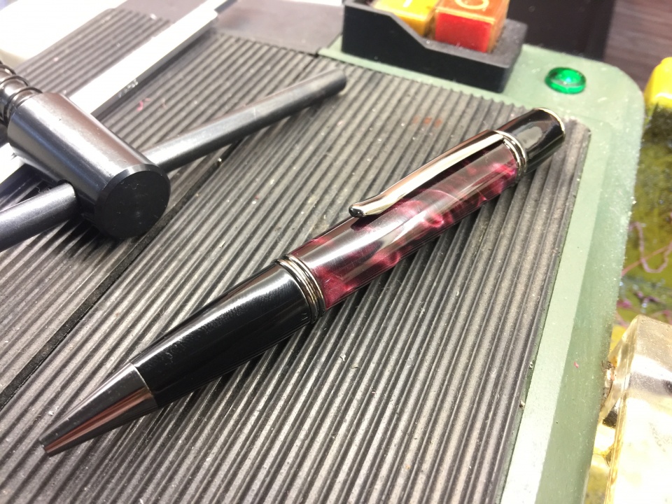

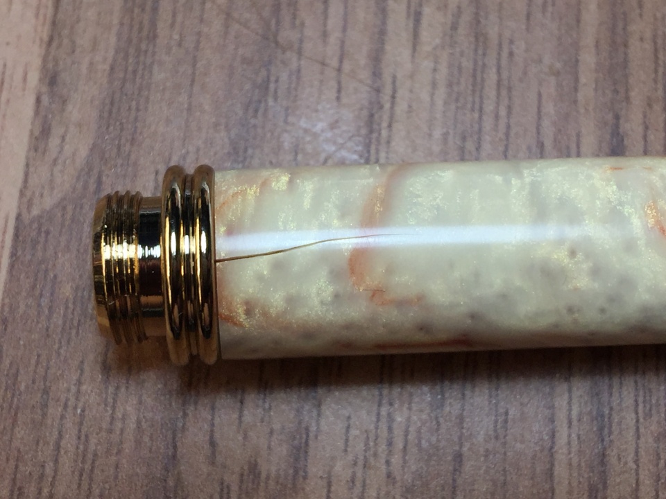

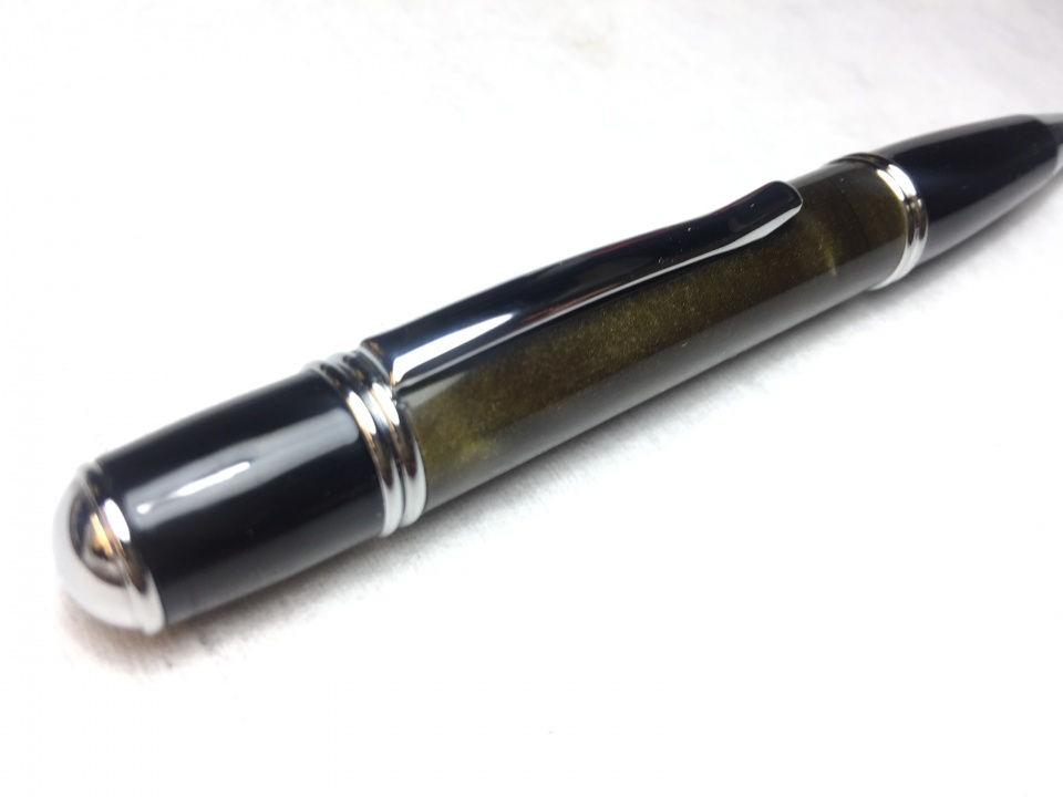

I've attached the pics of my very first 2 pens. The 3rd pic shows the blank that cracked when pressing in the hardware. Can this still be salvage filling the gap with CA glue and polish it back to shine?
Aquapearl Maroon Pearl - my very first. Easy material to work with.
Cosmic Dark Bronze - easy to turn and drill.
Acrylester Crushed Gold - chip every so often. Extremely loud when drilled.

Kyle, Give the repair to #3 a try. Disassemble first and then use thin CA on the crack and clamp. You may have to redo the finish. It's worth the try and good practice. You might also be able to flip the blank so the clip is on that end and covering any crack that might show. May sure the inside of the blank is clean before trying to repress the components in.

When removing the tip coupler from #3, the edge chipped... real bad... I'll keep this for experimenting using the 4th axis to engrave names. Making the text standing out is another thing I'll research about.
