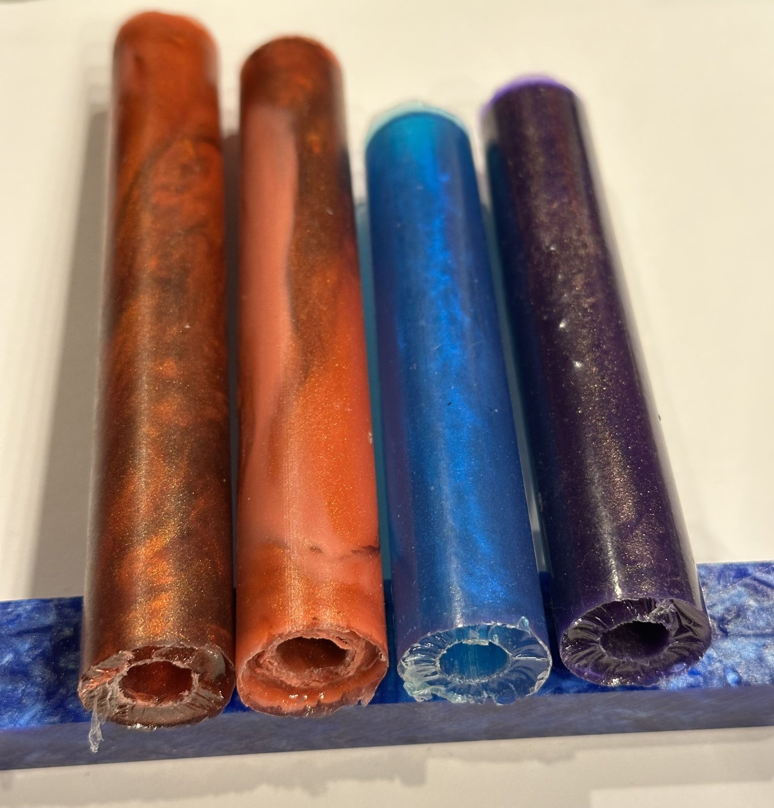

I also do my own blanks. I built a system to make circular blanks with 3/8" holes. Saves on resin and time, because I'm lazy. :D

There are a lot of benefits to doing this. I calculate that for every 4 blanks I make, I get a free one. This is because the rod means I don't have to drill and waste that material.
Even if I do need a larger size hole, the drilling process is faster and safer due to the existing hole and small amount of material to remove.

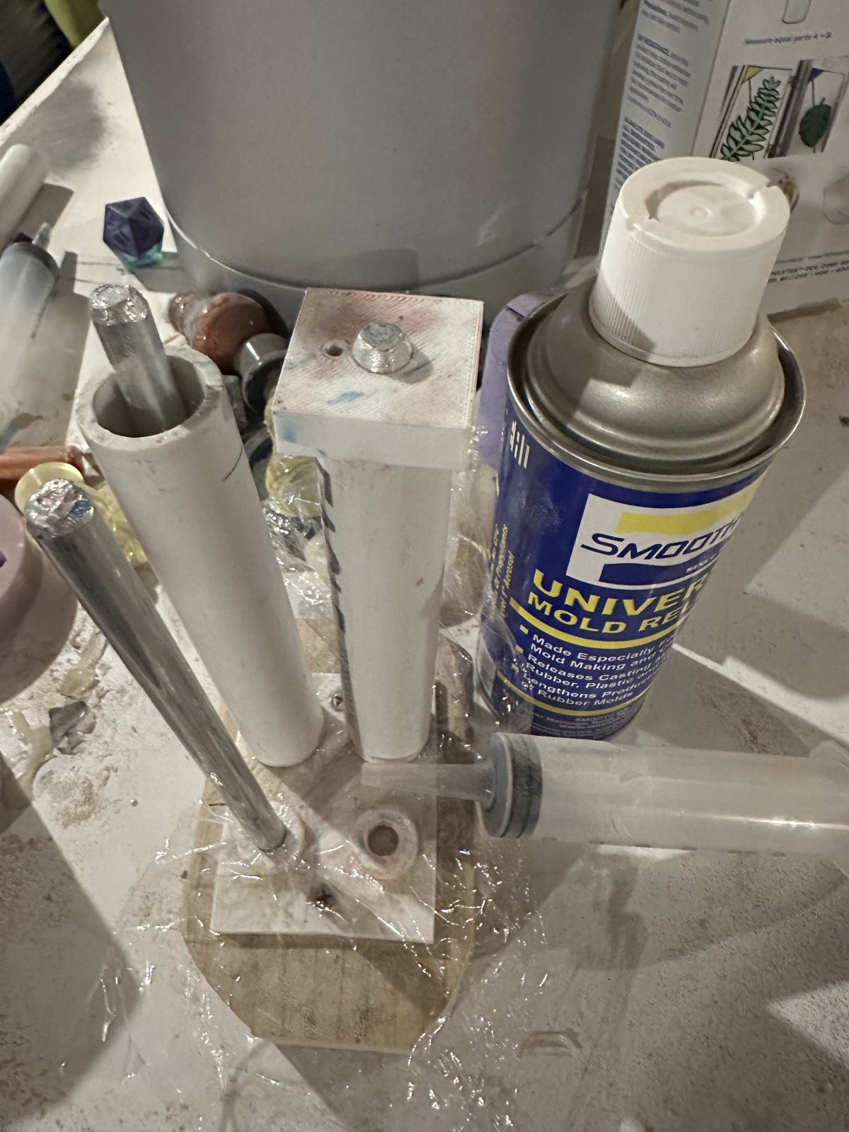

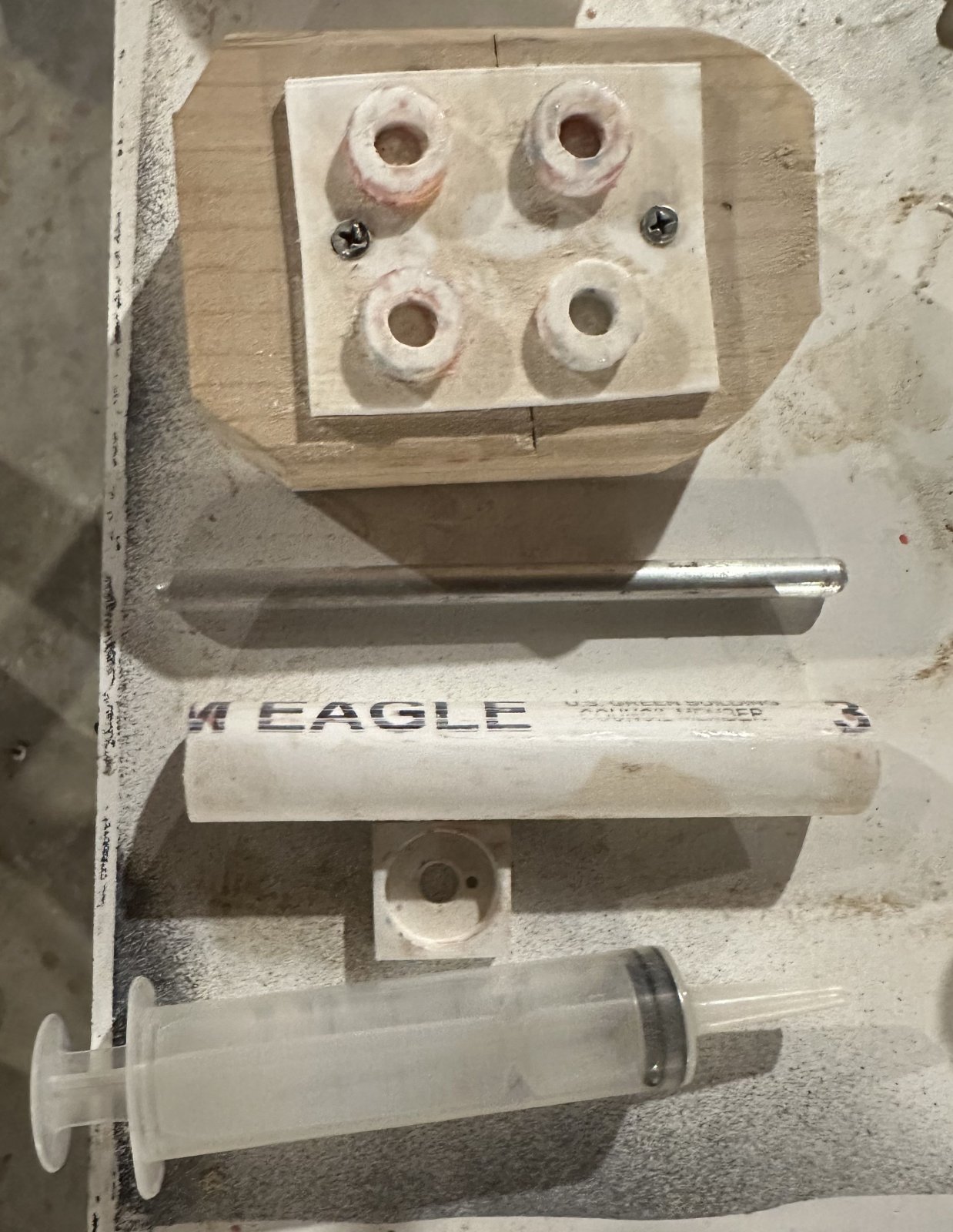

Here is my setup:
Thanks for the photos. I would think that different size "plugs" could be used. I have kits that take several different sizes, some smaller than 3/8.
