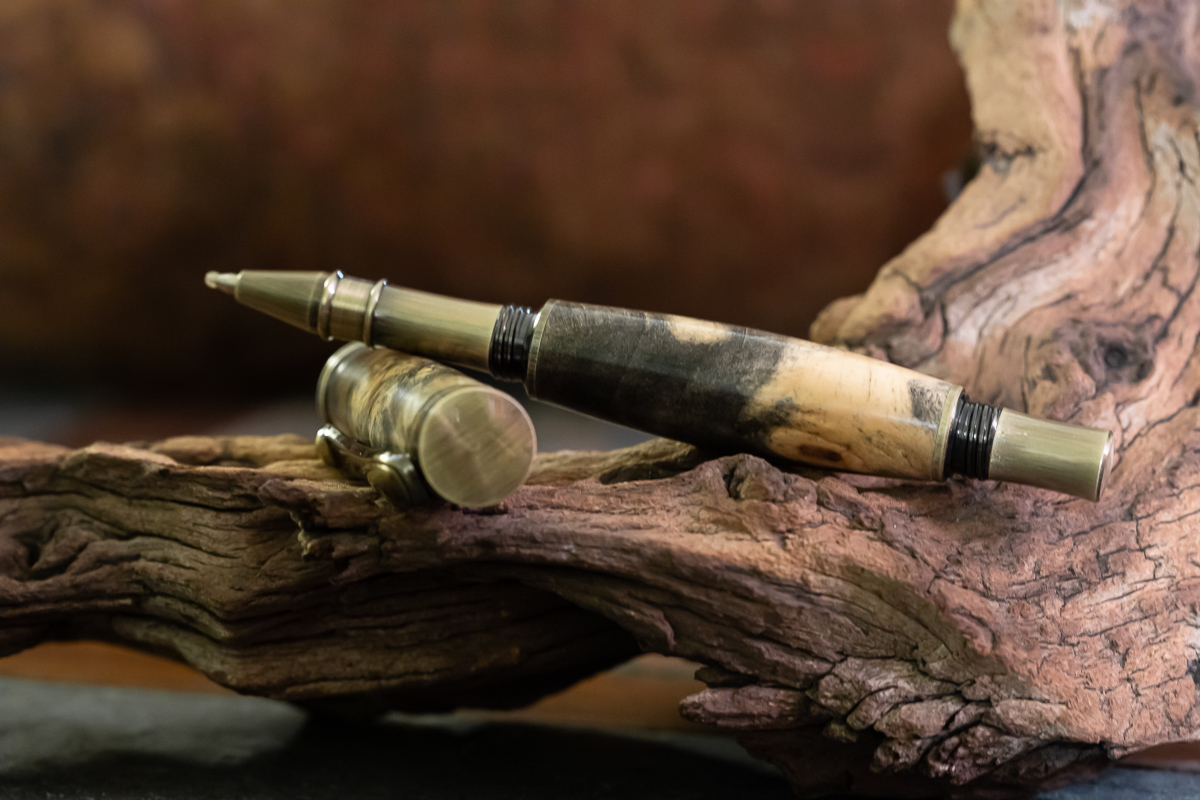

Antique Polished Brass Rollerball w/ Buckeye Burl

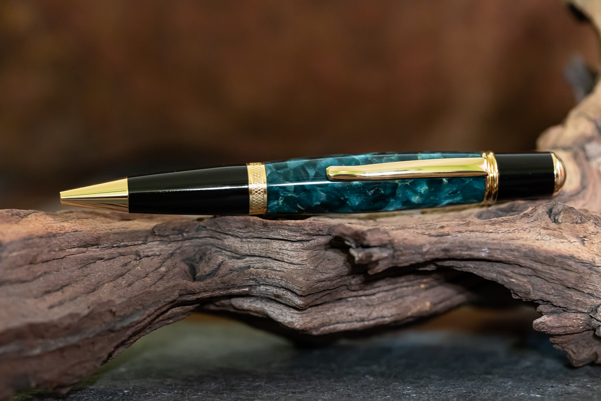

Wall Street III w/ Green Quarts Polyester

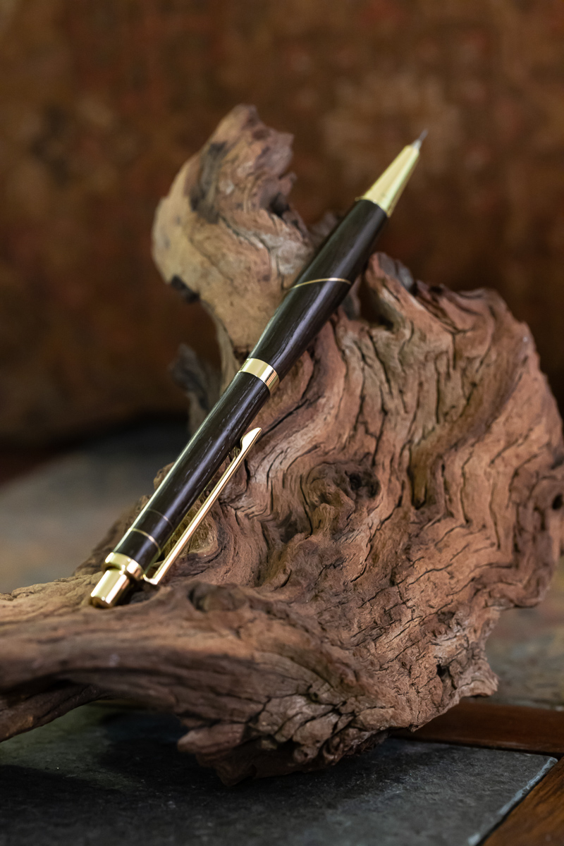

And tried something different with this one...something I haven't seen done before, and it took a few tries, but I really like how this came out and am going to be trying some more of this:
Slimline Pencil w/ Bog Oak and Custom Brass Accents

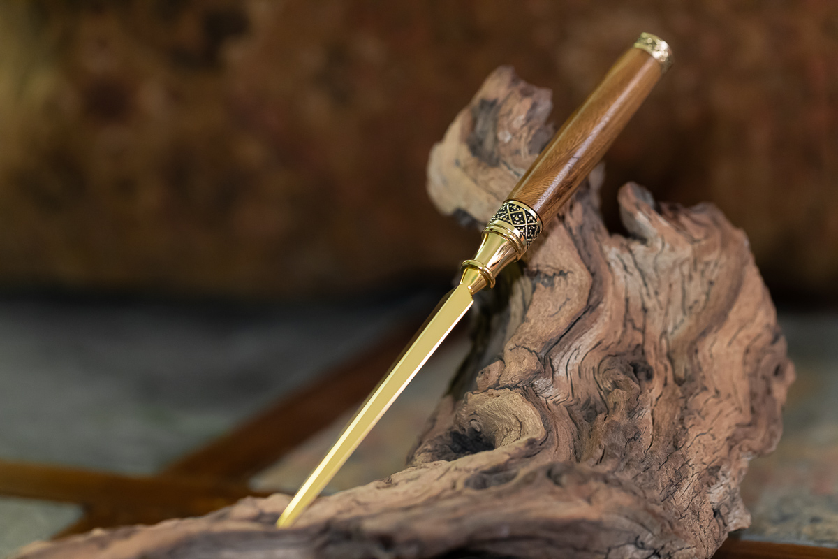

The letter opener is my second. I actually liked this kit, although I accidentally turned the blank a little wrong (sized incorrectly, but didn't realize until I'd finished it.) I kind of like the idea of turning a letter opener along with a pen, same kind of blanks, and selling as a set.
