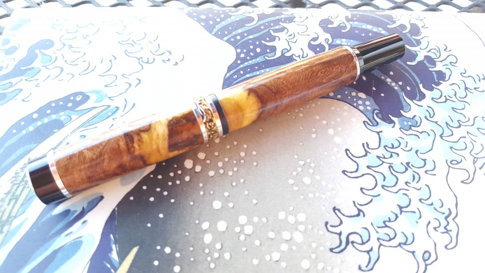

I have been turning pens for several years now with the component/ kits and have started a website.
I would like to start turning complete pens with a metal lathe. I am looking for advice on which lathe and tools to get. I would like to get one that I don't have to upgrade in a year.
What resources would you recommend?
You might set a budget, the one you wont have to upgrade in a year is subject to what else you will use it for. I recomend as a minimum 7 x 16 if its only going to be used occasionally for pen parts. If you want to step it up a notch the 8 x 16, 9x 20 and then the 12 x36. If you go with a 12x36 Either Grizzly or Precision Mathews you wont upgrade for a very very long time. You might find an Older American Made lathe like the Atlas/Craftsman, Logan, SouthBend Lathes but you should know what your looking at for wear and tear or know someone who can advise you. Since you asked what lathe I will take it you would need some advice and I would stay away from them. There are some great deals but you can easily buy an expensive boat anchor. I would not recomend the Taig, Unimat, or Sherline lathes for a beginner unless you find one really really cheap. There are people that really like the 11 x 28 Precision Mathews with the 1 1/2 inch spindle bore. Tooling will almost double the cost the lathe. Be prepared.
