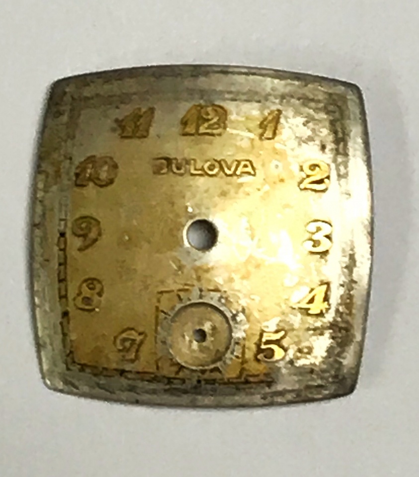

This is a watch face from my father's watch that he wore for years and years until it gave up the ghost. The finish has deteriorated around the edges. I want to make a heirloom pen featuring the face. The face is .87" by .87". Aside from myself, potential recipients are female. I am inclined to make the pen gender neutral.
Any suggestions as to an appropriate kit, finish and background color for the watch parts?

Neat watch face with family history. I like the worn look...and yes to the antique brass.
In the pic, it appears to be raised or domed...not flat. If so, it may not be a good candidate for bending around a pen blank.
Another thought would be to cast it into a pendant and keeping it as is.

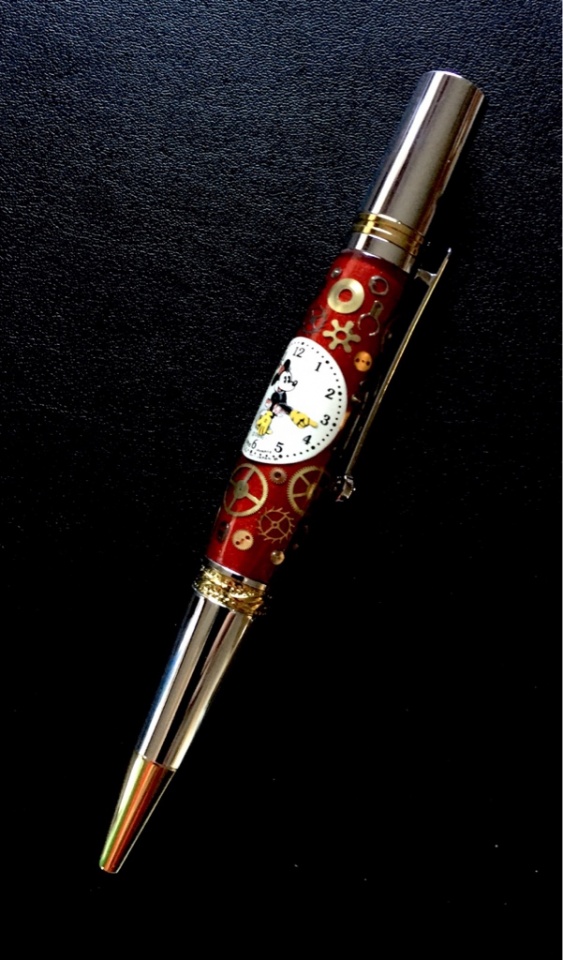

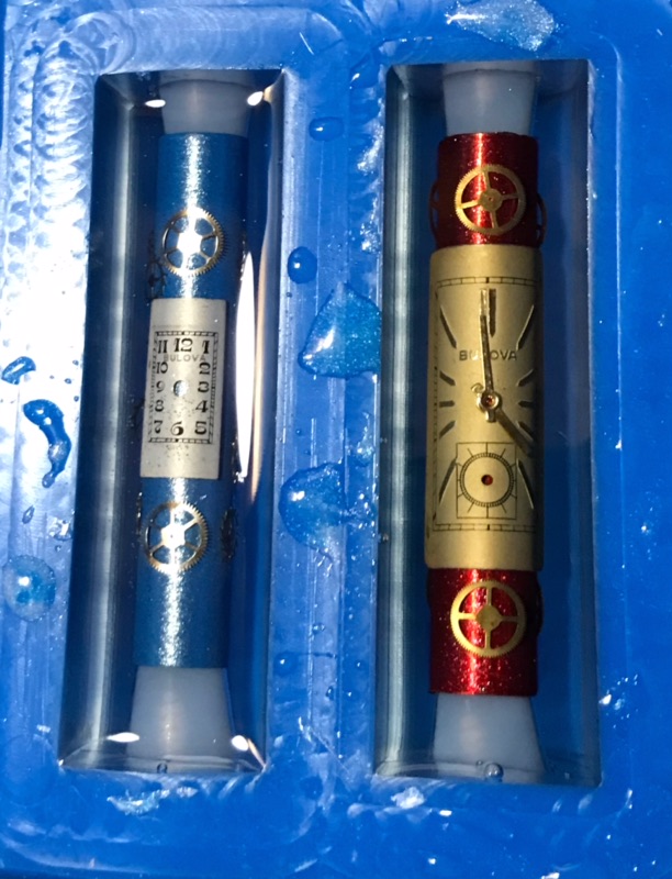

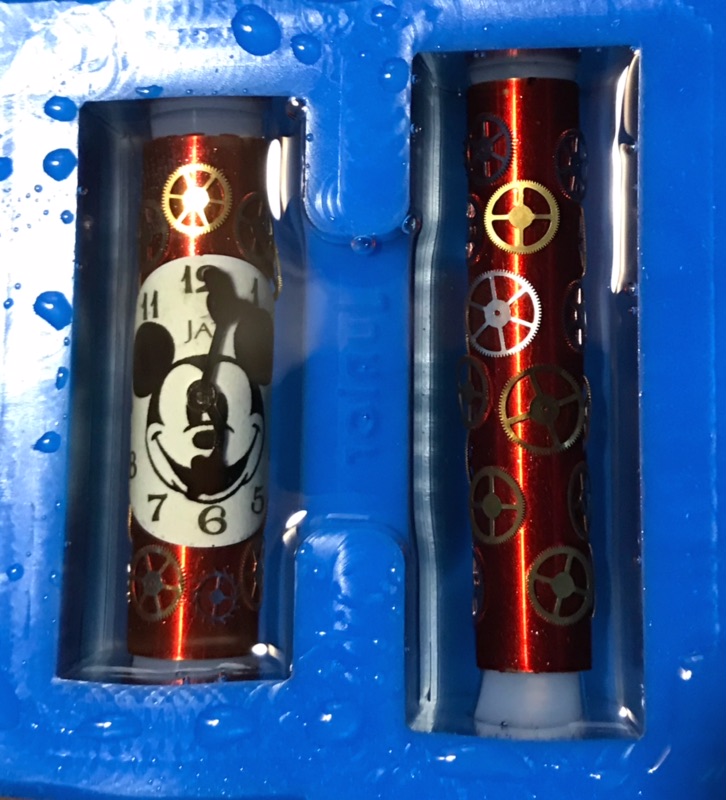

After playing around with watch parts and Majestic squire tubes, I think this the tube is just too small for this particular face. I did put together a couple using smaller faces and think they will be attractive pens. I will probably go with some jr. type of pen. I am also thinking a red powder coated background like the ones in the background of these blanks. JT, I appreciate the sentiment around the photo and will have to give more thought.

Just be careful with that red. It like's to chip! Even with a primer base coat

Those blanks you show, Cody, are extremely attractive.
Yes, on further thought, the Squire tube is indeed on the small side.
Keep on keeping us posted, Cody; this is very interesting !!
