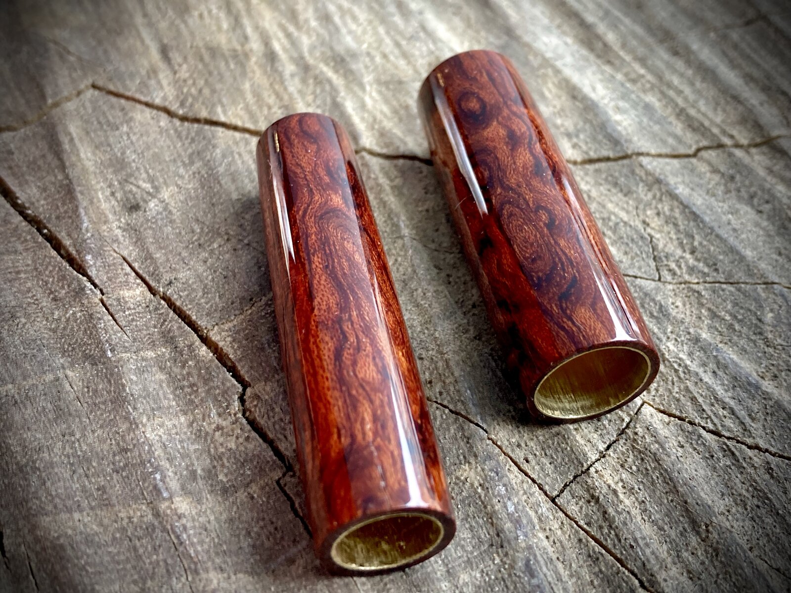

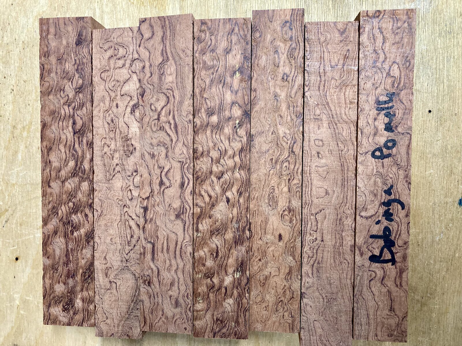

I bought a set of these Bubinga blanks that are amazing. Seller said they were pomelle. I never heard that word before.
Unfortunately, I managed to crack 2 of the three upon assembly. I've been spoiled using Berea and Dayacom kits. I forgot that with other kits I need to ream out the brass to slip-fit and then glue, which I did for the third.

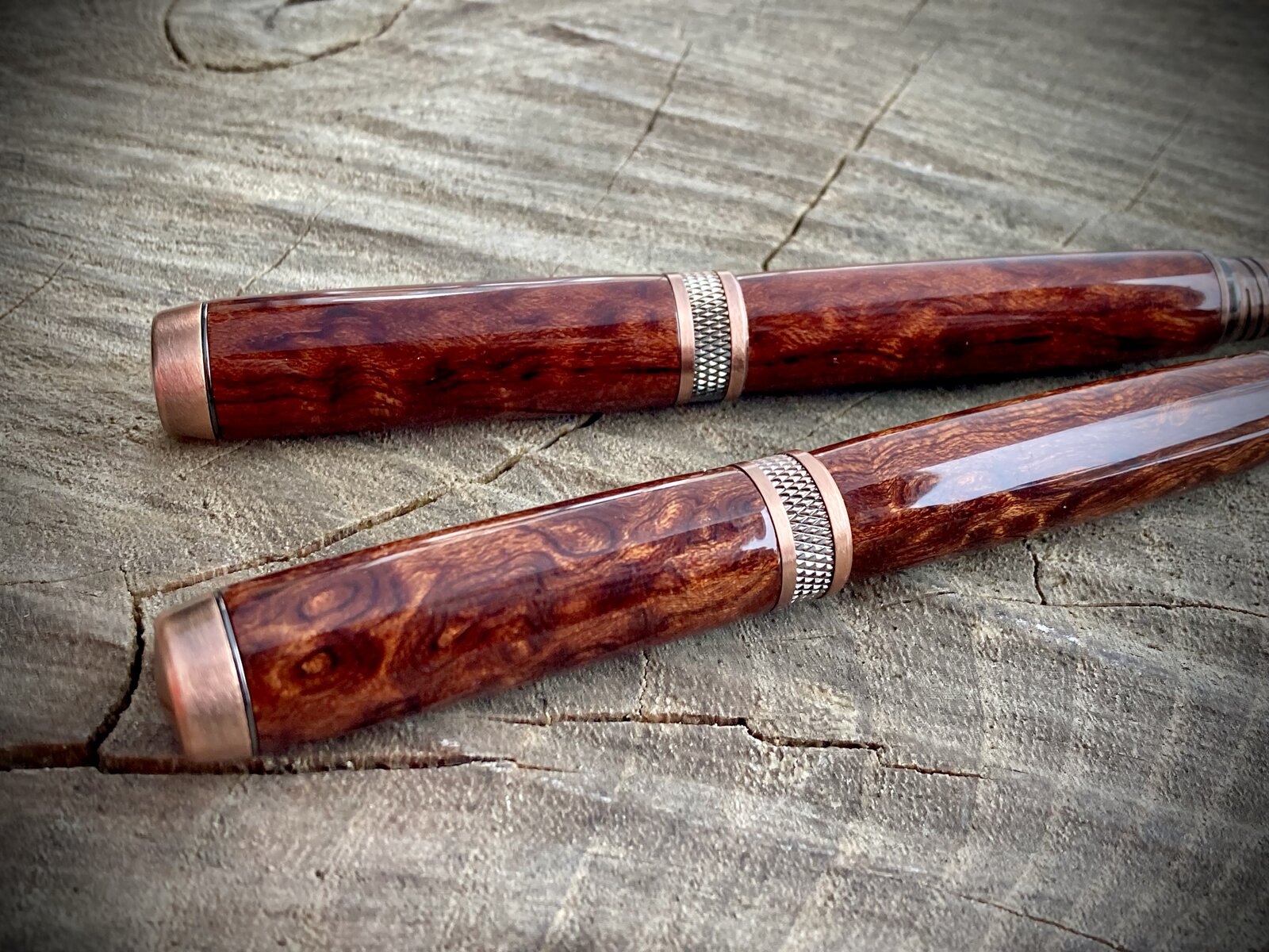

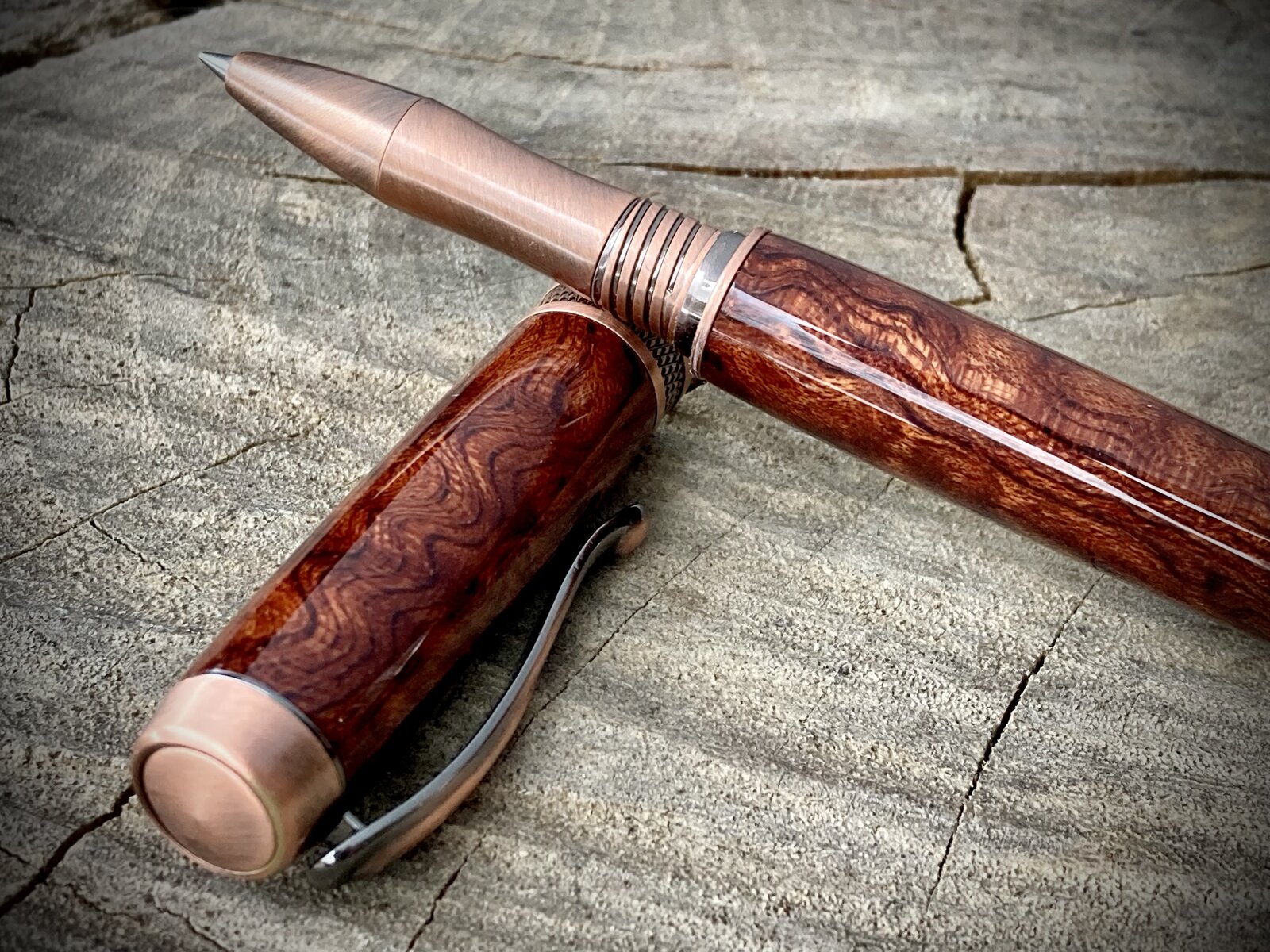

Holy cow that's just gorgeous. Is that your normal finish or did you do anything else to bring it out?

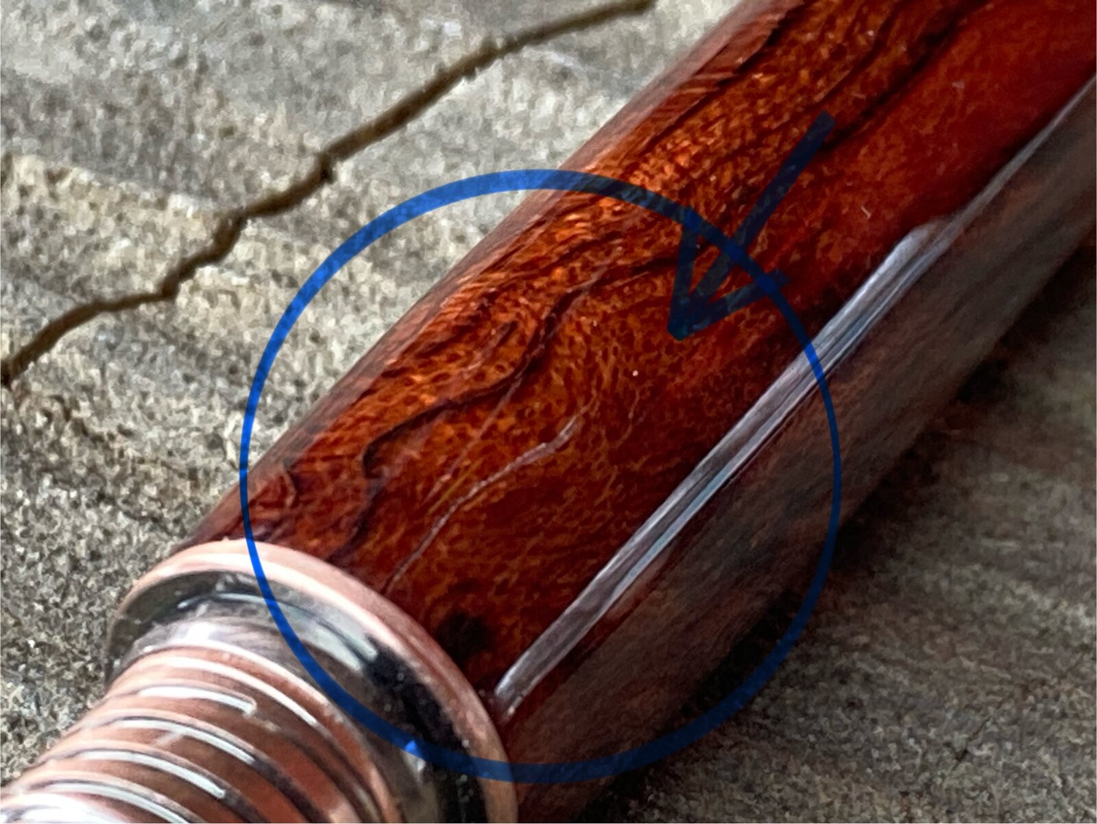

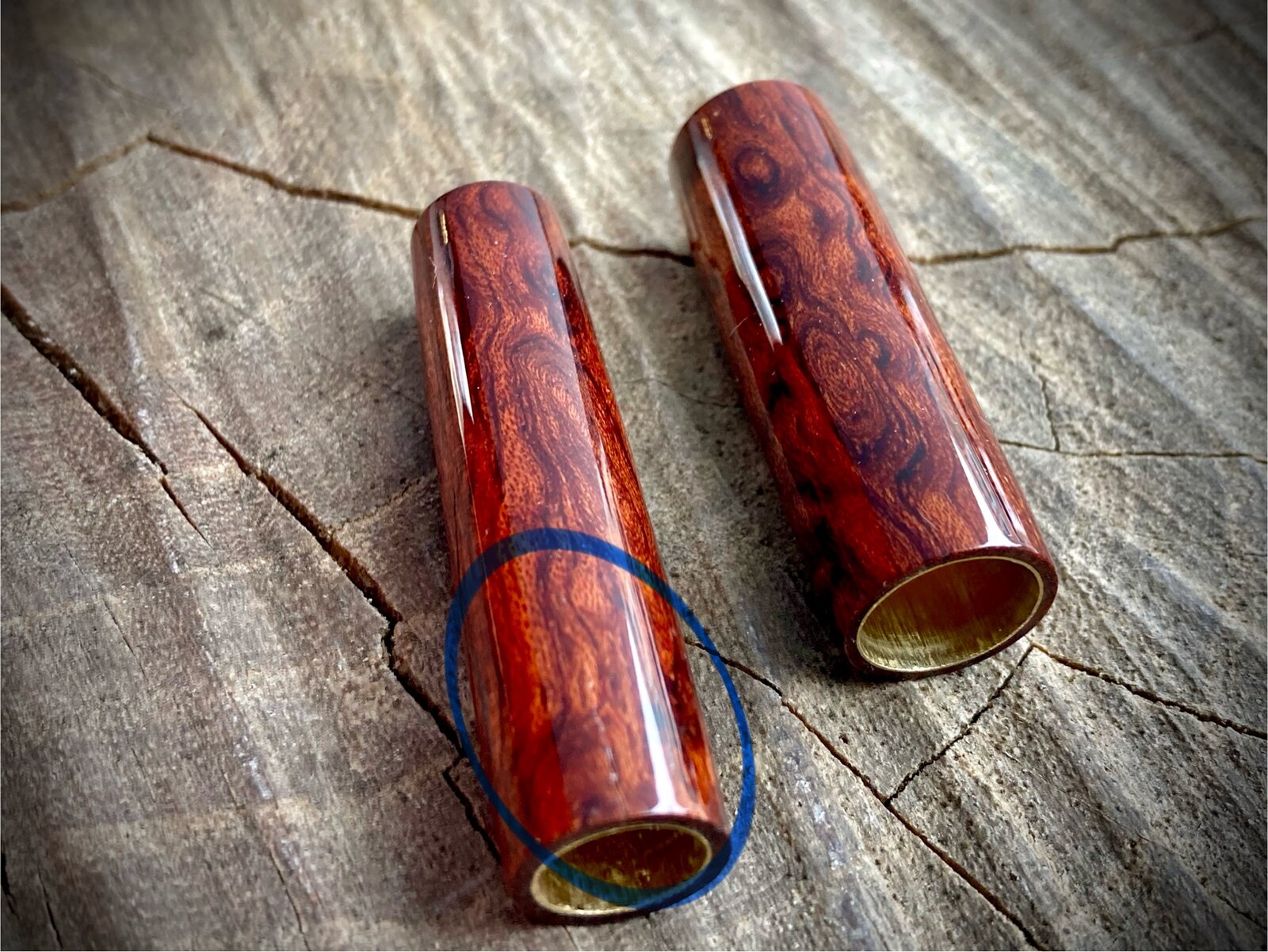

Would you mind posting a photo or two of the cracked blanks? If you don't want to post could you send via PM? Pretty sure I have some of these kits sitting in my shop right now.
The first one went together fine but the crack showed up this morning. The second cracked on the spot. The third I widened the brass tube and should be ok.
It's my standard finish, Gluboost thin and medium. +/-.005 mm.
The kit is Diamond Knurl. I believe it's an Exotic Blanks original. I like the kit. But the fit is on the tight side for wood pens.

Wow! That is some amazing wood. Beautiful job!!
I have had this happen before (cracks upon assembly) and have had good luck disassembling sanding, filling/fixing the cracks with CA and refinishing. Since you know where to look, you will be able to find the cracks, but otherwise they can be almost invisible.
Those blanks are amazing.

I might try to rescue these then. I fill voids and such often with CA. But I figured an end crack was the kiss of death because if I filled it, it would just grow longer over time. Several have said it works, so I'll try it and let you know.
