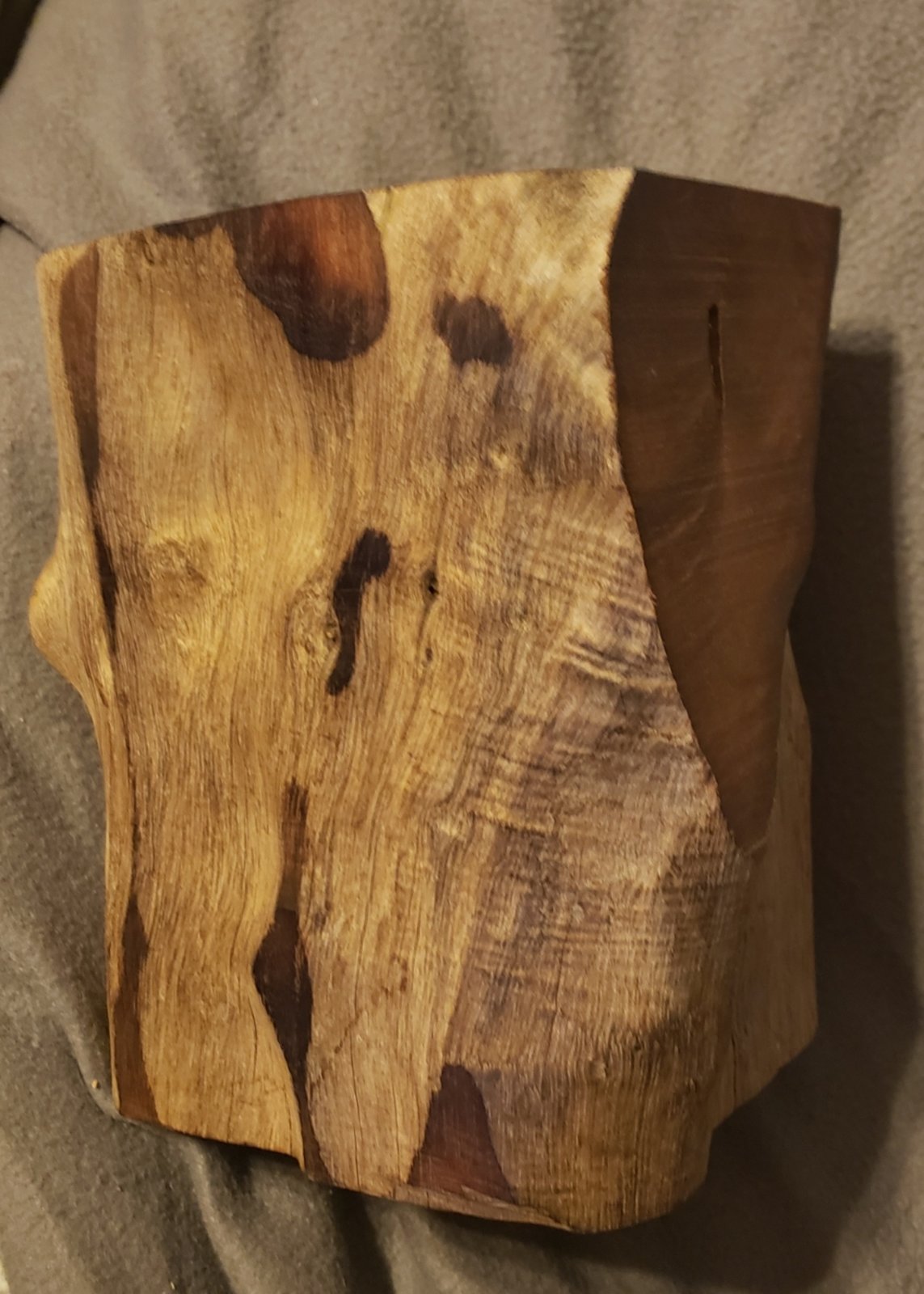

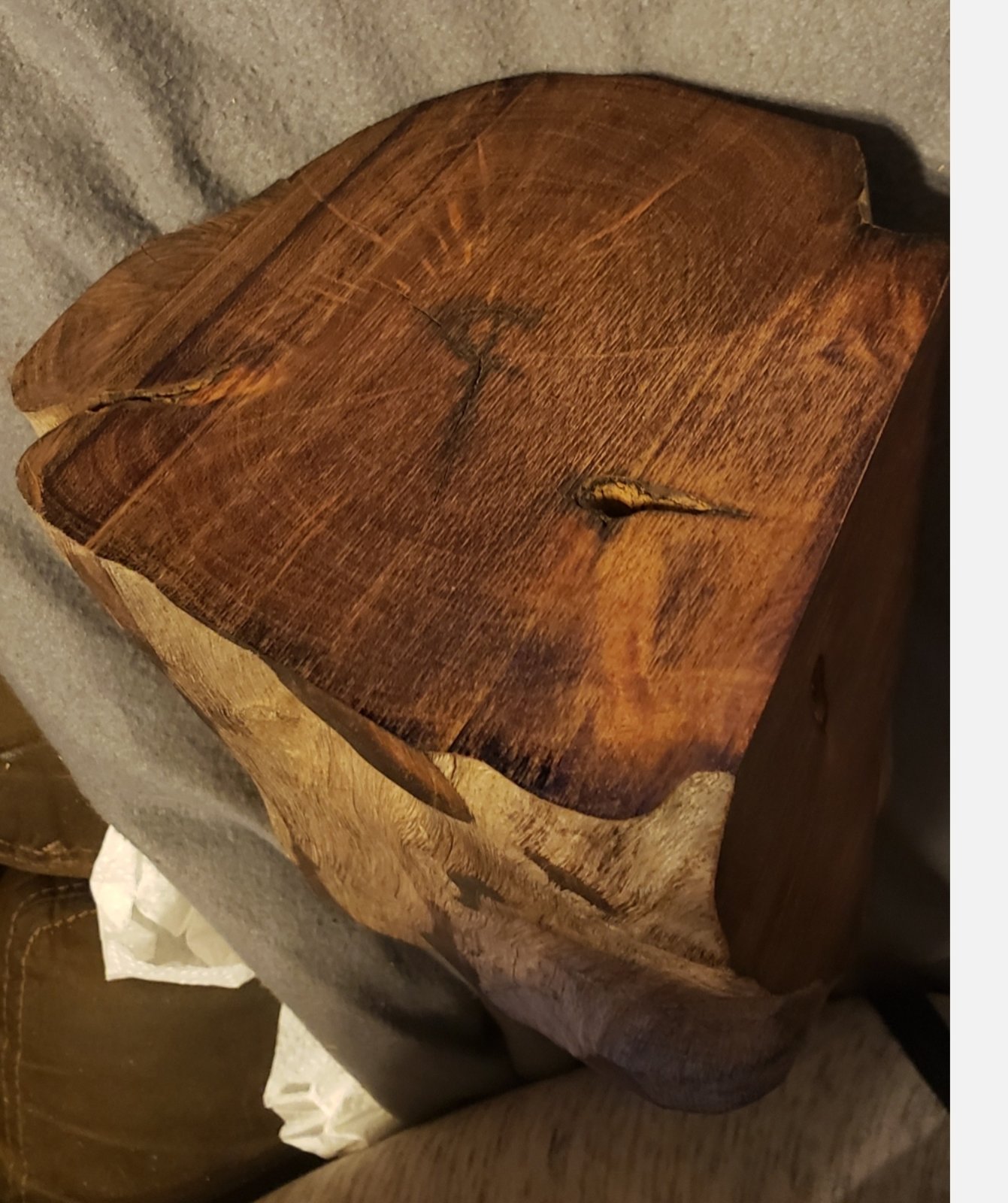

Here it is...

So a friend of mine sent me a 6x6x8 log of hawaiian ironwood that his neighbor had that was just sitting in his garage for the last 20 years. All I need to do is send him a pen. Which way yields the nicest possible pen blanks? Straight cutting or cross cutting? I've never worked with this, or any, ironwood before. Thanks!
With a 6x6x8 log like that, if you wonder how the cross-cut would look, simply slice a 22m thick off the log end, you may have to straighten it beforehand, after that you still have more than plenty to play with straight cut blanks, if you slice them in approx. 21/2mm thick boards and you want also to try the diagonal cut, on 1 of the boards, the one closest to 90mm wide, simply mark a 45° line at one end and then run in on the bandsaw or table saw at about 21mm, you will have enough for a few blanks cut diagonally but if you are concern they won't turn out good, leave the board as is after you got the 1 blank out of it, you can always slice it to 21mm straight cut.
