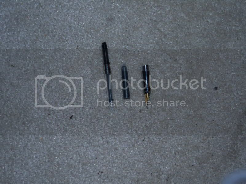

Im trying to put together a Jr. Gents II fountain pen and cant seem to figure out how to attach the ink catridge to the NIB. The pic below shows the pieces I must attach...anybody give me some help?? Im sure theres an obvious answer...

The clear piece is an ink pump - to fill from a bottle of ink. The ink filled cartridge is the other way to put ink in your pen. Push the narrow end of the cartridge into the back (hidden) end of the nib - push firmly enough to pierce the plastic.

so the clear piece does not actually go in the pen? Only the ink cartridge?

You can use either the pump (left) or the cartridge (middel part). But if it is made for sell, the owner of the pen should be the first to insert the full cartirge into the nib.
Specialy the pump can sometimes be inserted to softly - the pen does write, but it leaks the ink in the bad joint. I had a customers sometime ago that come back with the pen, complaining about the mess, but all it was, was a badly inserted pump.

ok....I was just curious about the spring in the cap?...I thought the pump went in the pen

The spring in the cap is used for the rollerball version of the pen. It pushes down on the rollerball cartridge. I would remove the spring if you are going to use either the FP cartrige or the pump, as it is not needed.
