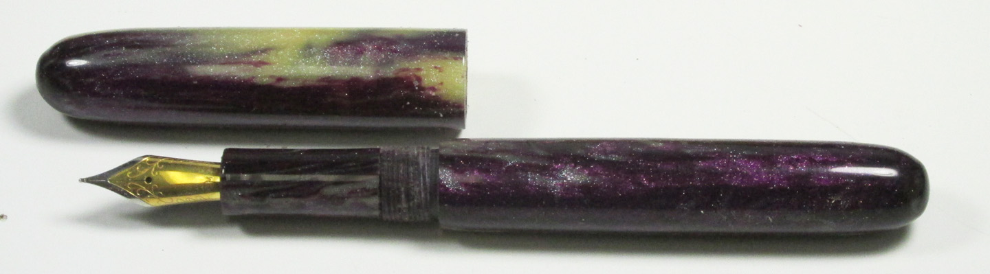

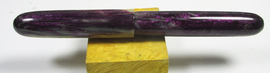

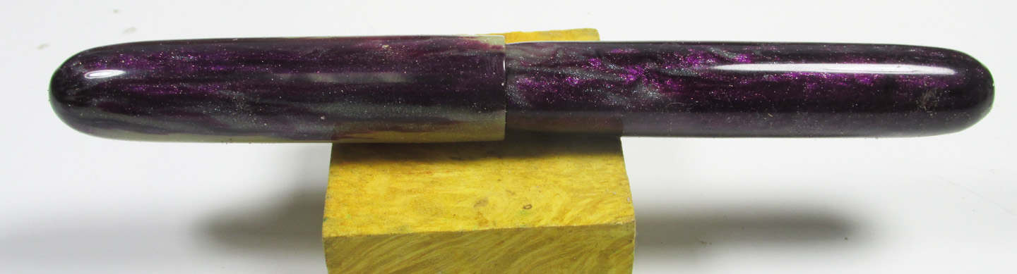

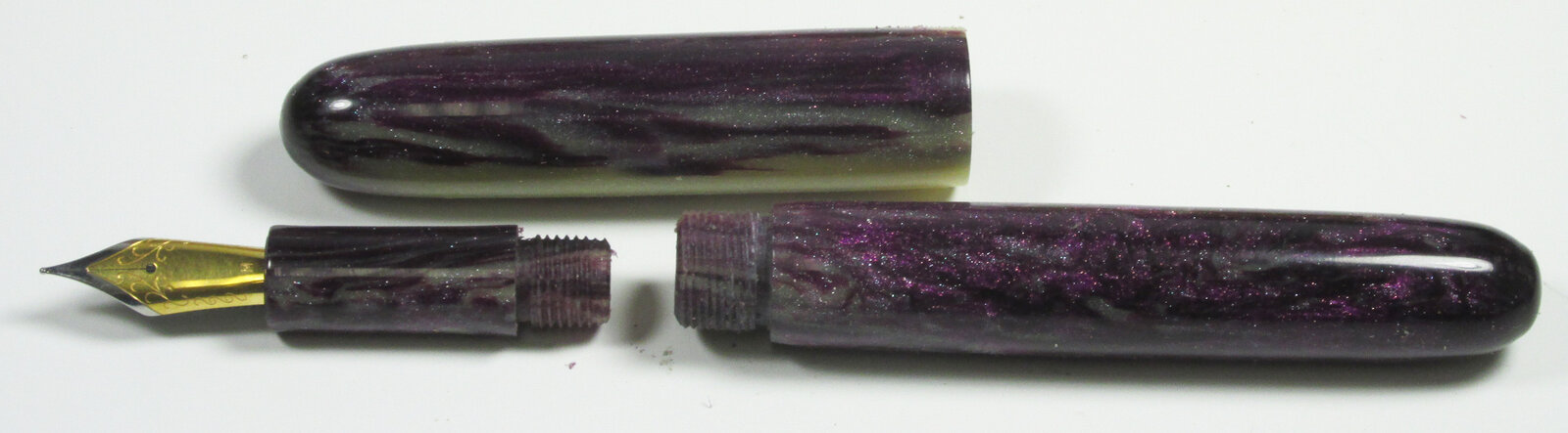

Here is my pen from yesterday. stated wed evening and completed yesterday. The blanks is a diamond cast from McKenzie Penworks. The threads are M13 x .8 triple lead for the cap and body. M10 x 1 single start for the section to body thread and M7.4 x .5 for the JoWo nib uint. Working on shape, lengths, and diameters to find what i like and find pleasing. Adding a clip is next.

Beautiful work !!!
I am not really rapt in the color mix of yellow with purple, but apart from that the overall look is pleasing.
Beautiful work !!!
Thanks
Beautiful work !!!
Thank you. I'm not a fan of the color. Like the purple but was somewhat disappointed with the yellow being uncovered. Not really sure I like the diamond dust either. I'll give it some time.
