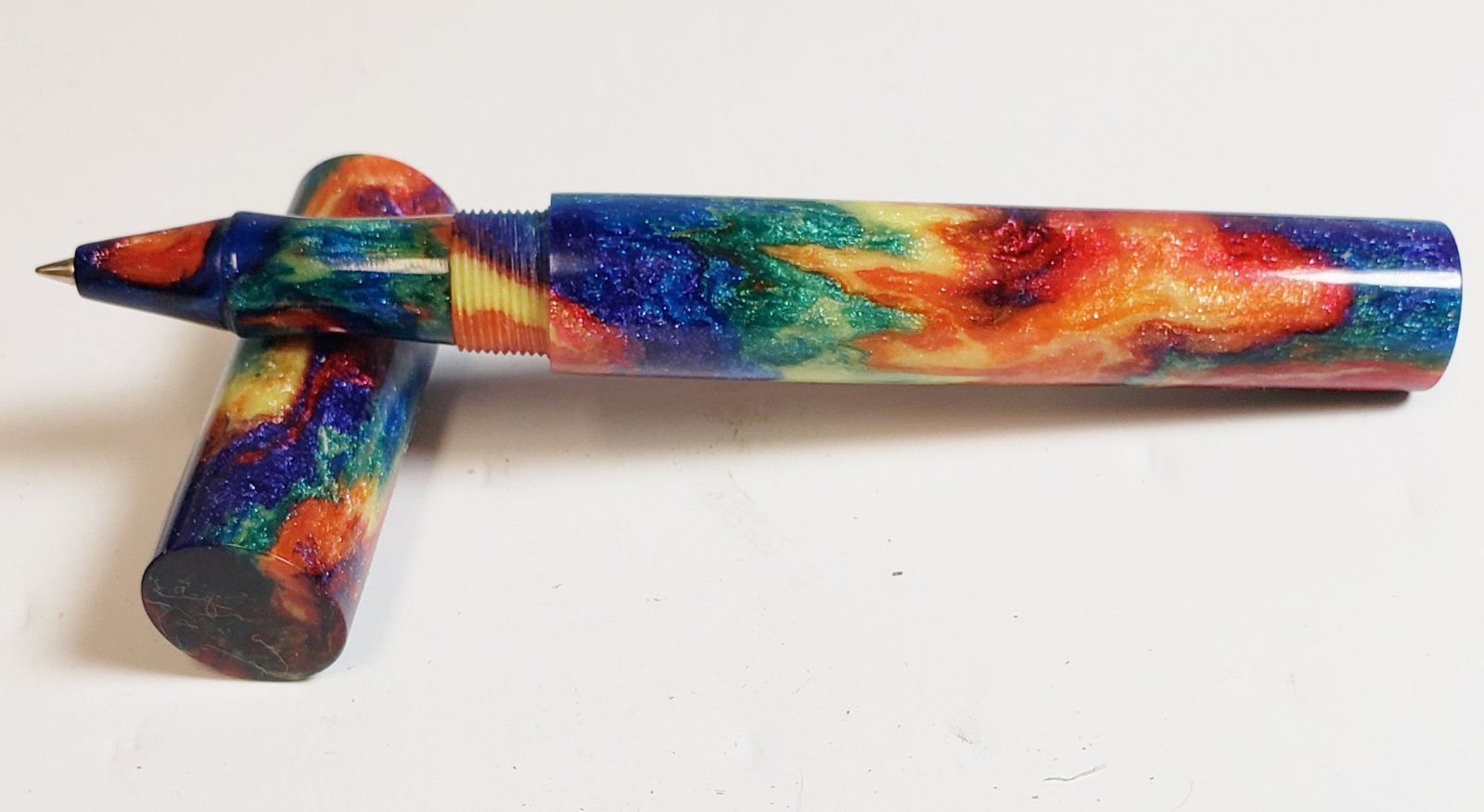

I spent a couple of hours this afternoon turning I made a start on my first kitless Rollerbal. The first attempt went OK until I started on the nib section and realized it needs to be longer than a fountain pen section to accept the refill.
So I parked that for a future Fountain pen build a shame because it is a nice piece of Ebonite.
So I started again with a new blank. I ripped the thread off the section because I got to cocky so I calmed down had a Coffee then went back to it. This time actually thinking about what I wanted to achieve instead of just diving in. So I have a cap I have a pen body and I have a section all cut to lentgh all tapped and threaded I just need to shape the pen do some drilling depth wise and polish it. I will post the pictures when its done. I am hoping to have it finnished by Wednesday so i can take it to and display on wednesday at my local Woodturners Club.
I nearly had a kitless rollerball all went well until I started off finishing the cap. The cap blank blew up. Maybe next time.

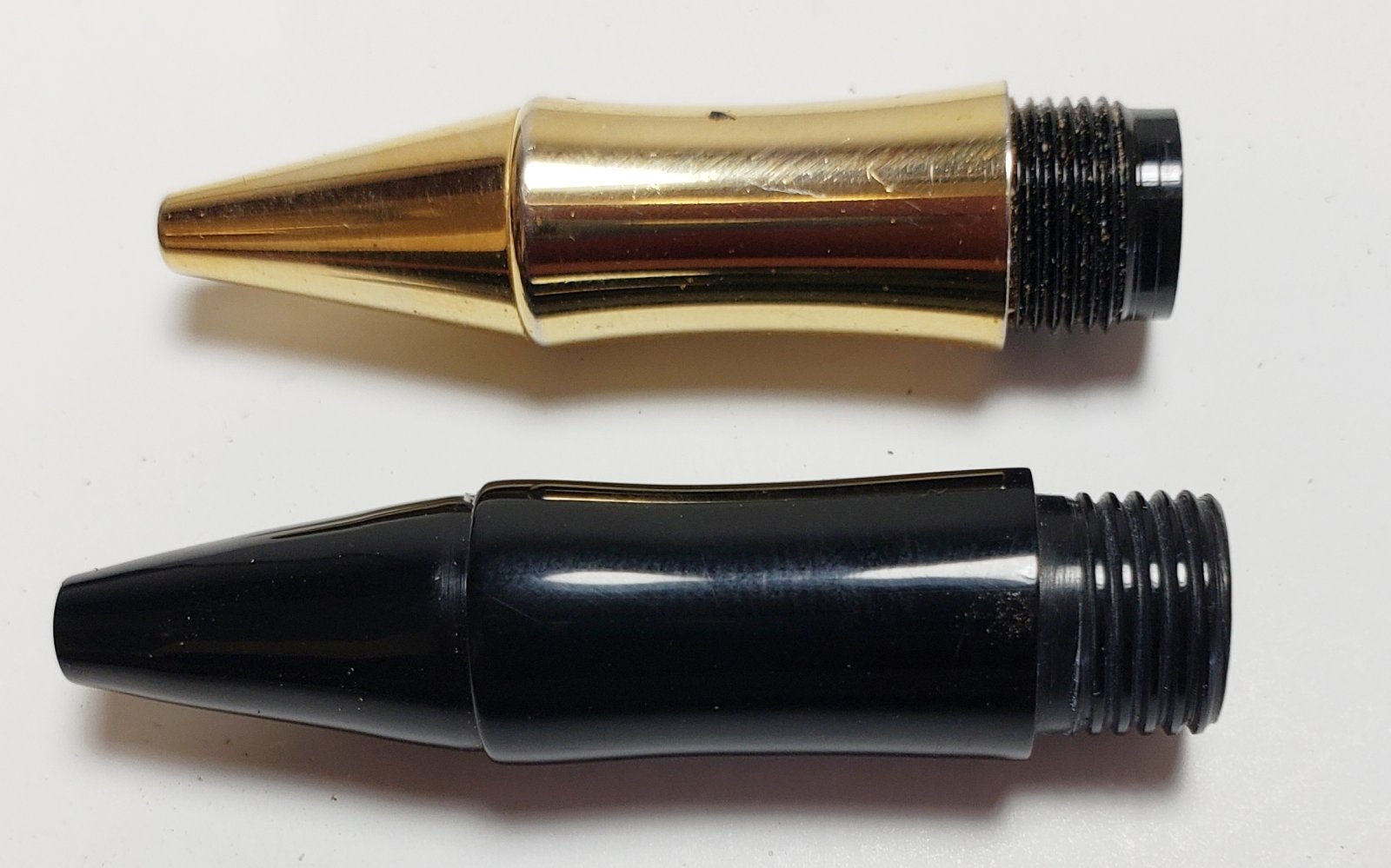

I bought a few of these but haven't made any pens with them yet:
I like that you aren't married to a specific rollerball refill and you can use whatever ink you want (as long as it plays nice with a rollerball). It should also make building the pen easier, you make it exactly like a fountain pen.
The downsides I see are:
1) You have to remove the converter from the pen to fill it, which might be awkward.
2) Eventually the rollerball might wear out and need replacing. With a refill, you get the ink and a brand new rollerball. These aren't expensive, so replacing them when they wear out isn't a big deal, unless they stop making them. So I figured after I figure out if I really like them I will just buy a whole bunch of them. They are only $2.50 for black and $5 for metallic.
