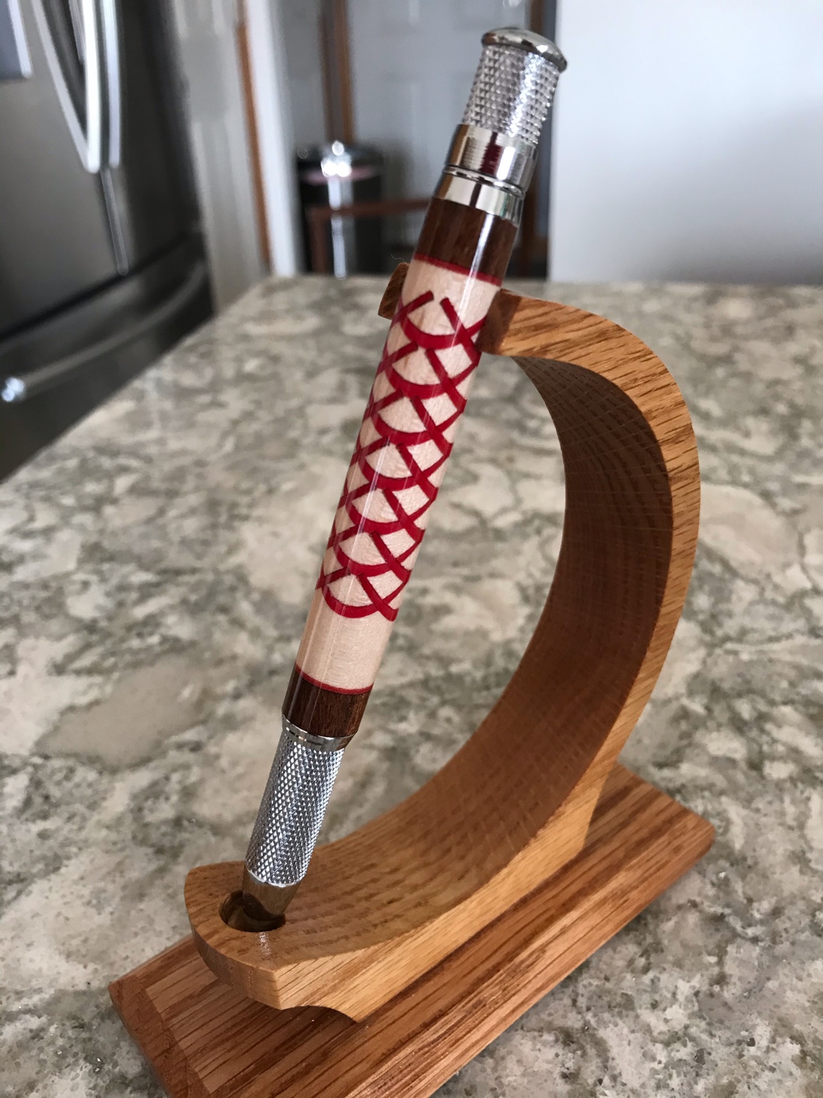

Mark, that second picture, what is that?

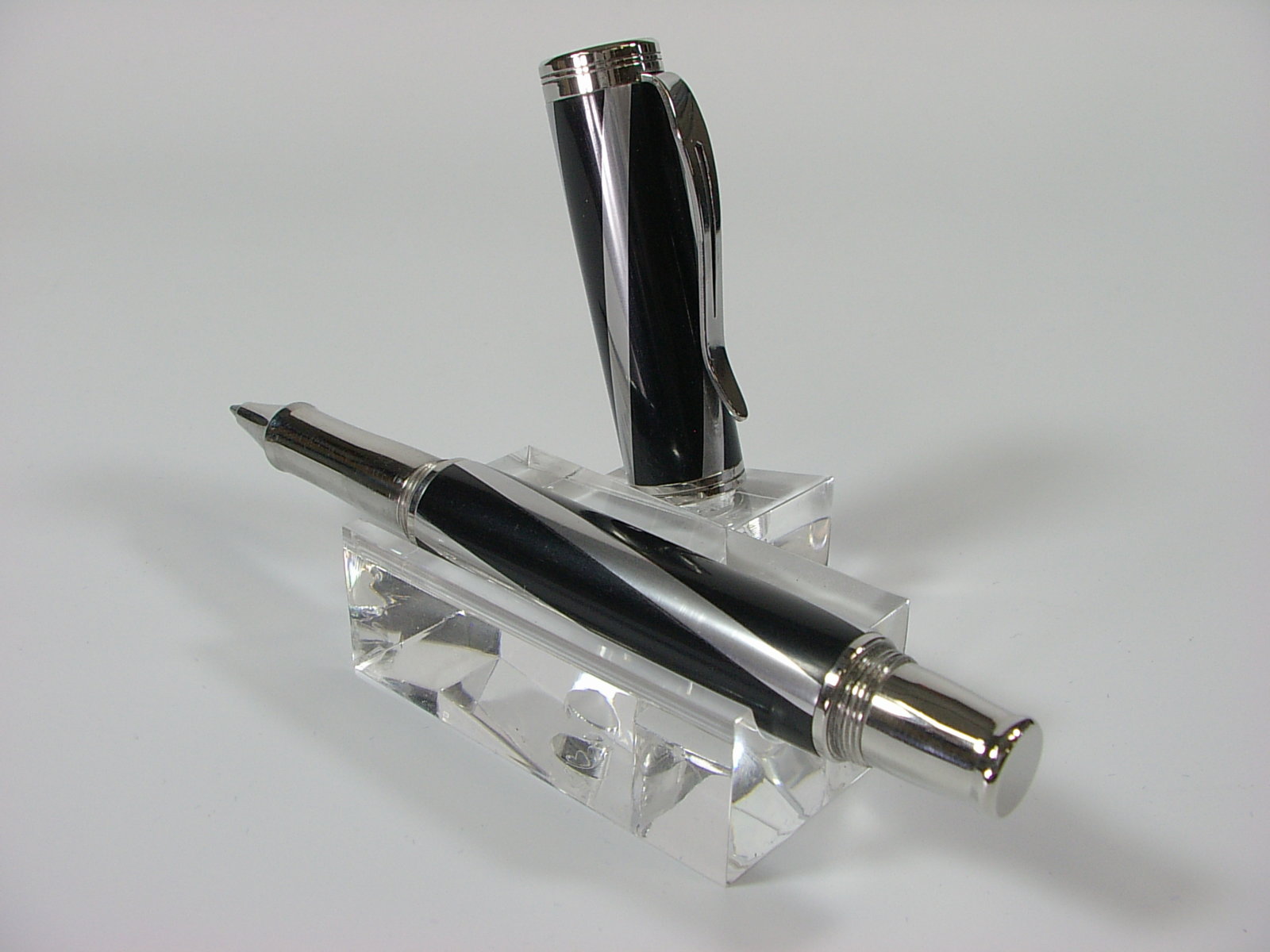

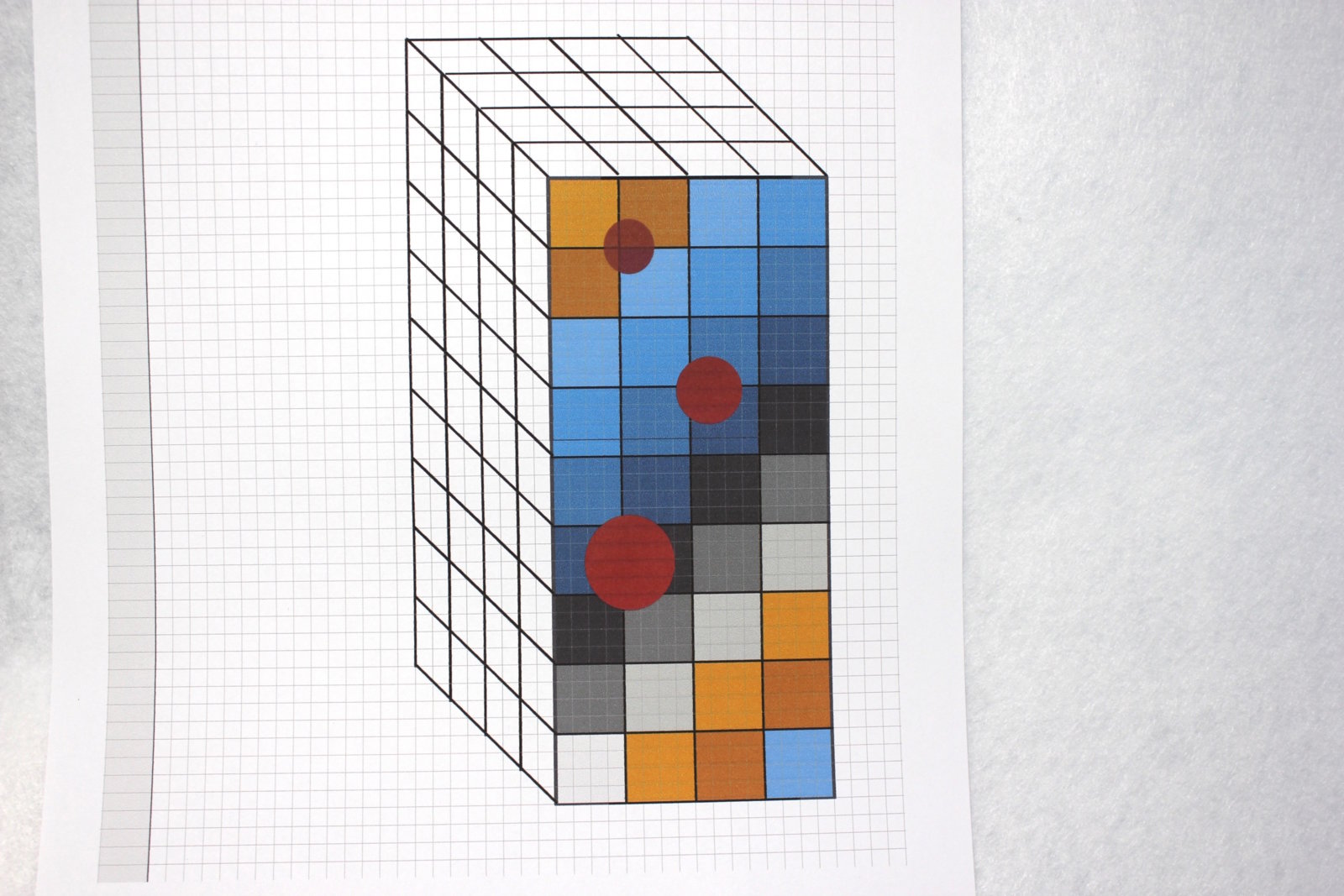

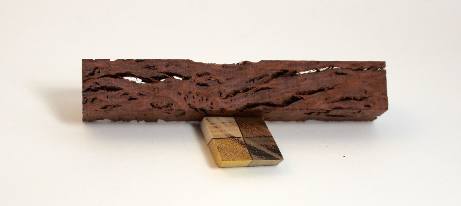

Jarrah Burl. My wife swiped it and we still have it. The finish is not especially good, but it is interesting visually, and I do remember it being "fussy." I basically encased it with popsicle sticks, gauze and CA before drilling. Then glued in the tube, turned close, glued in the turquoise sand and etc. I did use CA liberally at all stages.
The last blank that splattered; I wanted to turn a bit off, then cut into slices and then rotate the slices for this kind of a pattern: "Rubic's Cubix with dots". I actually believed it was poor tool control that doomed it. I had spent a lot of time to size the color dimensions that when I eventually cut the slices, they would be close to square after turning it down to bushing size. The dots were another pipe dream element. Alas, it was a dust pan/shop vac finale. Feel free to give it a shot.

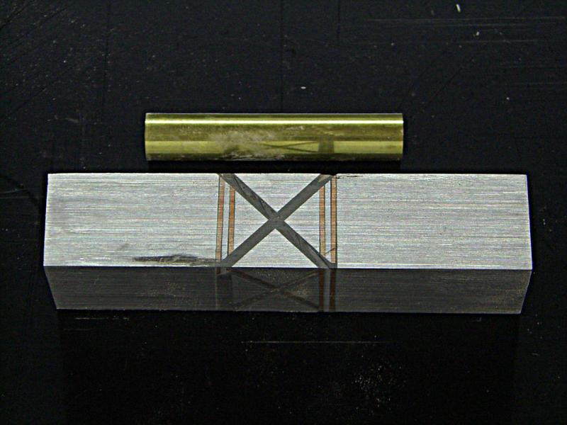

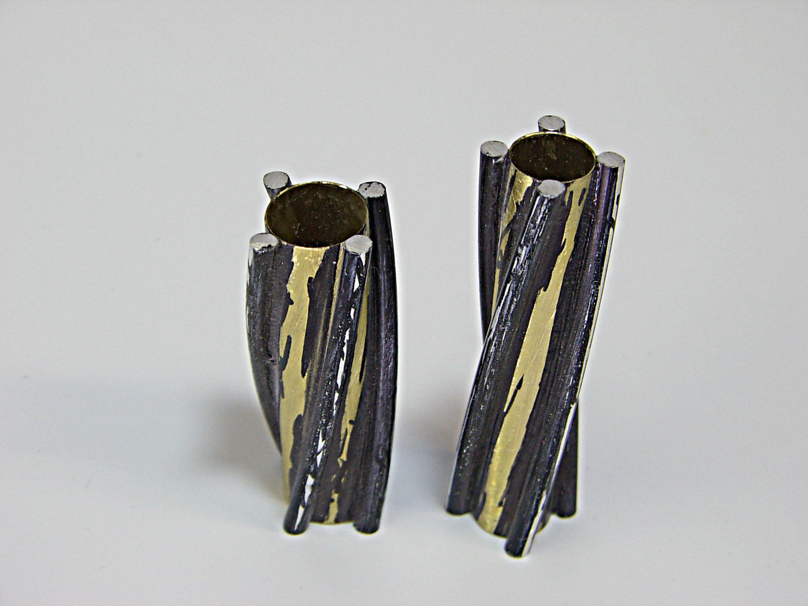

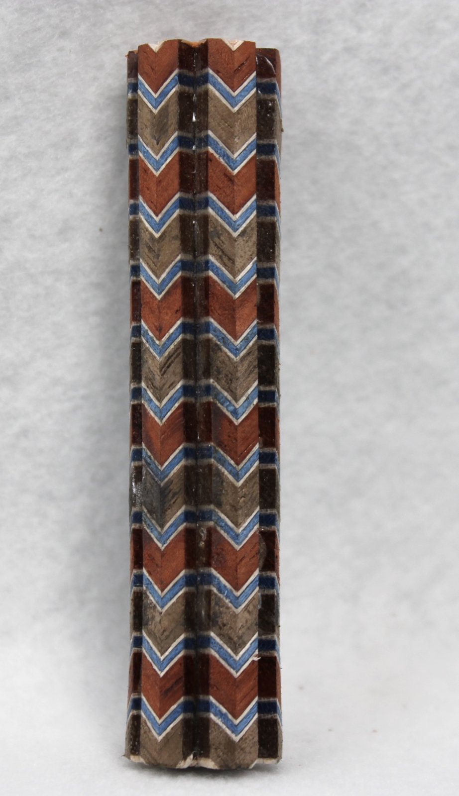

I had a few over the years and still have one I made at least 10 years ago and still have not turned it. It is a celtic knot in aluminum and brass. Could not find the photo but I know I have shown it here before.
Here is one I knew was going to give me a problem when I made it and the third time was a success. Learned from the other two failures and will someday revisit it because I should have done something different.
Got the photo. This is the one that I know will fight back. Have not really figured out what I want to truely do with it.

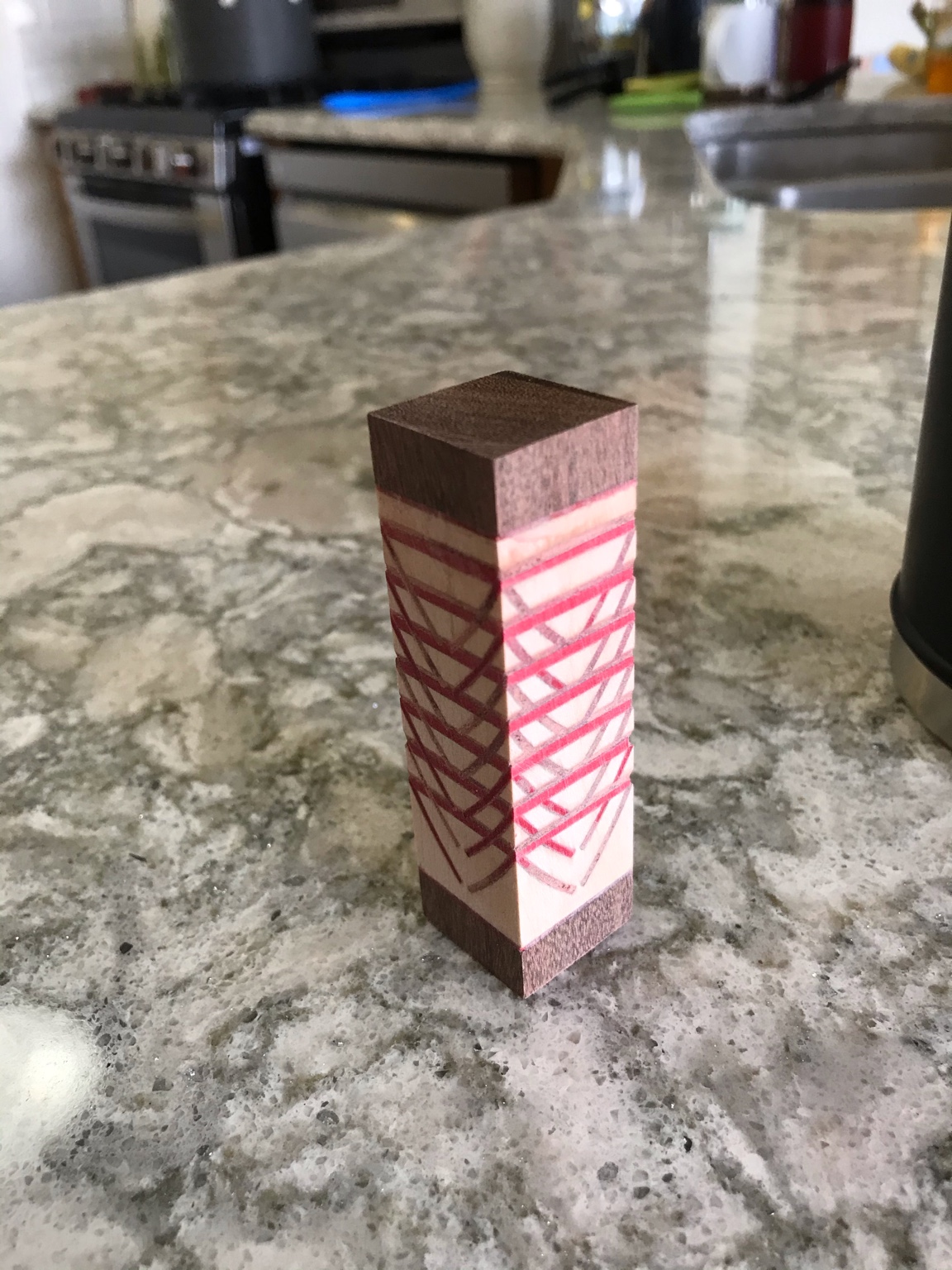

Well I decided to buckle in and give it a try. Had a small tear out within the first minute and thought " here we go", but I held my tongue just right and here's the result. I'll say right off the bat, it's not my favorite design, but it's not too bad. I would have liked the design to be a little better centered. As you know, designs can move some when you are turning it down. Extremely hard to know where they will end up.

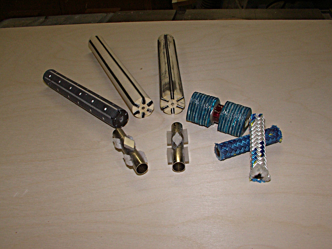

All depends on the design. Many of my blanks are done in the round and I segment with a router and the lathe. Drill holes using a collet chuck and a pointed live center to line things up. The center points are already there from the making of the blank round. When building on a tube then drill holes in pieces and build that way keeping things straight and true. Any slanting of the build will show. This can happen when the holes are slightly larger than the tube. when doing scallops and knots then square is the key and keeping that squareness helps. Here is a couple examples. The 3 top left all have center holes when rounding the blank. With the blank rounded and trued to same size entire length I can drill the ends for tubes as mentioned and cut off the length I need using my sled on tablesaw. The guitar pick blank was built in a jig that held all picks 90 degrees to tube.
