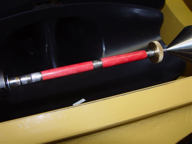

I love to turn pink ivory; it cuts like butter with sharp tools. If you get a really pink piece, not brownish, it will look rather translucent...really beautiful stuff. Here is the last one turned before finishing, and likewise this one was a slimline, a must in pink. A real shame the allowable resolution is so low for this forum....the high res pic shows the texture.
