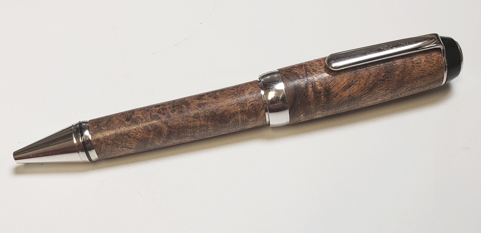

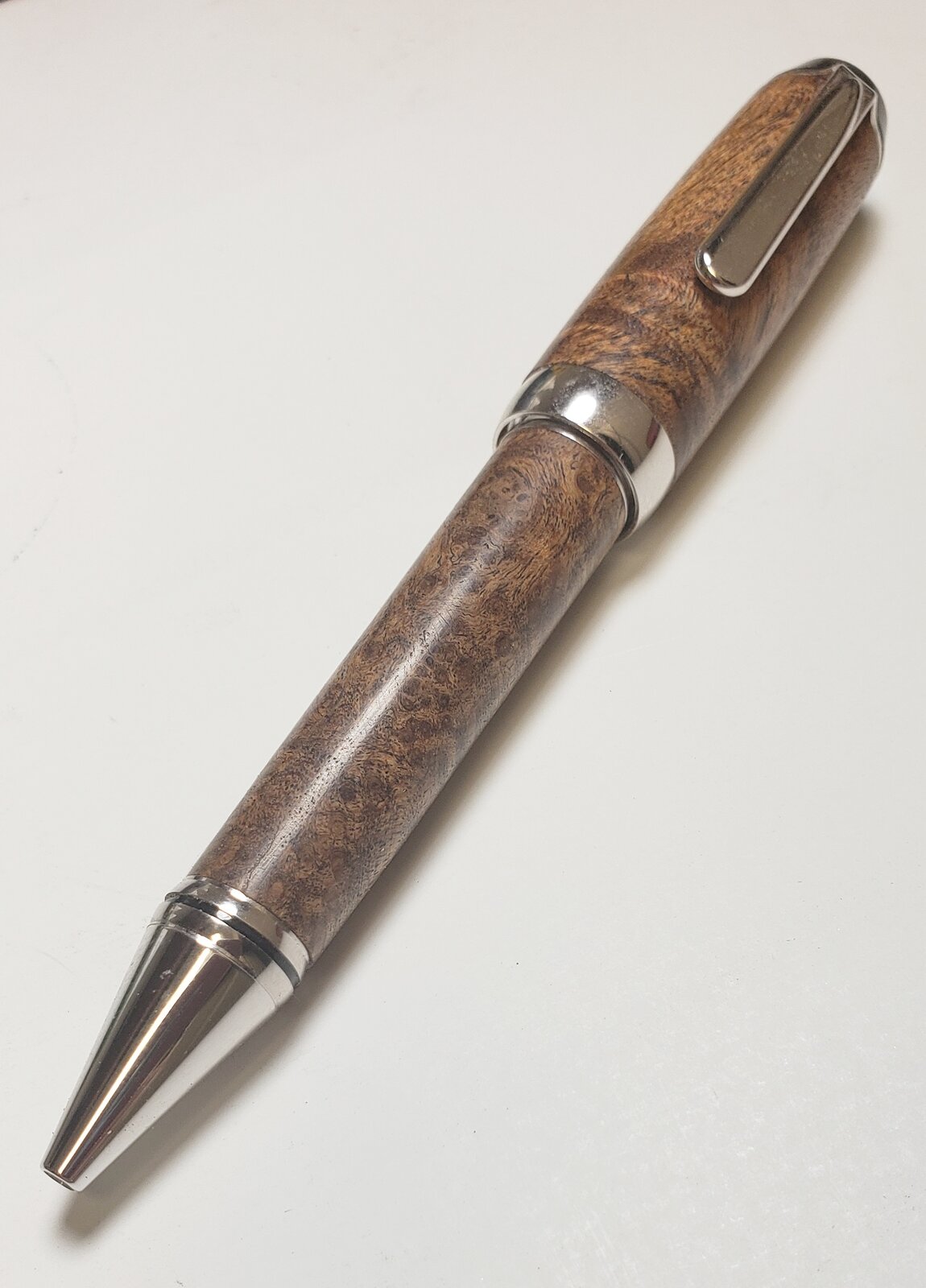

Another Havana ballpoint from the kits I found awhile back. I have two more kits but the tubes are missing. These kits have not been available for several years now. I'll take two sets if anyone happens to have any. The wood is mesquite burl.
