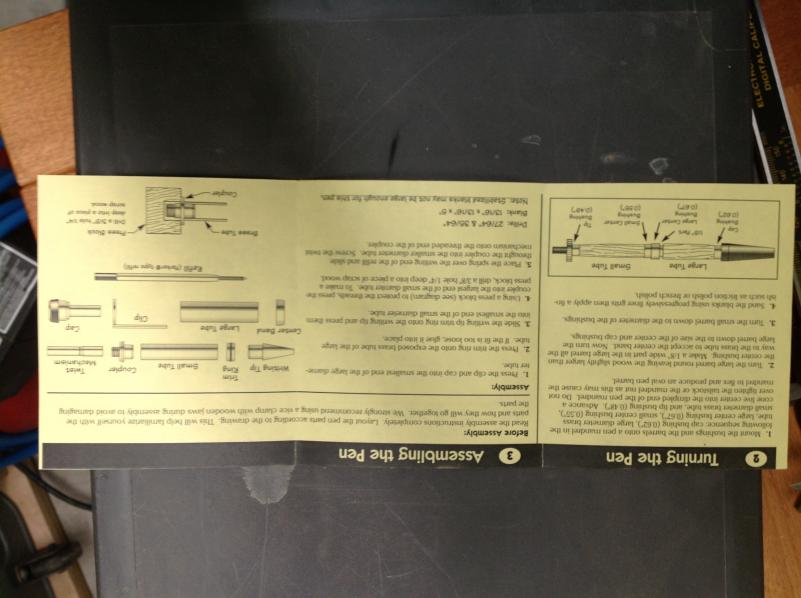

Your in luck. I love the Havana line those were one of my favorites, specially the little Havana . Here it is the instruction.
Enjoy turning them
Sorry about the picture being upside down. I case you can't see the dimensions well.
large (fat) tube, cap side (left side) .62 center .67 (from the right side you need to part off 1/8" all the way down to the tube) small (thinner) tube. Center bushing .55 and tip bushing is .48
If you need a better picture let me know.
