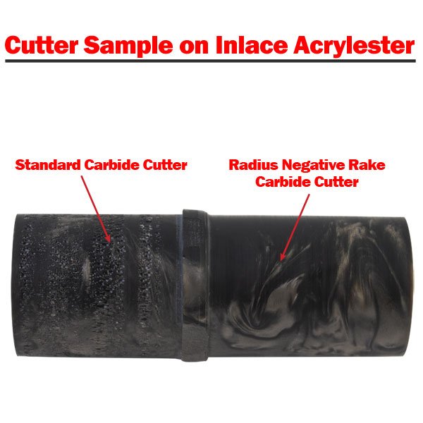

Sincerely they are as advertised. It is hard to review this product because it is subjective and a feel, but I can assure you they make cutting acrylic very, very easy. If you are challenged by acrylic then seriously - these tools are for you. They are not a scraper they are a negative rake cutter. During the demo I asked someone who has never turned before to come up and try them (of course, after signing a waiver), and within a few minutes he was streaming ribbons. Not cutting creators of the moon in the blank – literally ribbons. For wood I would use the traditional Easy Wood cutters – designed for that. The negative rake limits catches and is easy to control. If you use the finisher (round cutter), you have control in all directions – into the blank and across the blank. You will "peal" cut in both directions. The rougher (square or rounded square) is very well equipped to round the blank quickly. I have used both personally and they will be in my stable of tools. You can also use them to complement the traditional Easy Wood cutters and to get a perfect end – no chip out or under cut. Simply angle the tool to find the bushings and roll back into the blank (a technique I demo frequently).
Overall:
They are for real and are as easy to use as advertised. They fit the current handles or if you already own a set of tools you simply need the cutters. All American-Made. If you are looking to just start I would suggest the finisher (round) cutting head.

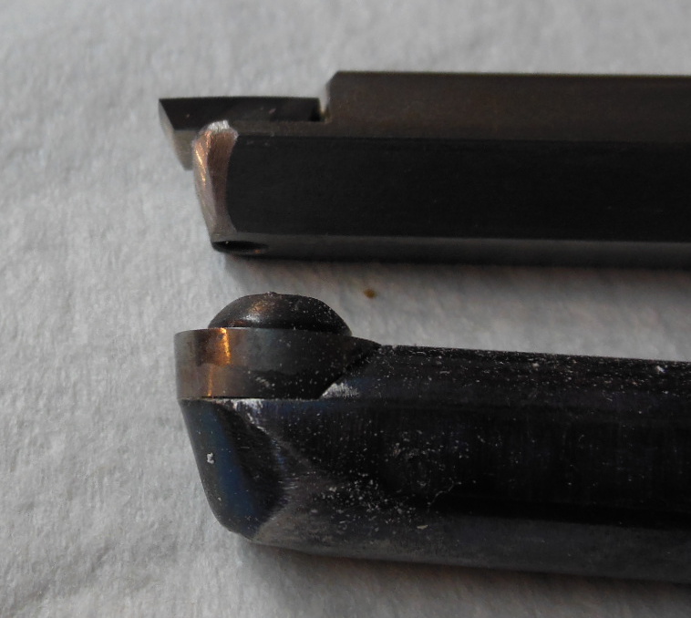

While i may try the EWT negative rake scraper (NRS), I don't really need it. The only two important issues with cutting tools are the angle of the tool cutting surface relative to the blank, and the angle made by the front supporting face and the cutting surface.
I have these two tools that take care of my turning blanks. The upper one with the more sharp angle will chip on acrylic blanks, but the lower one used below center peels off endless ribbons on the most chippy acrylics and hardest Trustones. For wood, I commonly use a flat grind skew to finish.

I've been using them for the past week. My biggest problem has always been inlace acrylester blanks.
Skill background: I have been turning about 7 months and am still working on my skills. I have about 300 pens under my belt. It has gotten to the point where I stopped buying the inlace acrylester blanks as a lot were just exploding on me due to my tools or my lack of skill.
With the negative rake tool, I have found it much easier to turn those types of blanks. No blowouts this past week. I turn 2 - 3 pens per night and have been concentrating on the acrylester this week.
I will be purchasing more bits on my next order. I feel like a closed door has been opened again.

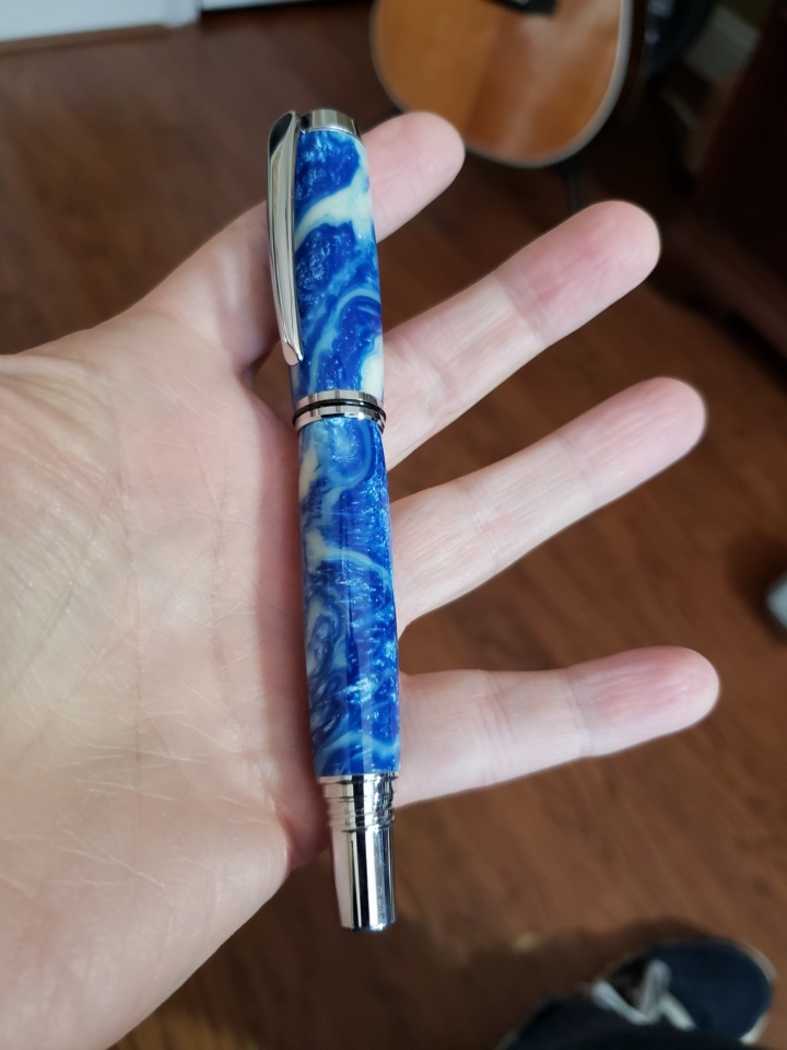

Acrylester was my motivation for turning with HSS. Anyway, it can be turned, is a great way. I love the stuff. This is my work/desk pen.
