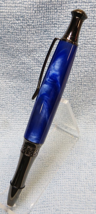

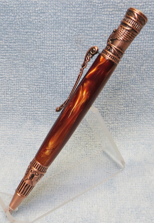

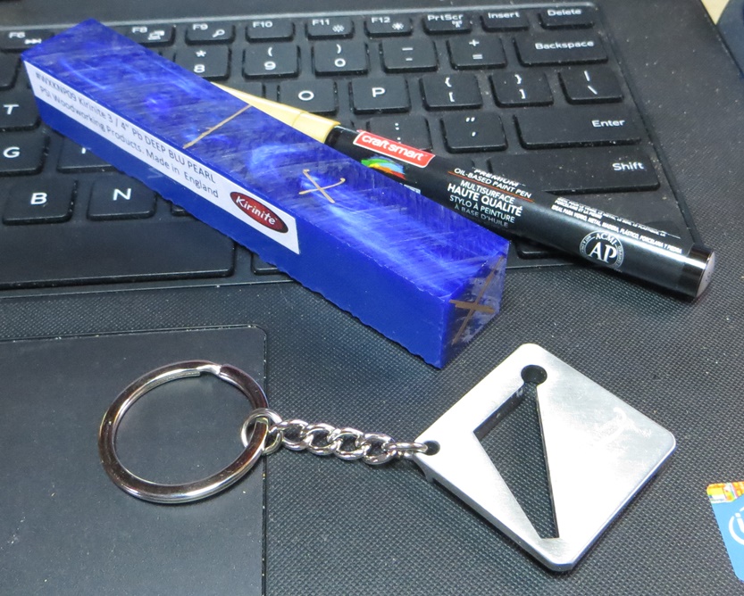

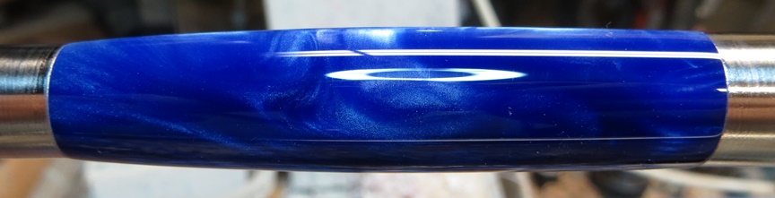

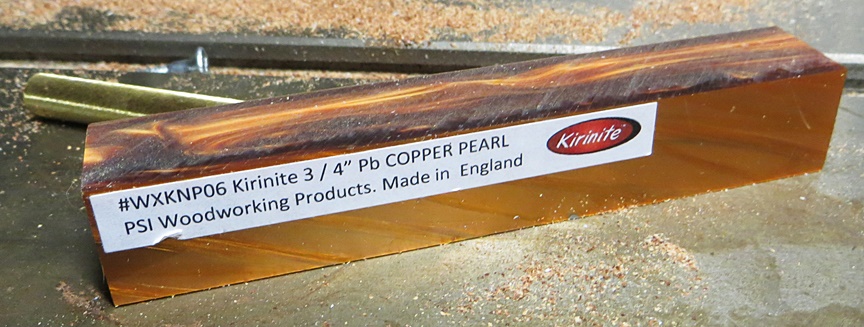

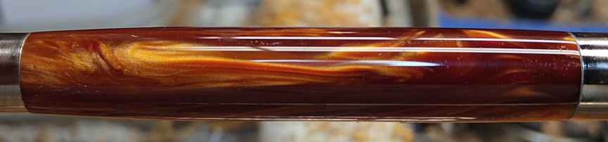

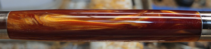

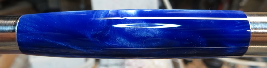

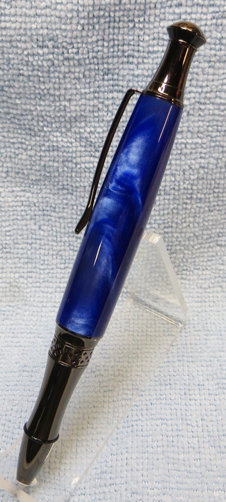

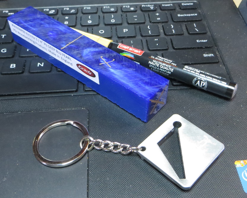

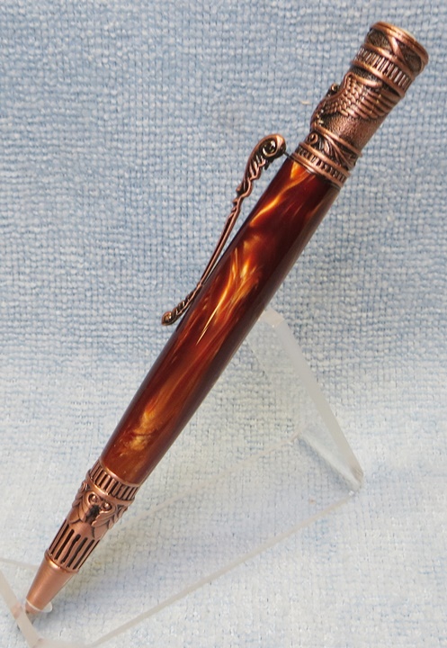

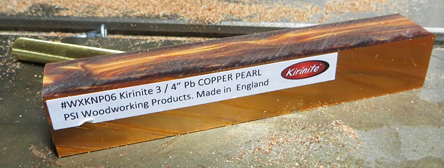

I've made a few Kirinite pens... Kirinite turns wonderful, and finishes pretty nice too.
The biggest problem I see is that Kirinite was designed for knife handles. If you do a pearl Kirinite pen for example, you'll see the pearl pattern on the top and on the bottom, but not spread through the pen evenly.
I'd really like it if the Kirinite makes would spread the pearl throughout the blanks, like Acrylester blanks for example...
