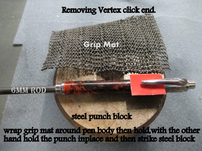

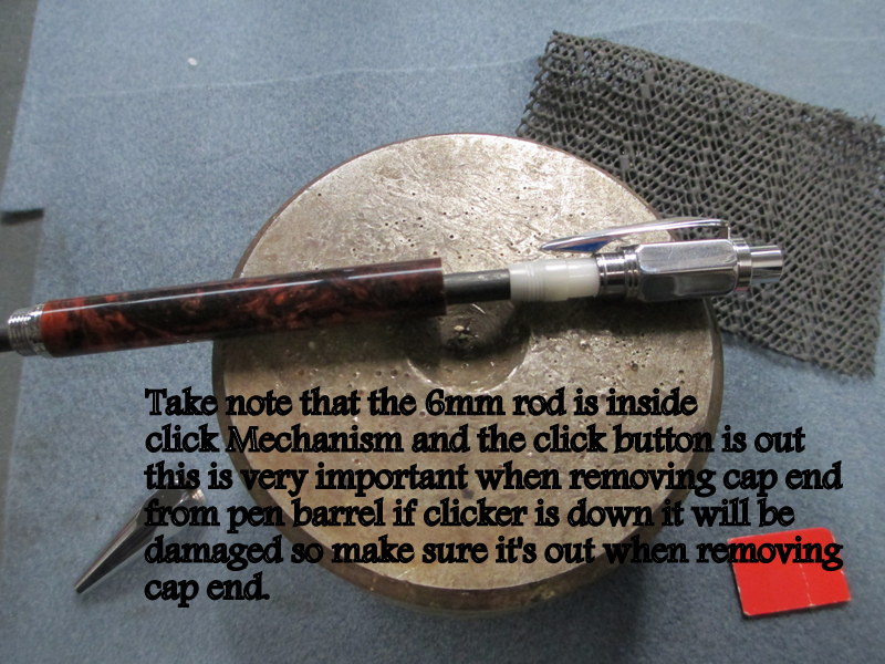

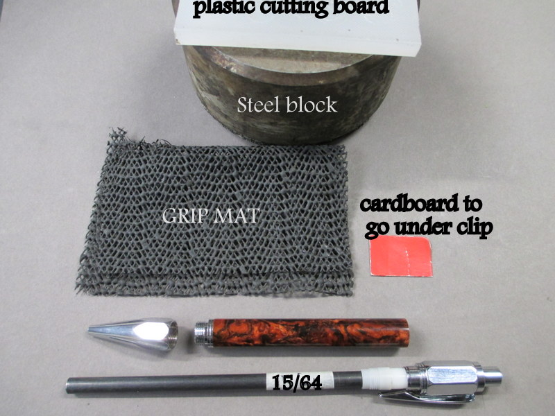

Andy i have pulled them apart i posted photos on page 6 in Penturning called Click Mechanism an inside view
Andy it's easy to remove the clicker end 1) undo nib, 2) put a 19/64 or 7.5mm steel punch inside pen body, 3) put a small bit of cardboard under the clip so it don't scratch the body, 4) wrap the body with rubber grip matt 5)hold the punch firm against clicker end, now with the other hand grip the matt and pen,now hit the punch up against a steel block, a med blow will easy remove clicker. Another way using a 6mm punch push it up into plastic clicker part the CLICKER BUTTON MUST BE IN THE UP POSITION NOT DOWN, IF IT'S DOWN IT WILL SMASHED THE CLICK PARTS.YOU COULD DRILL A HOLE INTO THE PUNCH TO ACCOMMODATE THE PUSHING PIN I HAVE MADE THE TOOL SHOWN ON PAGE 6.IN PENTURNING. the photos posted are using smaller punches, the other size punches are also ok using them you don't have to worry if the clicker is up or down, Another thing The Vertex plastic parts will not past thru the threaded nib bush this is why i do it like this.sorry for the long thread.the other pen is easy undo nib,undo the clicker button anticlockwise ,then push the plastic click parts out thru nib end,next use a neat fitting punch to pop off click mech part using the same way with grip mat,steel block or you can use plastic cutting board to hit the punch on works fine.
