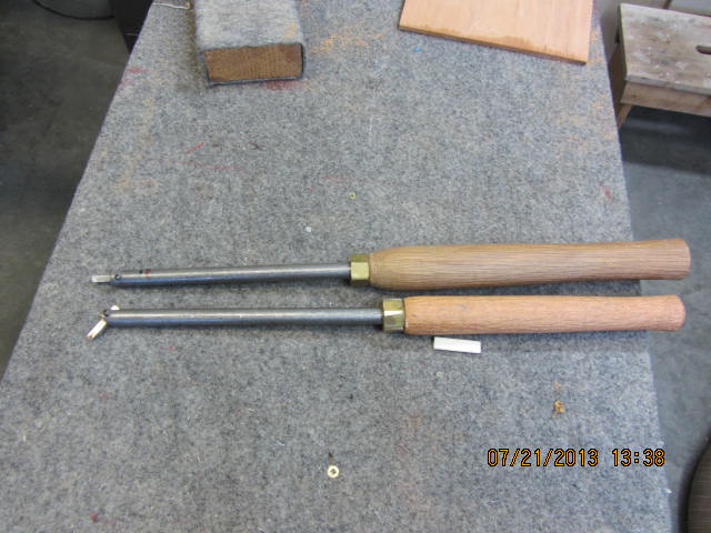

I've made two. One straight and one with the bit coming out at an angle. I use the straight one most and it is great for boring and, well, quite a few things. I've even used it on spindle turning to make grooves. The angle one is more difficult to use. It grabs quite a bit. Might have been better if it was made out of square stock. I did not use drill rod, I just used steel that you get at the BORG's. I'm not sure what drill rod would be essential. They are simple to make.
